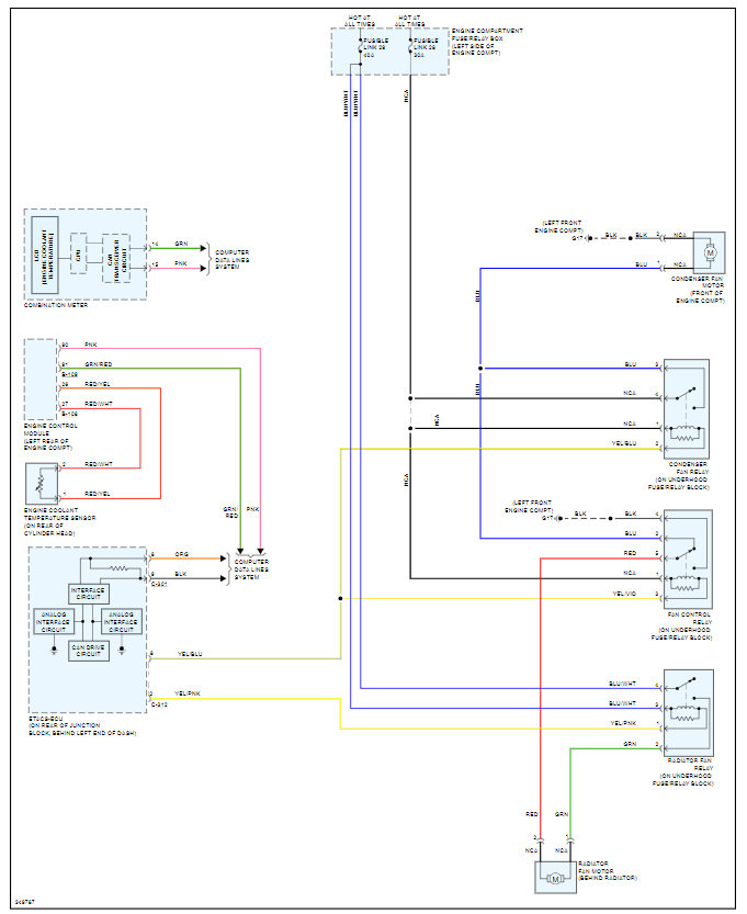

Hi, where is the cooling fan control in my car? it is the ES model.
Jul 23, 2017 at 12:32 AM

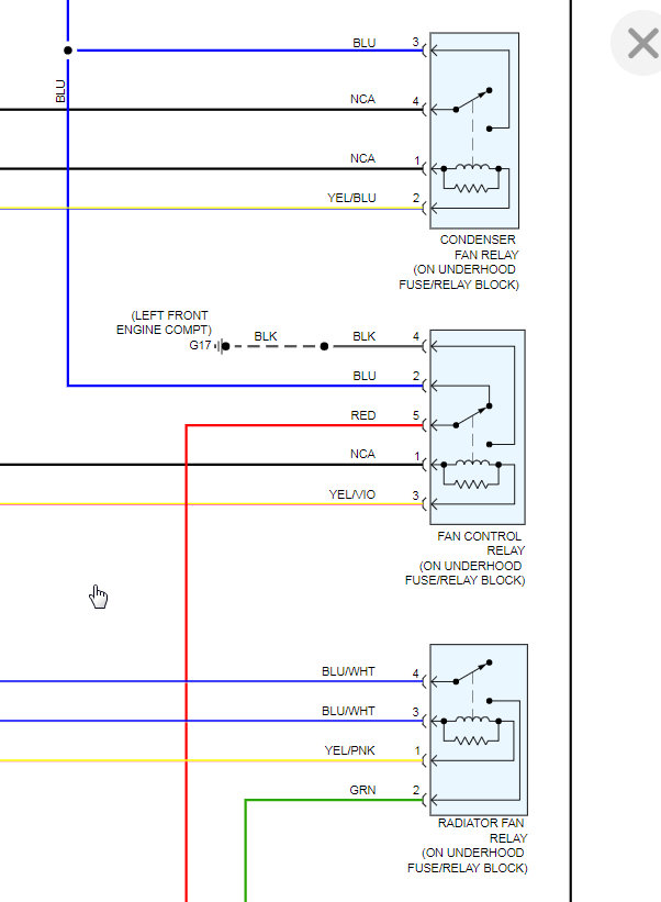

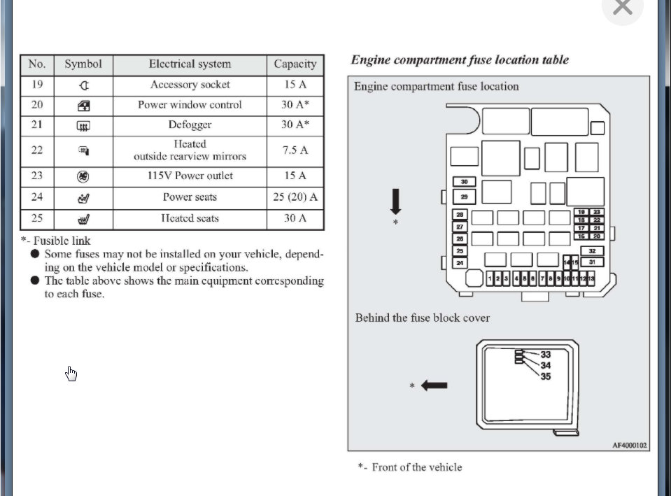

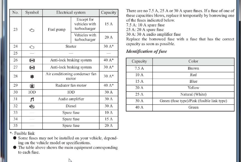

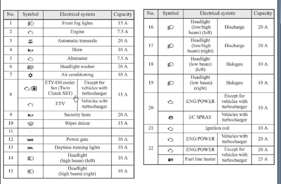

You have 3 cooling fan relays that need to be checked as if your cooling fan is not working that is the most likely cause.
I am attaching the wiring diagrams and the fuse locations of the relays.
Also here is a guide on how to test a relay which will help:
Once we know the relays are okay, we can go back to the temp sensor and ECM but they are less likely to be the cause so let's start with the relays.
Let us know what questions you have. Thanks
