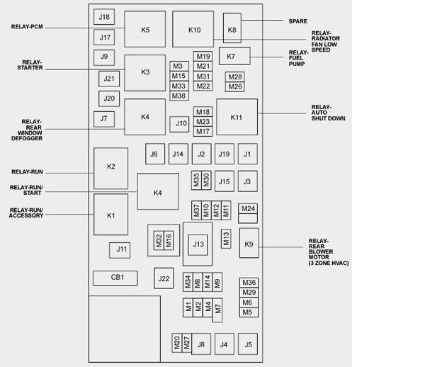

Cooling fan says on even after engine is cool and not running and drains the battery drained flat.
Jun 7, 2017 at 3:04 PM
CARADIODOC
  • 34,415 POSTS
There are two versions of cooling fan circuits. Look for a low-speed radiator fan relay in the Integrated power module, (fuse box), under the hood. Remove that and observe if the fan stops.

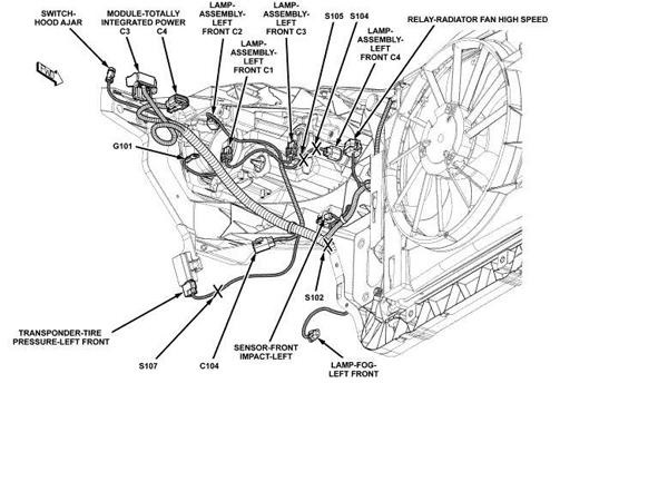

The high-speed relay is to the left of the radiator. Unplug that one too to see if the fan stops.
