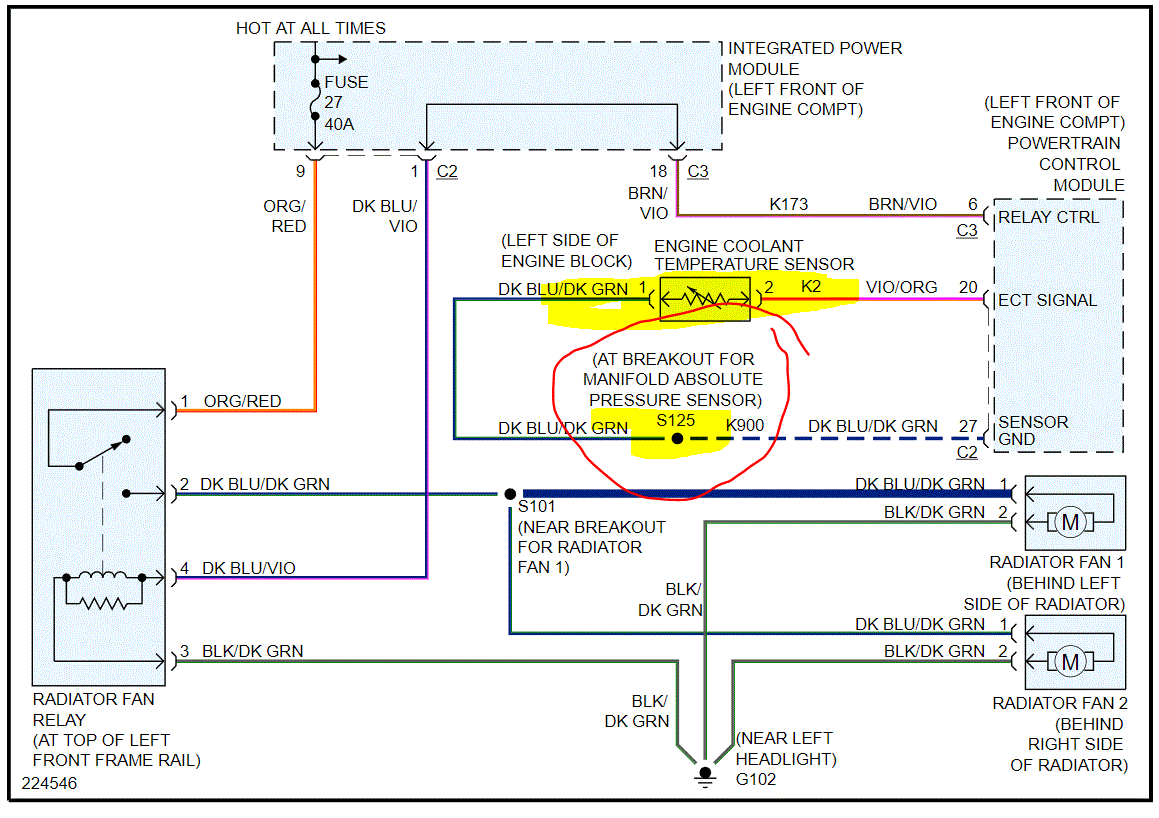

Then the sensor isn't working properly. If it was boiling, then it certainly was over 212F. I have a feeling it's a wiring issue.
Since the sensor is new, I suspect we have a corrosion issue to contend with. The signal to the gauge/computer is basically based on the amount of voltage allowed to pass through the sensor. The voltage changes a caused by temperature. If there is excessive resistance (due to corrosion or a connection), it will cause the signal to be off.
Here is what I suggest: First, disconnect the connector at the sensor. There will be two wires on the connector, one is violet with an orange tracer and the other is dark blue with a dark green tracer.
The dk blue/ dark green wire provides a ground for the sensor. Check for continuity to ground. While checking it, move that wire around to see if there is a change in resistance.
Next, with the key on, check the other wire violet/orange wire for power. Let me know what voltage is found.
This is where to start. At this point, I have a theory related to the integrated power module but don't want to jump to conclusions. In addition to checking the wiring, inspect the connector. Make sure there is no corrosion, and the connector pins are not pushed back or damaged in any way.
Let me know if you are comfortable performing the tests or if you have other questions.
See pic below.
Oct 16, 2021 at 1:08 PM

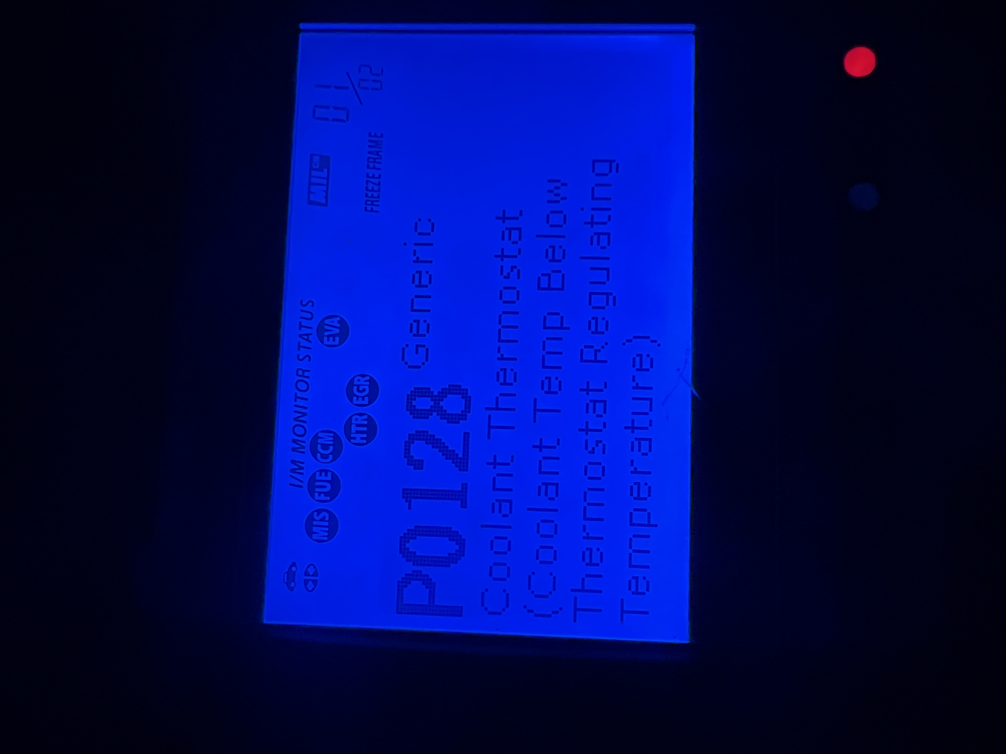

Haven’t had a chance to check the ohms yet but I did find the connector to the sensor had the locking mechanism on it broke so I got a new connector. Just need to wire it in. Got a code.
Oct 24, 2021 at 3:07 AM
  • 110,240 POSTS
If you got a direct replacement connector, you should be able to just use the lock mechanism on yours. That way you won't have to cut anything.
I noticed you mentioned a code. What code did you get?
Oct 24, 2021 at 11:05 AM
SIMPHERDY
  • 5 POSTS
PO128.
Oct 24, 2021 at 3:53 PM
SIMPHERDY
  • 5 POSTS
See attached photo.
Oct 24, 2021 at 3:54 PM
  • 110,240 POSTS
Yep, that code indicates the vehicle isn't reaching operating temperature fast enough or not at all. Let me know what is found with the wiring testing.
