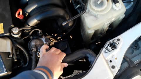

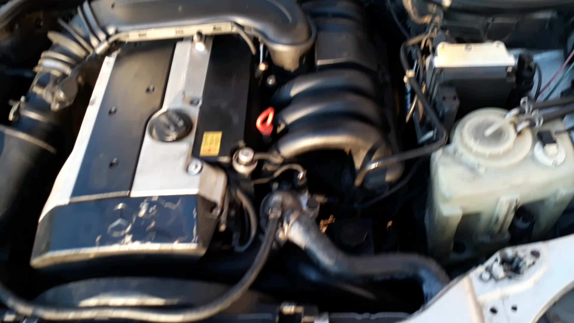

I uploaded the video what is happening.
note: that this video is at very morning after a stop all night.
*I have changed most of the hoses and a side of the radiator and the cap.

That doesn't make sense. You are certain the engine isn't building pressure via a head gasket? I ask because coolant expands when it gets hot. That is what pressurizes the system. If it exceeds a specific pressure, it is released via the cap. Now, the cap will maintain pressure below its threshold; however, under normal conditions, pressure is gone when the coolant cools and is no longer expanded. That leaves one thing. Air is getting into the system. If you remove the radiator cap when the engine is cold and start it, is there any evidence of bubbles? If you start the engine, does coolant want to come out?

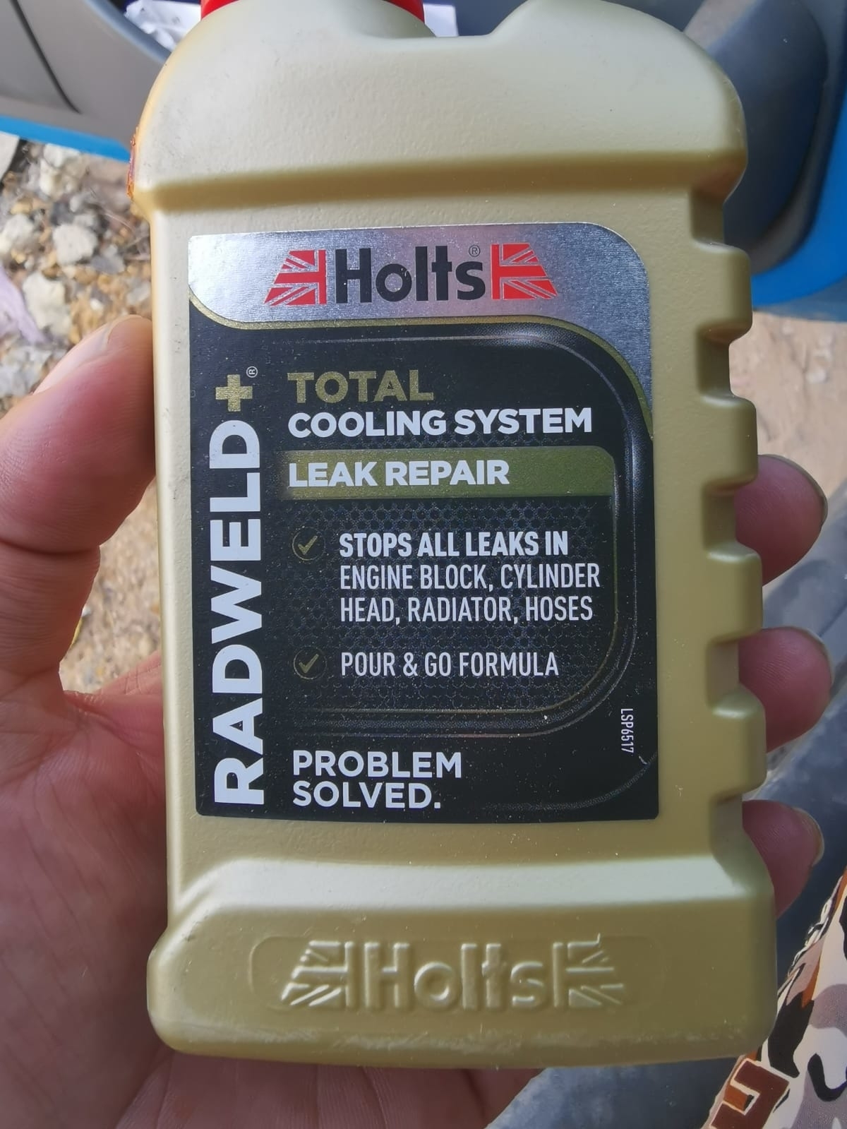

In vase there is no bubbles can i use a coolant system leak repair as shown in the picture or will harm the engine?
Nov 19, 2019 at 10:31 PM
  • 110,240 POSTS
I never recommend using these products unless it's an emergency. Also, the problem isn't a leak but the opposite, pressure isn't releasing. Is coolant leaking at some point?
Nov 20, 2019 at 6:49 AM
ALI HOTEIT
  • 6 POSTS
Now yes at very high pressure it is leaking from the other side of the radiator.
Nov 20, 2019 at 8:53 PM
  • 110,240 POSTS
It sounds like the radiator should be replaced. If there is a larger leak, these things won't help. Also, that really makes no sense now. If there is a high pressure leaking from the radiator, how it is staying pressurized or is this something new?
