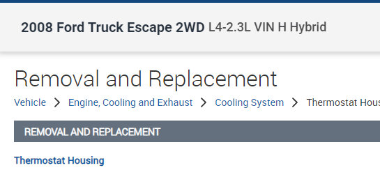

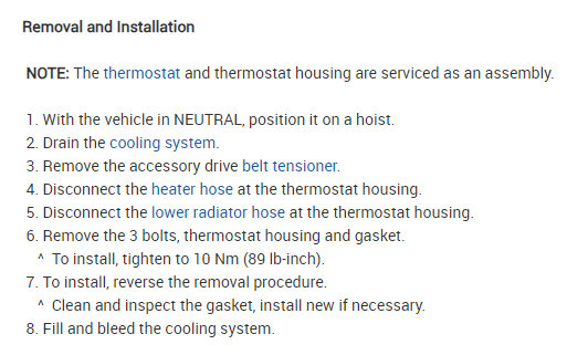

The code simply indicates the engine is not reaching the correct operating temperature within a specific amount of time. As a result, the vehicle will produce higher emissions.
In most all cases, the thermostat is stuck open and causing this to happen. The repair is usually a new thermostat.

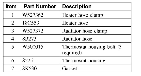

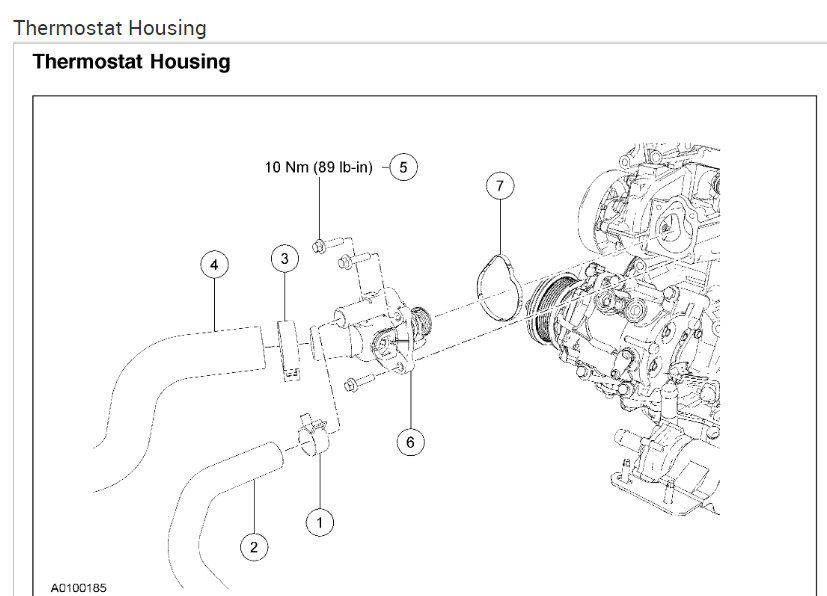

On this vehicle, the thermostat and thermostat housing are one in the same. They are sold as a housing assembly, which includes the thermostat itself.
I attached the directions below. It really isn't a difficult procedure. Take a look at the directions and let me know if you have questions.
See pics below

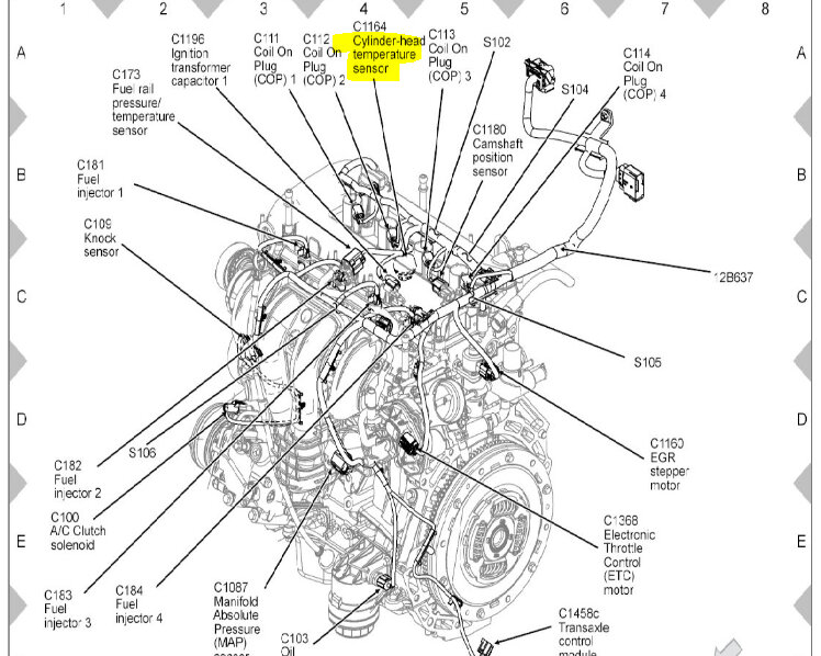

PS: The cylinder head temperature sensor is located at the top of the engine. See last pic.

Should I understand that:
There is only one "stand alone" temperature sensor - and this is the cylinder head temp. sensor?
- the other element that react to the temperature is the thermostat?
I guess my follow up question is - is there a coolant temperature sensor (separate from the cylinder head sensor) that I should be looking for / consider if it's working properly? Or all is built in the thermostat housing?
Many thanks! Your help is starting to give me confidence that I can tackle to repair myself :)
May 12, 2024 at 3:19 AM
  • 110,244 POSTS
The cylinder head temperature sensor is the one of interest. I feel the thermostat housing with the integral thermostat will eliminate the problem.
