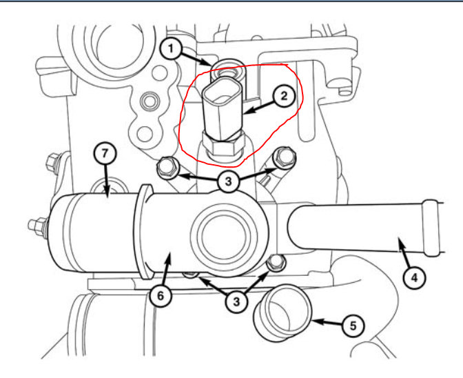

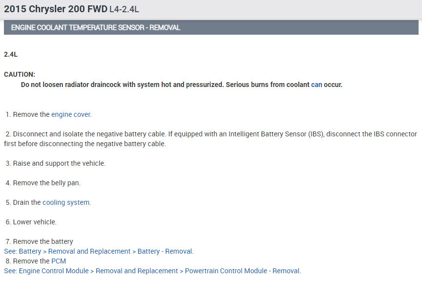

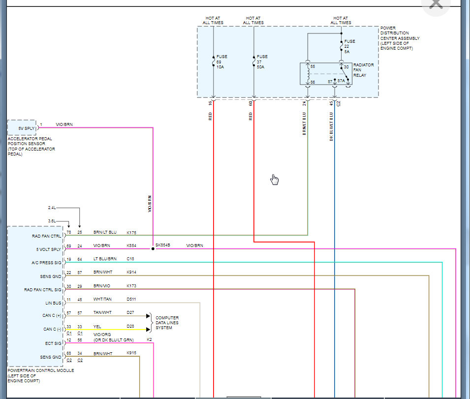

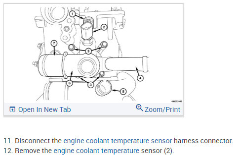

car listed above is a Limited model. isn't overheating but heats up to 230f when idle. fan comes on at 230 , fans come on when heater but that's it. f22, f37 fuses are good. can't find the fan relay and need help. I was hoping that it might be temperature sensor

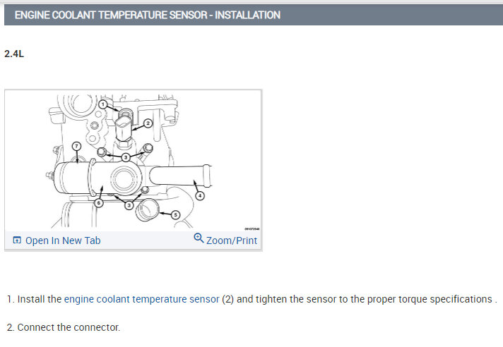

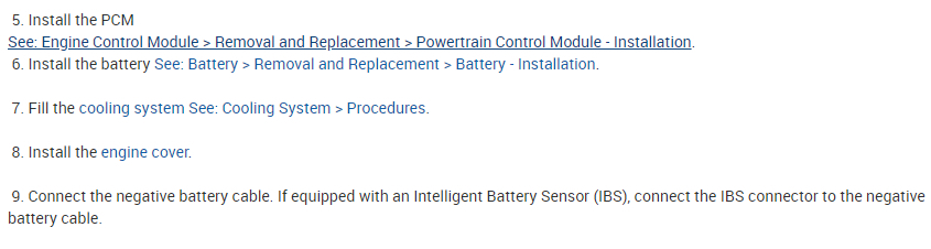

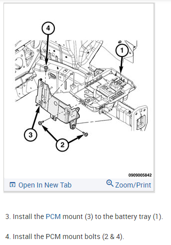

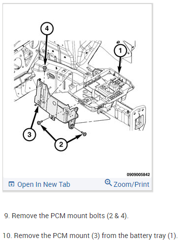

I've attached picture steps below showing the location circled in red and how to replace the coolant temperature on your car. As far as the radiator fan relay it is non-serviceable and soldered into the PDC- powertrain distribution center. That means the whole PDC would need to be replaced or repaired. Hope this helps and thanks for using 2CarPros.

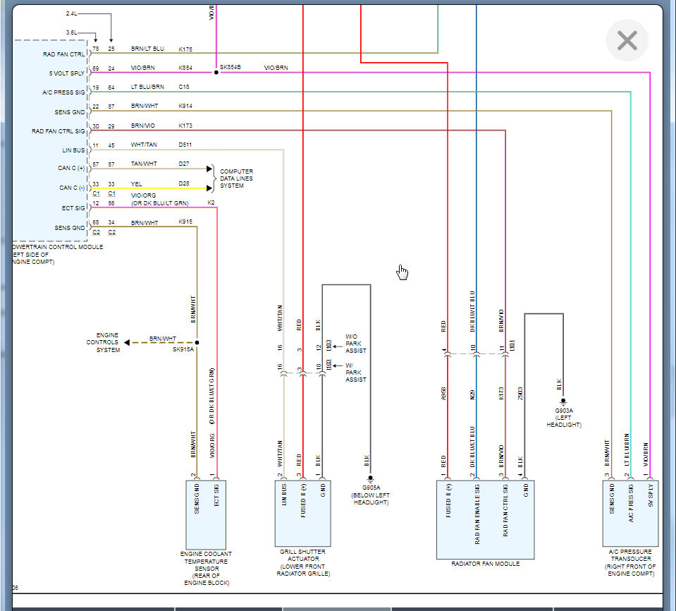

I am not sure I understand the issue. The engine doesn't overheat but the fan does not come on until 230 but it does run with the heater?
If the radiator fan comes on then the relay and fuses are fine. If it doesn't come on until 230 then I suspect the fan module or the PCM is the issue.
It is unlikely to be a temp sensor because if the temp is accurate in the dash and it is 230 then the PCM is getting the same data from the temperature sensor as the dash.
The problem is that the PCM is either not turning the fan on or the module is not operating properly and not turning on when it is commanded to.
So we need to go to the fan module and check the voltage on the two signal wires.
Basically this tells the fan to turn on (enable signal) and then the fan module returns the signal to the PCM to tell it that it is running at that speed.
So I suspect the fan is not turning on until it is commanded on high.
Let me know if you have questions on this and we can go from there. Thanks
