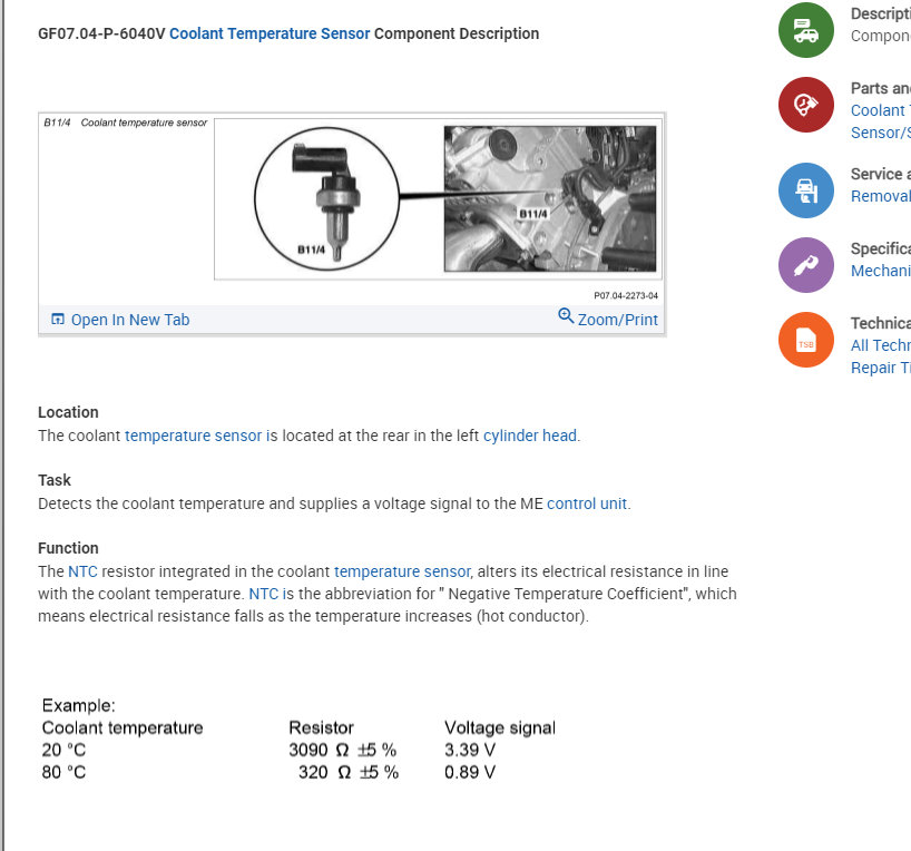

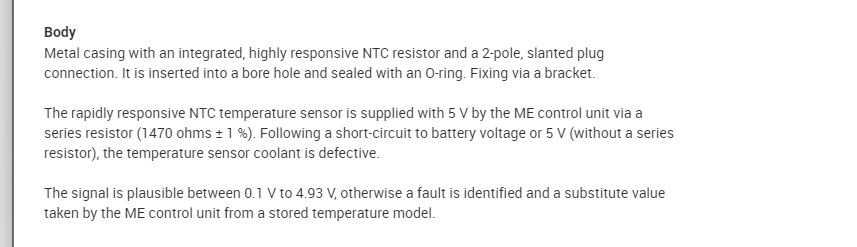

This sounds more like a sensor issue. Engine coolant does not jump straight to hot. If you think about it, the temperature of the engine and the coolant rises gradually so the fact that it jumps and then it goes back to normal after you cycle the key points to a sensor issue.
So, I would suggest we start with checking the operation of the sensor. We do this by checking the resistance in a pot of water. Basically, pull the sensor and put the tip in water with a thermometer so you know the temperature of the water. Then measure the resistance.
Bring the water to 20 C if you use cold water or 80 C (68 or 176 F) so that you can compare the resistance and voltage signal. You need to be within 5%.
Let us know what you find with this.

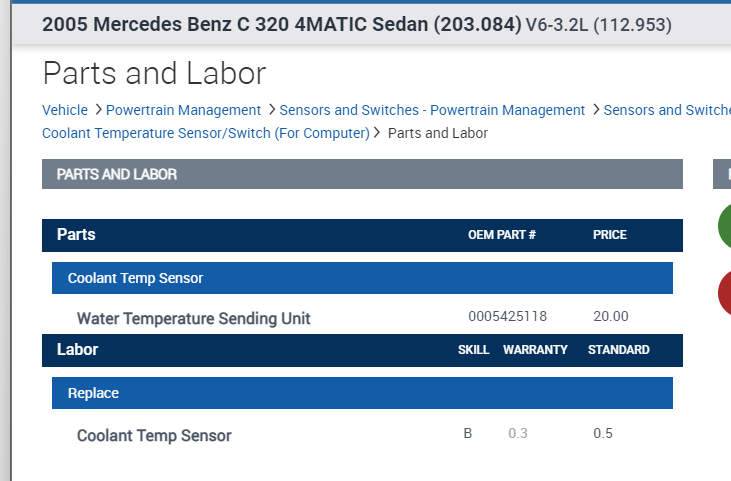

Makes sense. Some people replaced it and got good results others had to replace the one up front underneath the coolant hose, which is part of the thermostat housing, not sure what difference is between the two. Can you get me the part number for the one in the back of the motor?
Jan 2, 2022 at 4:56 PM
Looks like one is for the ECM to use and the other is for the gauge. So that begs the question, which one were you monitoring with the scan tool?
Basically, the testing remains the same.
AllData says this is the part number for the sensor for the ECM but does not tell me which one this is.
Jan 2, 2022 at 6:53 PM
