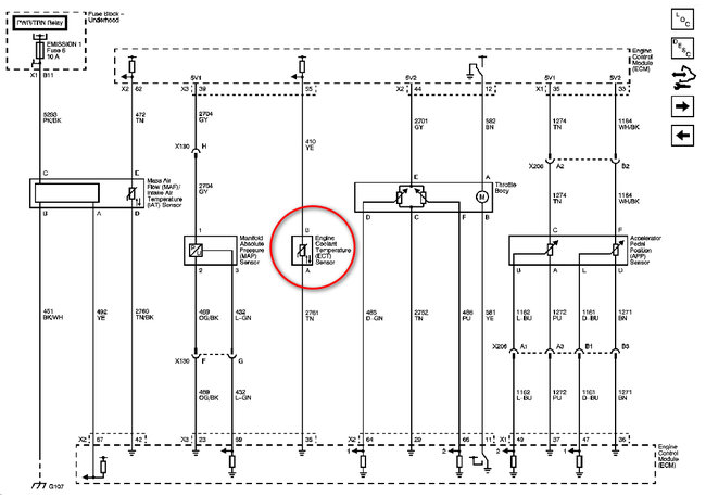

I am replacing the coolant temperature sensor. The electrical plug in was also bad so I bought a new one. The existing wires coming into that plug were both yellow. I have to cut this to connect the new plug. I am not sure which wire goes on which side of the sensor. I have a 50/50 chance on getting this right. what if I don’t?

The two wires leading to the ECT sensor are actually yellow and tan, see diagram below.
The sensor is a simple NTC resistor so the wiring can be attached either way.
Hope this helps.

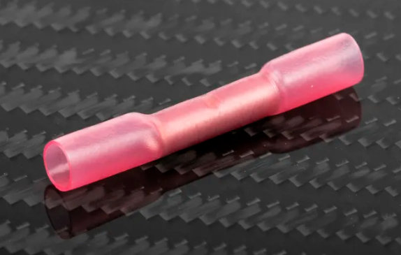

I prefer using insulated crimp joints, see picture below. You insert each side wire into the joint, crimp it with a suitable tool and then apply heat to reduce the heat shrink to provide a waterproof joint.
A good video
https://youtu.be/i5LBf19MqPk
Could you please provide us with good, clear picture of the connection in question?
