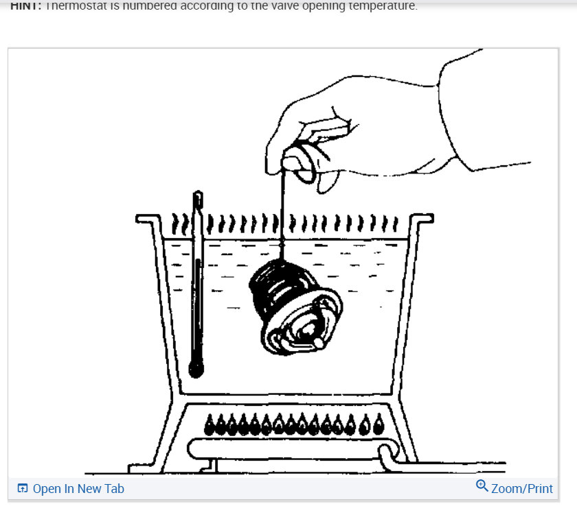

You have the correct idea, jack the rear of the truck up to help the air bubbles out of the system. Also, this truck has the thermostat down low so the system may not drop, have you driving the truck around? I would drive it to get it hot and then shut it off and allow it to cool completely then recheck the coolant level, also turn the heater on full. Can I ask if the heater is working now?

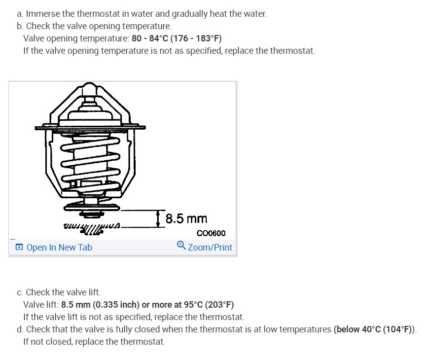

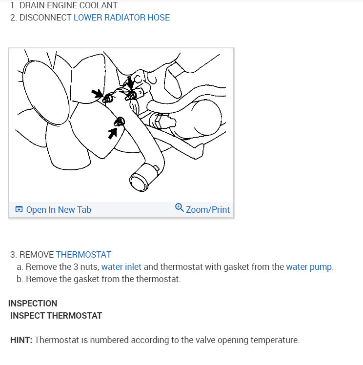

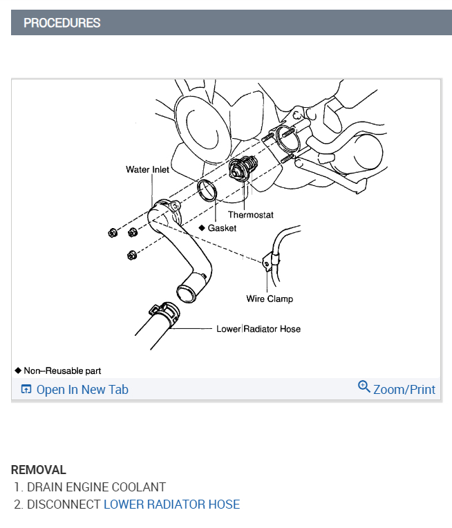

It sounds like the thermostat is stuck closed and I noticed that it has not been replaced and if so, the new unit is defective. Here is how to change it out. We always had luck by jacking the rear of the car up, but you can try the front of the car as well. Check out the images (below). Please let us know how it goes.
