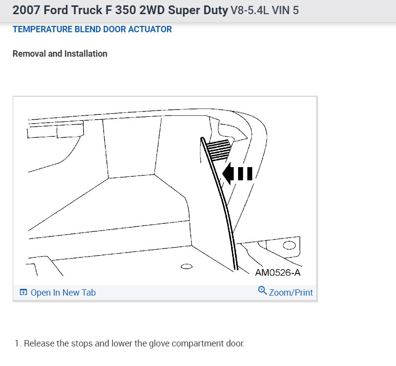

I don't get heat to the cab. I don't show a coolant leak. No milky white in my oil.
Feb 10, 2023 at 2:22 AM
  • 55,112 POSTS

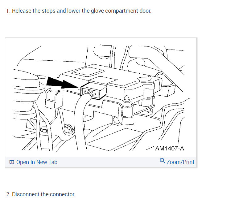

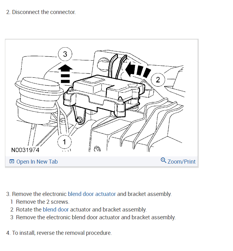

I would check the temperature blend door actuator because it sounds like it is not working. Here is the location so you can work the controls to see if the actuator is moving. Also, this guide can help as well. Check the images below.
If the temperature actuator is working and if you don't have a coolant leak and there is no milky white appearance in your oil, then the problem is likely with your heating system and not related to the engine.

Check out the images (below). Please let us know what you find.
