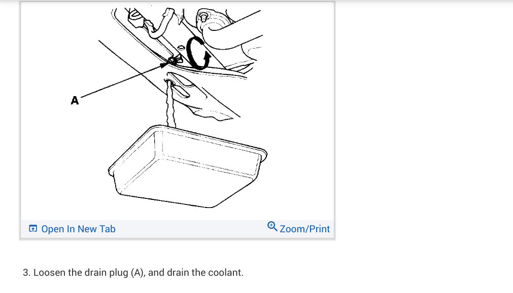

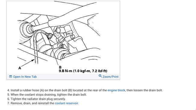

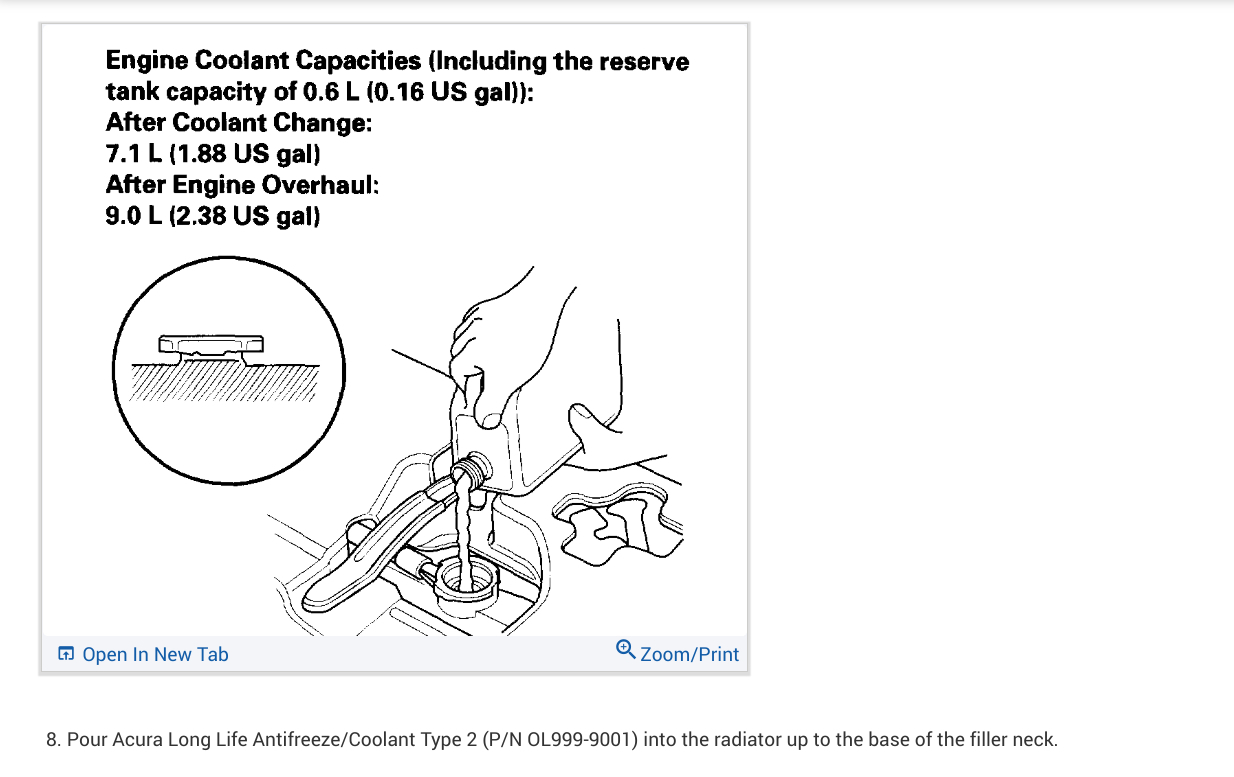

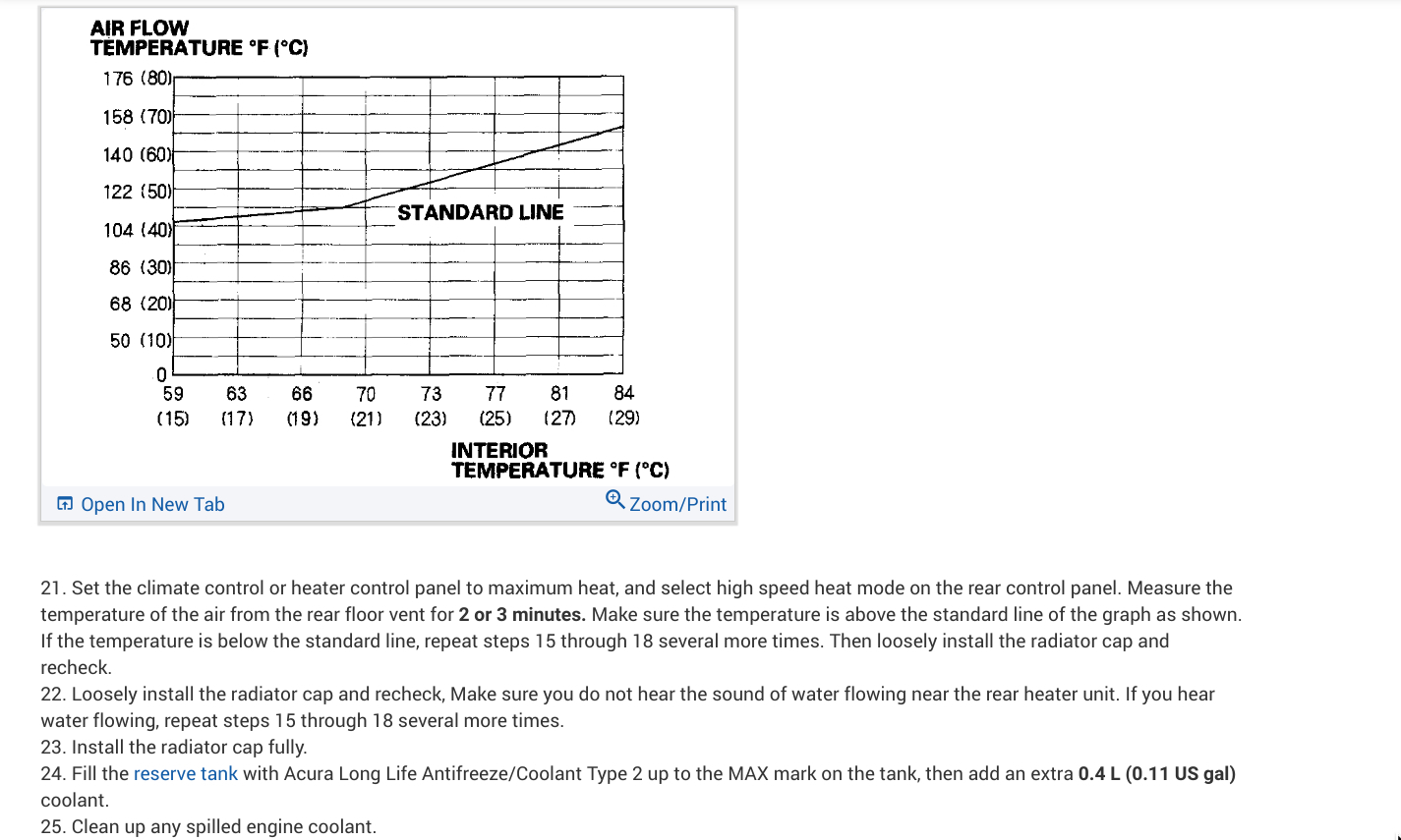

Is there a drain plug on the engine to get all the coolant out of the system and if so where is it located?
Mar 4, 2020 at 11:16 PM
SCGRANTURISMO
  • 4,897 POSTS

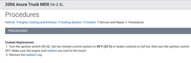

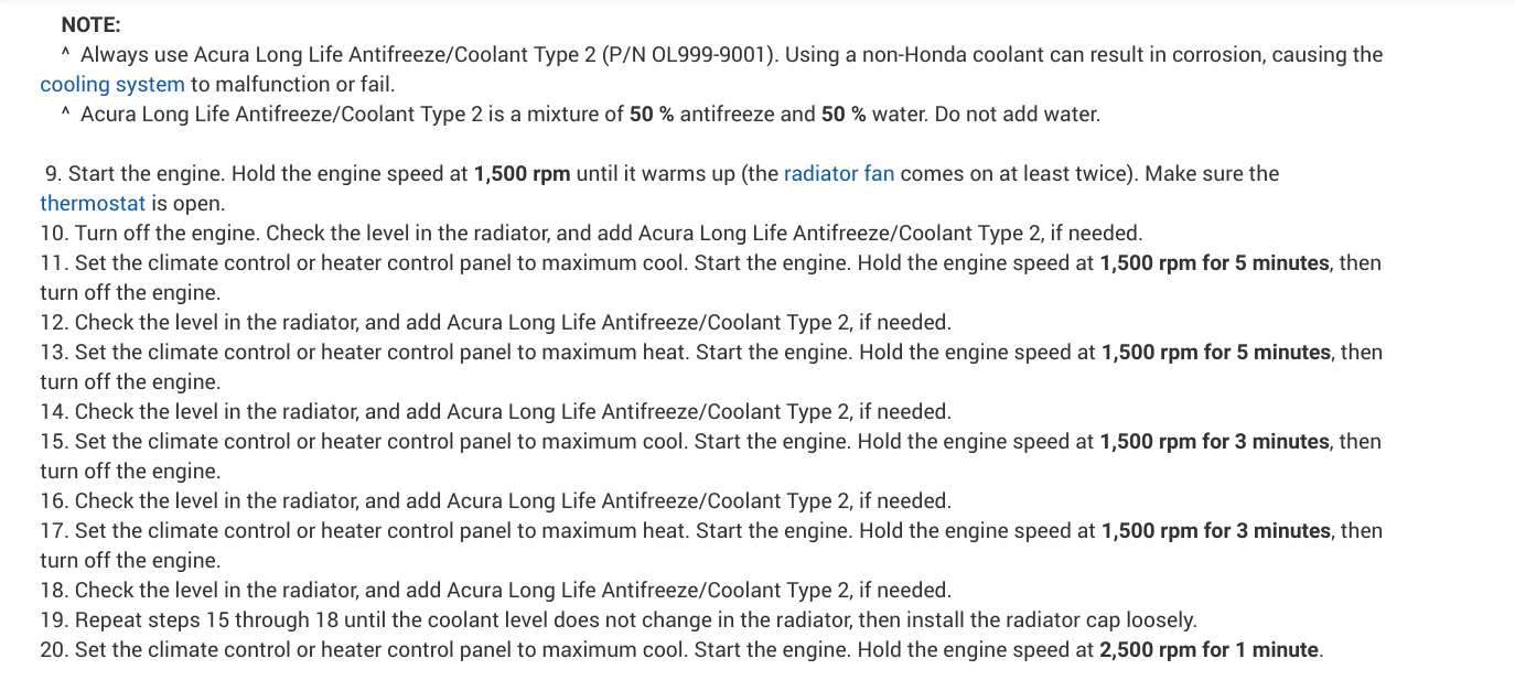

In the diagrams down below I have included the instructions from the vehicle manufacturer for the draining and filling of your vehicle's cooling system. Please go through this guide and get back to us with how everything turns out.
