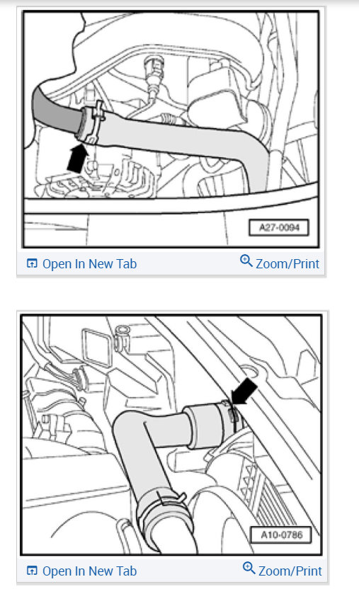

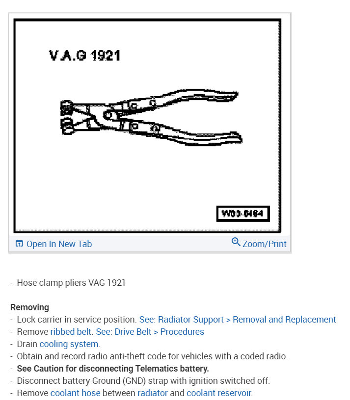

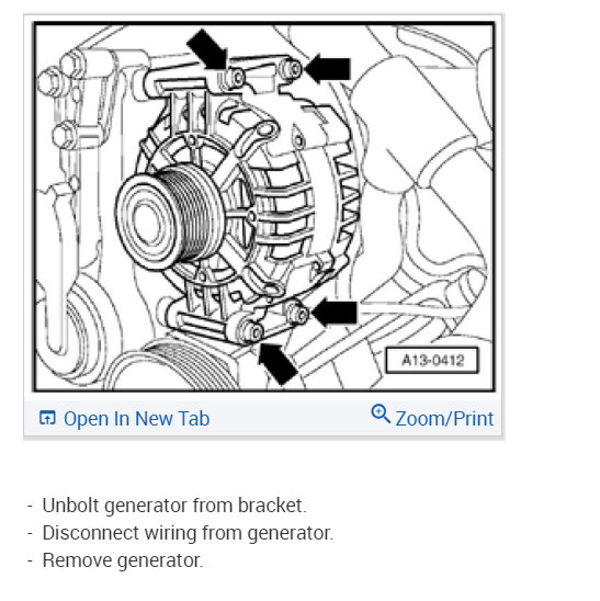

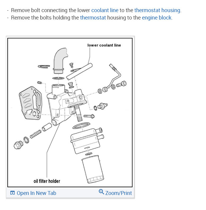

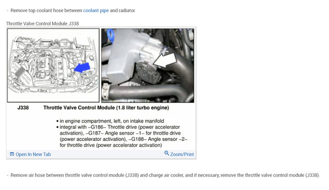

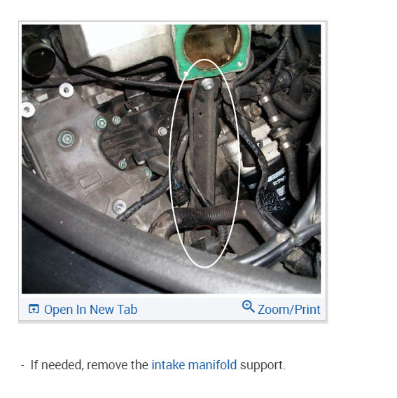

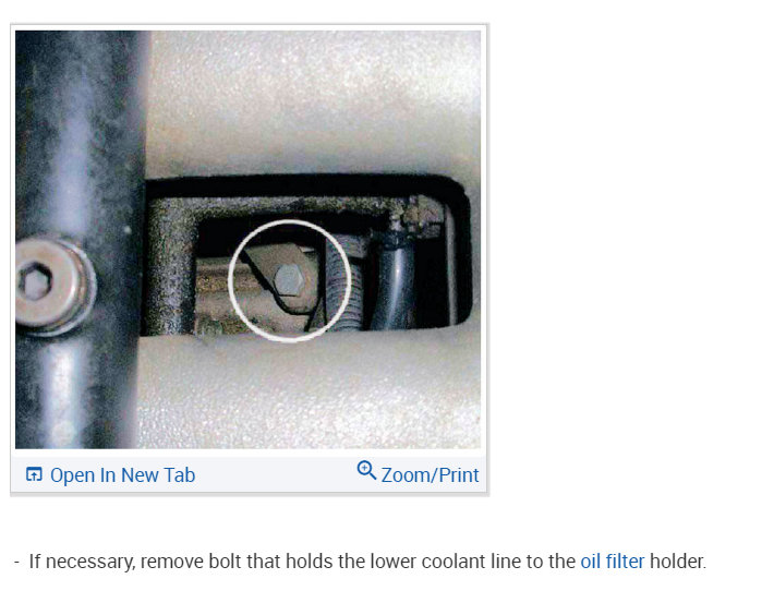

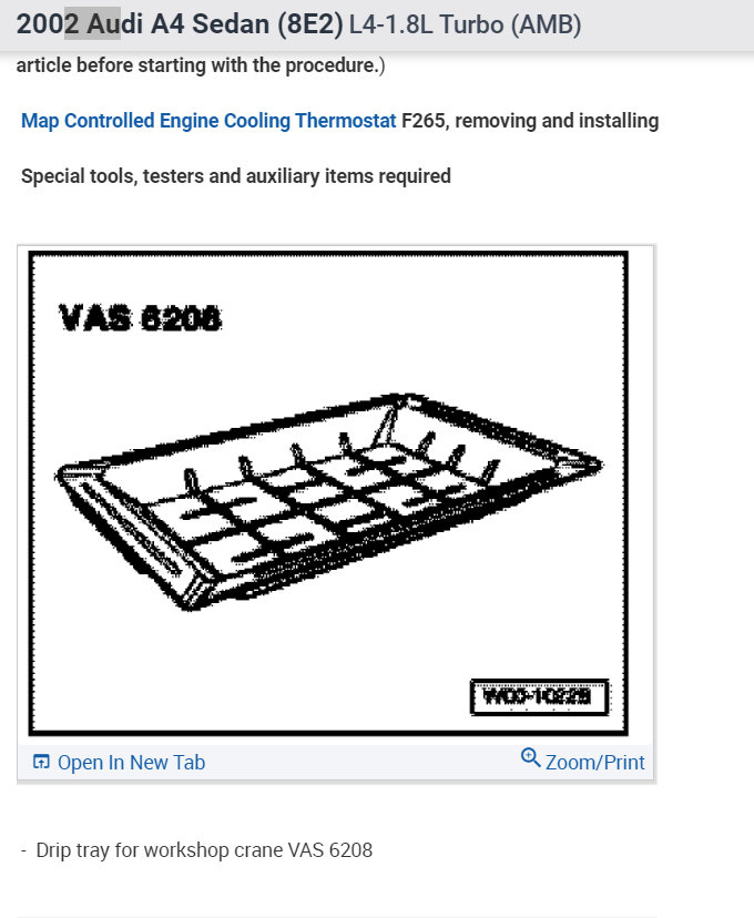

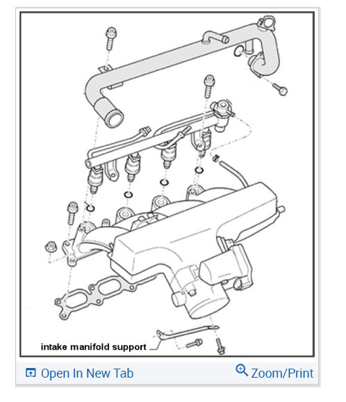

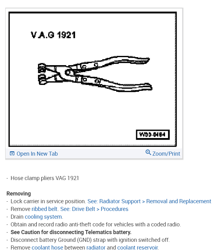

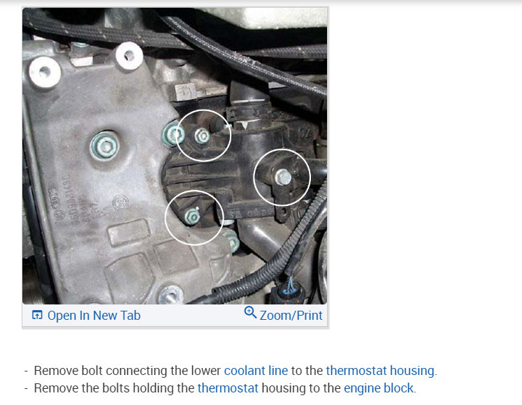

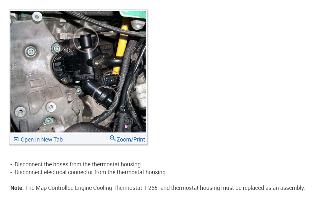

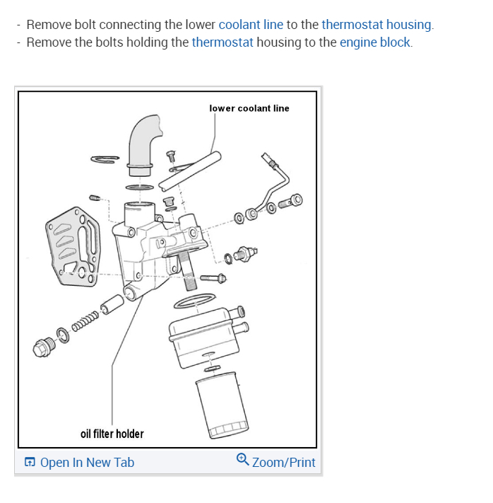

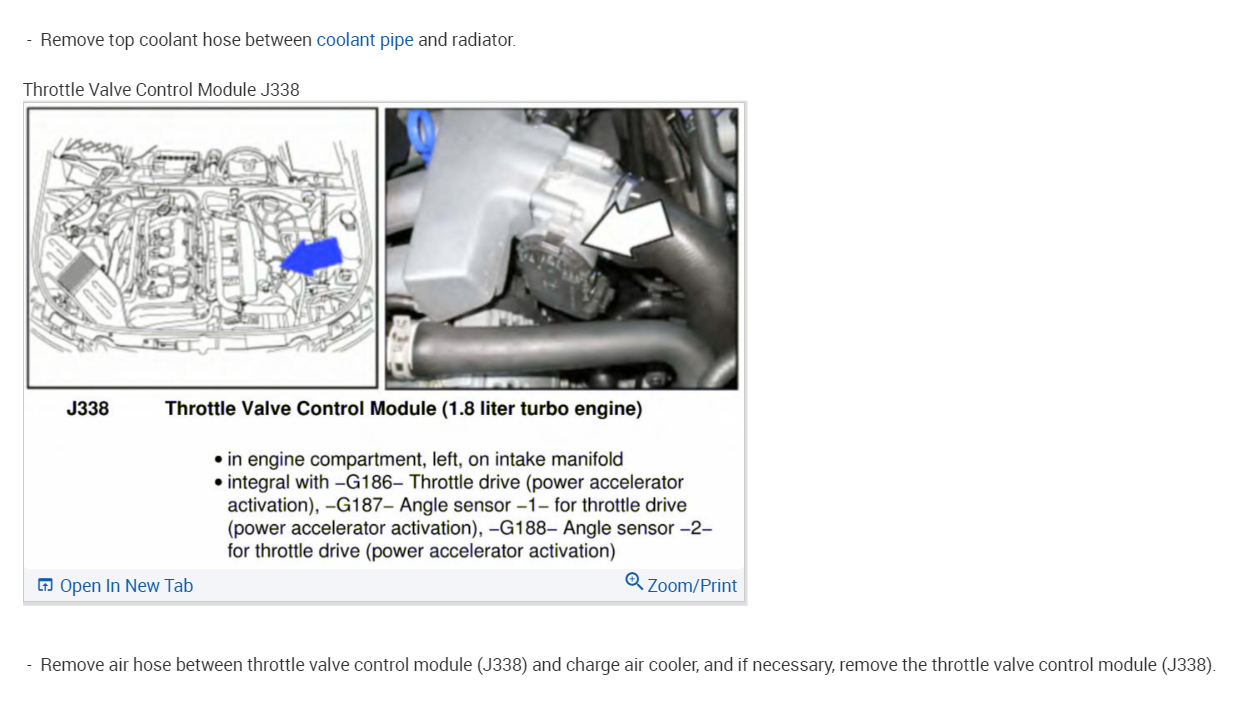

The head gasket can still be blown without white smoke or coolant in the oil, I would do a chemical check. This guide can help you. Also, if the engine overheats quickly, you could have a defective thermostat.

Thank you for your answer, but the photos diagrams below are not for my engine model cause i don't have 1.8t engine. The chemical test i have done before is okay, just the pressure test haven't done. I know that all coolant is coming out from reservoir cap. My engine does not overheat max goes 93 grad Celsius and radiator stat so it goes down to 86 again never overheated. Wanted to know does coolant goes up when revving the engine is it normal? Now one more thing I found today. When car is parked for 24h i started and waited to get the normal temperature i was checking coolant if was hot or not when engine showed around 80grad Celsius it was cool but in just 20 seconds it got really hot but temperature on vag and dash was still same! Is it normal?

Yes, it is normal for the engine coolant to go up and down with engine RPM. It sounds like you have a stuck thermostat. We only have the 1.8 in the state, so I don't have access to the 2.0 liter engine. If you can upload images I can help walk you through the repair.
