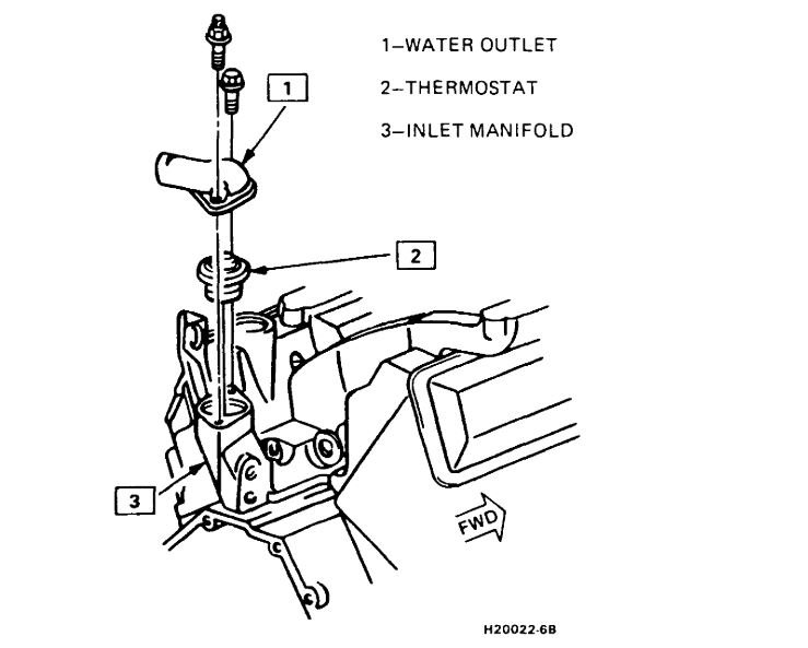

I replaced thermostat and coolant temperature sensor last year because i had to replace my intake manifold gaskets. Even though i have heat and engine is getting hot, could it be that the thermostat and coolant temperature sensor is defective?
Jun 25, 2020 at 10:48 AM
Good afternoon,
If the thermostat is stuck open, that would explain the change in temperature.
I would definitely replace it again.
When you are filling, just use 50/50. No reason to dilute it at all. Fill the system with the thermostat removed until the coolant comes out the housing. At that point all the air is out of the block and the heads.

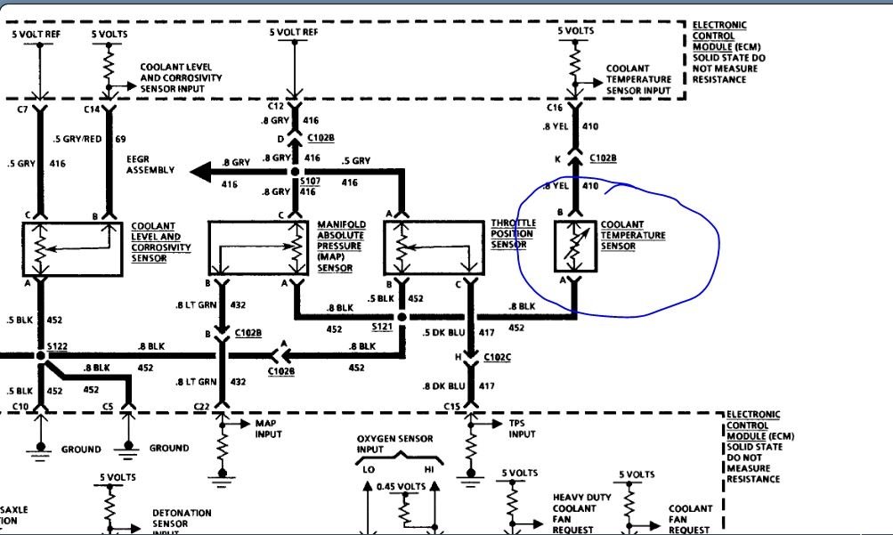

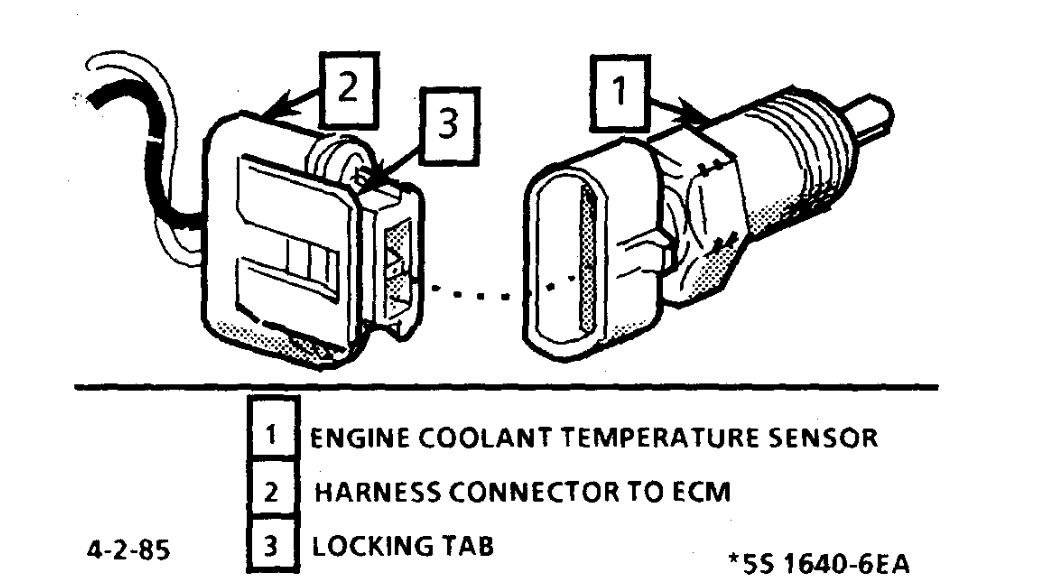

I was not referring to the coolant level sensor that connects to the radiator. I was referring to the coolant temperature sensor that screws into the intake manifold, that measures engine temperature. A good working sensor is to be 200 ohms. I received 0.1 ohms.
Jun 25, 2020 at 1:23 PM
That resistance will change varying on engine temperature.
The resistance goes down when it the coolant is hot.
https://www.2carpros.com/articles/how-a-coolant-temperature-sensor-works

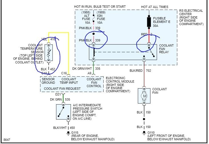

Can you check for 5 volts to it?
When you remove the connector with the key on, does the cooling fans come on?
The engine coolant temperature sensor is a thermistor that is located in the engine coolant flow. When the coolant temperature is low, the sensor produces a high resistance. When the coolant temperature is high, the sensor produces a low resistance.
The ECM sends a 5.0 volt signal to the coolant temperature sensor through a resistor in the computer and measures the voltage. The voltage will be high or low depending on coolant temperature. By varying the voltage the computer will sense engine coolant temperature.
Jun 25, 2020 at 2:07 PM
COOLOLDS85
  • 173 POSTS
Fans do not come on with key on when connector is remove. I did get around 6 volts.
Jun 25, 2020 at 3:32 PM
6 volts to where?
can you give me the code that keep setting?
I attached a diagram for you to view. Can you verify power to the fuses circled?

You could try replacing the coolant sensor. As I stated, the resistance is high when it is cold and low when it is hot.
