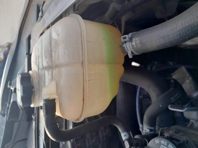

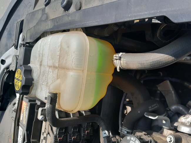

Can't keep coolant in reservoir it is leaking and overheating my questions is, it's a week until payday and I need to go get my husband from work an hour away can I drive it and if it overheats runs out of coolant before I get there can I put water in it for the trip and back?
May 25, 2023 at 2:54 AM
  • 110,240 POSTS

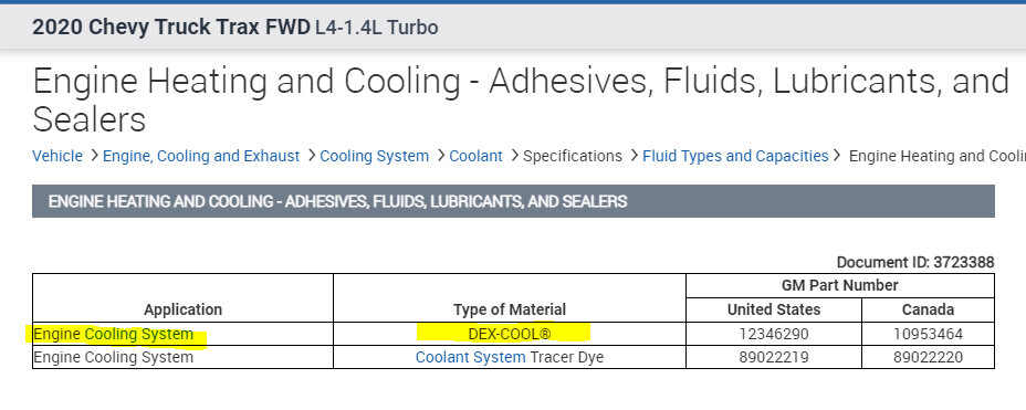

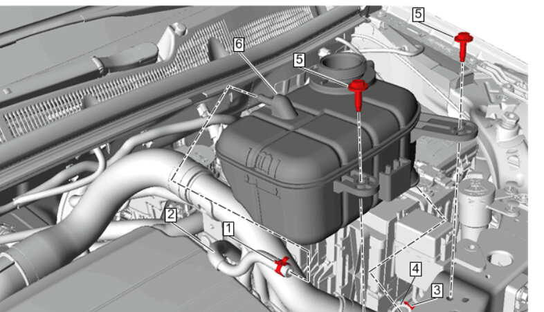

I attached a pic below to make sure I have the correct one. Confirm that for me.
Also, this should have a 1.4L turbocharged engine. You don't want to overheat this engine. I don't know how quickly it is losing coolant, but the engine is aluminum and can be damaged if it gets hot enough. It would be safe to run just water temporarily but replace it with Dexcool when possible. Don't mix other coolants with Dexcool unless it is indicated as a universal coolant compatible with DexCool.

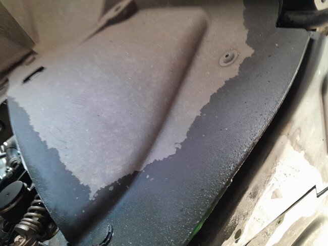

Yes, I think so it looks like it. I filled the coolant to the fill line and went to the store 5 minutes down the road.it sat for 3 hours before I drove it again.1st put is how much I lost with the 10 min drive and sitting for 3 hours. Then I topped it back offhand and drove an hour away to pick my husband up. sat as his work for about 20 min then drove the hour home. The 2nd pic is what bit looked like when I got home. I've not ket UT overheating except the first time it did. Now that I'm aware of the problem I haven't been driving it or if I do I stop and check it ever so often. One more question, should I put stop leak in it? Thank you for your time.

I'm glad you made it without issue to pick up your husband. As far as the stop leak is concerned, if the leak is in the reservoir, it won't work. Also, there is a chance you will cause a new issue. I've seen stop leak cause a blockage in a lot of vehicles over the years. If possible, stay away from it.
It's interesting that the fluid loss wasn't that much different when comparing the drive time. It is the reservoir that is leaking, correct?

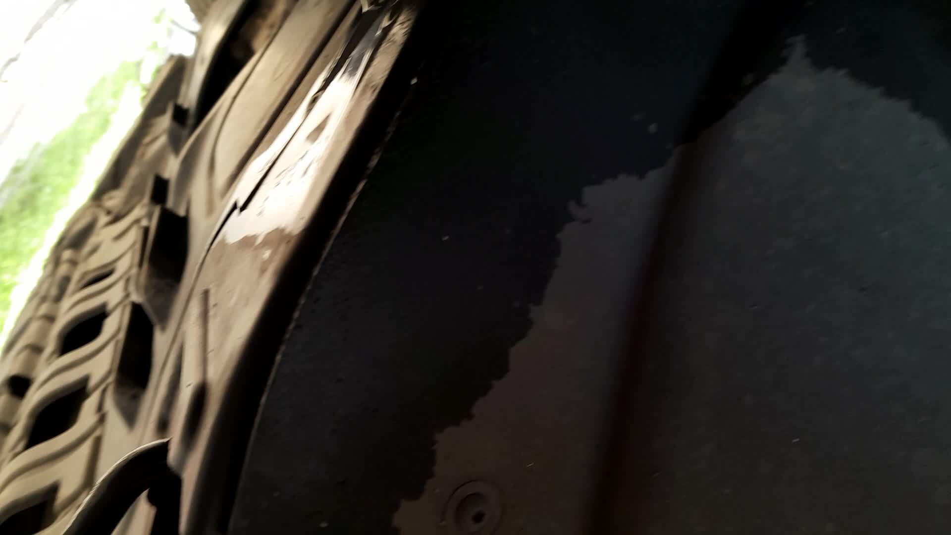

No sir. The reservoir is working properly.it is leaking coolant on passenger side near tire. I took a 30 min drive yesterday with A/C on a lot of sitting at red-light and it was halfway gone when I got home. It seems to leak out more when A/C is on.

I'm sorry I can barely see it laying flat on the ground. the car is low to ground.

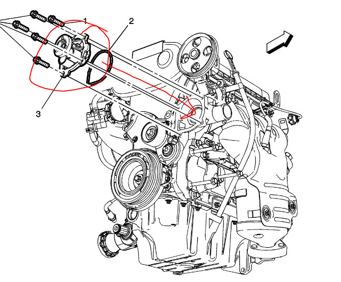

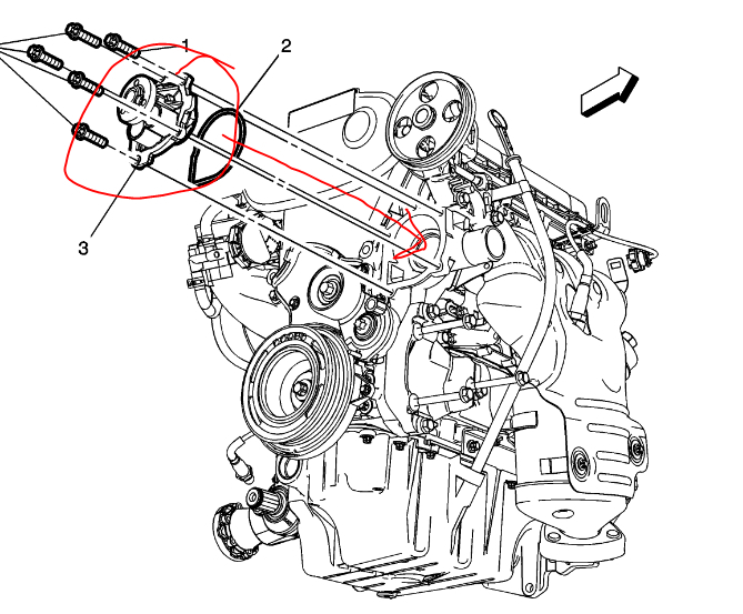

No problem. Since it is on the passenger side, my first suspect is the water pump or the radiator hose.
I attached a pic below showing the pump. Take a look in that area to see if anything is wet.
See pic below.

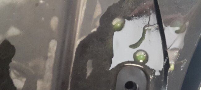

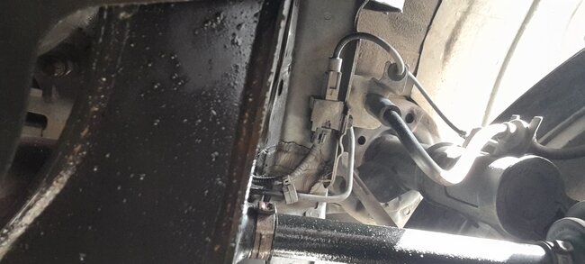

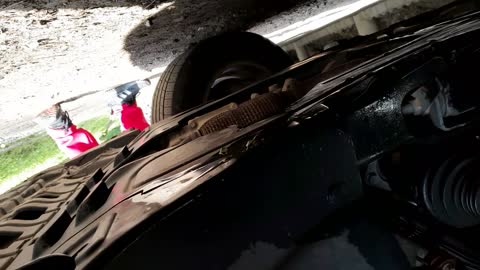

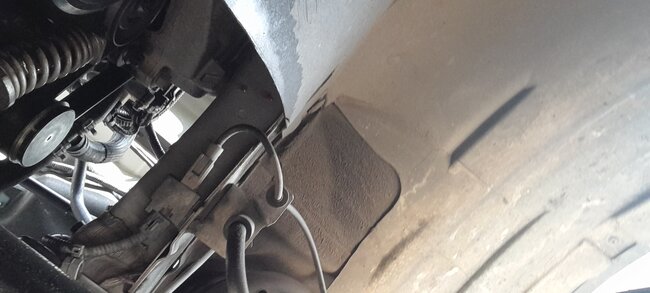

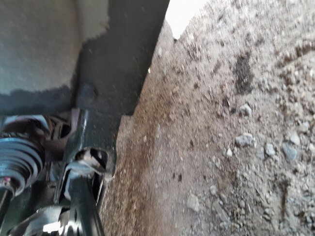

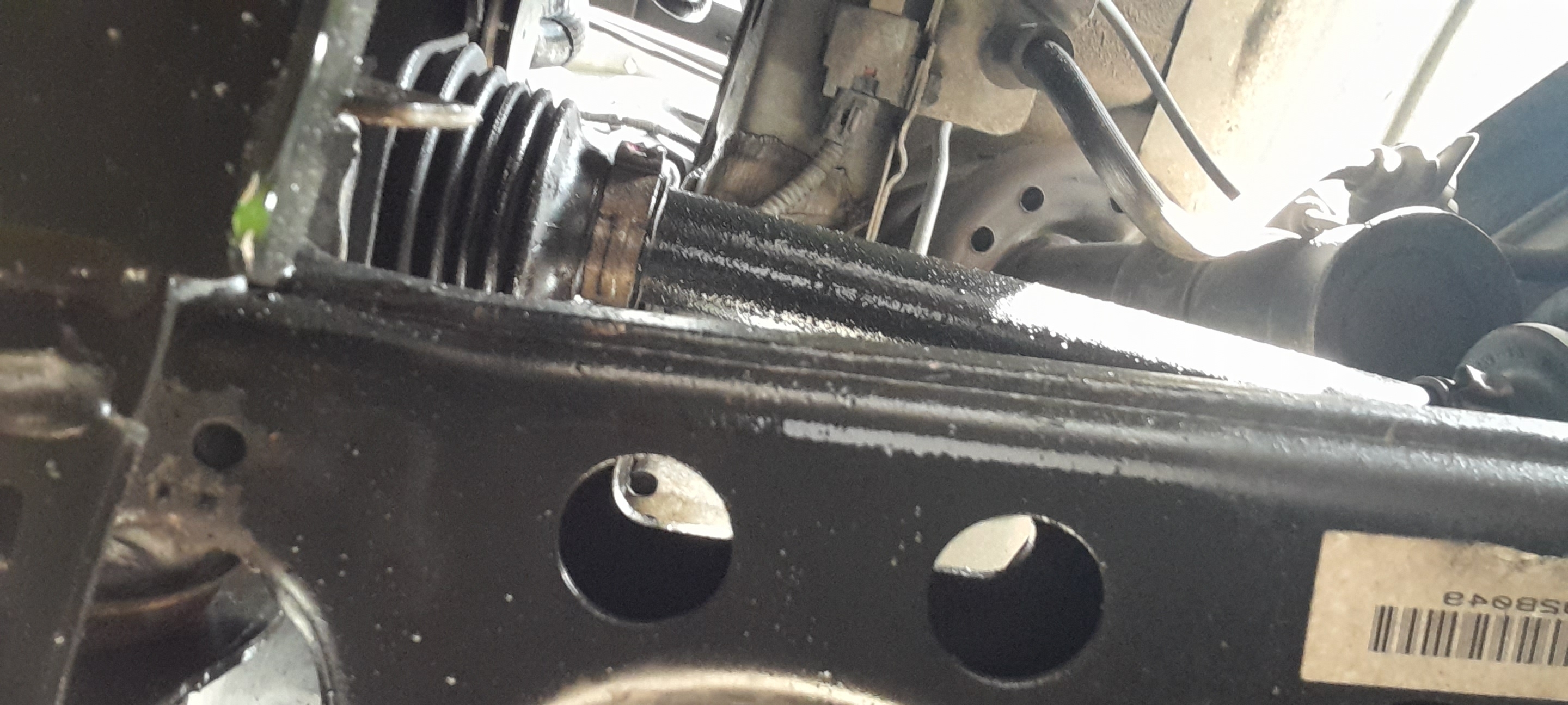

I was able to get pictures this evening and drove 1 hour away to pick up my husband. I stopped about 30 minutes in, and it was almost empty. So, it's leaking more now, and I can actually see it but it's hard to tell from where cause several places are wet and dripping so not for sure where it's leaking and where it's just getting dripped on.my camera is bad plus I had no idea what I was taking pics of. i hope this helps. And thank you.
May 29, 2023 at 12:40 PM
  • 110,240 POSTS
Your pics are fine. Based on what I am seeing, I suspect either one of the hoses is leaking or the water pump. I copied one if your pics and have an arrow pointing to where I want you to check.
Also, at this point, I would dry everything off and pressure test the system while it is cold. That will give you a chance to check without being burned by the engine.
Here is a link that explains how to pressure test a cooling system:
https://www.2carpros.com/articles/radiator-pressure-test
You will need a pressure tester, but most parts stores will lend one to you. Try this and let me know what is found.
