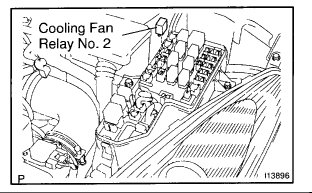

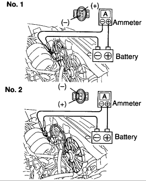

I did a full bleed on my coolant with my heat blast on high. At first the water is going through the thermostat and the heater is hot. This is when the car is park after the bleeding, but when I took the car for test drive the heater stop working and there is no heat coming out of my vent. The temperature gauge pointed to high, but when I turn on to AC while I am driving the temperature gauged goes back to normal. I did a pressure cooling system test and not leaks indication. I also did a combustion leak test and shows no leaks as well. It seems to me that the thermostat stop working while I am driving the vehicle because the lower hose where the thermostat is not hot but the other hose is very hot. I did pull out the thermostat day before and test it by soaking it into a boiling water. Thermostat started to open and close when I pour cold water. I cannot seem to figure out. Please help. Thanks

Once we are sure the cooling system is properly flowing, then we need to check the cooling fans. Here are directions for checking the fans. See pics 1 and 2.

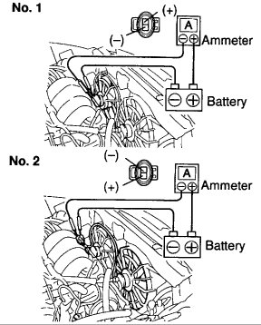

INSPECT COOLING FANS
Disconnect the cooling fan connector.
Connect battery and ammeter to the connector.
Check that the cooling fan rotates smoothly, and check the reading on the ammeter. Standard amperage: 5.2 - 8.2 A
Reconnect the cooling fan connector.
If the fans check okay, then I would recommend checking the fan relays. Here are the directions.

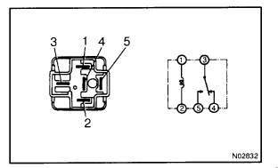

INSPECT NO. 1 COOLING FAN RELAY
Remove the relay box cover.
Remove the No. 1 cooling fan relay. (Marking: FAN No. 1)
Inspect the No. 1 cooling fan relay continuity.
Using an ohmmeter, check that there is continuity between terminals 1 and 2. If there is no continuity, replace the relay.
Check that there is no continuity between terminals 3 and 5. If there is continuity, replace the relay.
Inspect the No. 1 cooling fan relay operation.
Apply battery positive voltage across terminals 1 and 2.
Using an ohmmeter, check that there is continuity between terminals 3 and 5. If there is no continuity, replace the relay.
Reinstall the No. 3 cooling fan relay.
Reinstall the relay box cover.

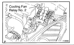

w/ A/C: INSPECT NO. 2 COOLING FAN RELAY
Remove the No. 2 cooling fan relay. (Marking: FAN No. 2)

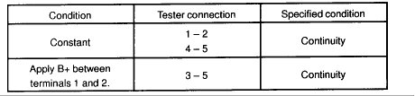

Inspect the No. 2 cooling fan relay continuity.
Check that there is continuity between terminals 3 and 4. If there is no continuity, replace the relay.
Inspect the No. 2 cooling fan relay operation.
Using an ohmmeter, check that there is no continuity between terminals 3 and 4. If there is continuity, replace the relay.
Check that there is continuity between terminals 3 and 5. If there is no continuity, replace the relay.
Reinstall the No. 2 cooling fan relay.

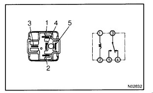

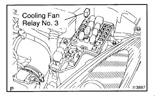

w/ A/C: INSPECT NO. 3 COOLING FAN RELAY
Remove the No. 3 cooling fan relay. (Marking: FAN No. 3)
Inspect the No. 3 cooling fan relay continuity.
Inspect the No. 3 cooling fan relay operation.
REMOVE COOLING FAN RELAY NO. 2 FROM ENGINE ROOM JIB
REMOVE COOLING FAN RELAY NO.3 FROM ENGINE ROOM J/B
INSPECT COOLING FAN RELAY NO.2 CONTINUITY If continuity is not as specified, replace the relay.
This is extensive, but will help you determine if a relay is the problem or a fan motor.
