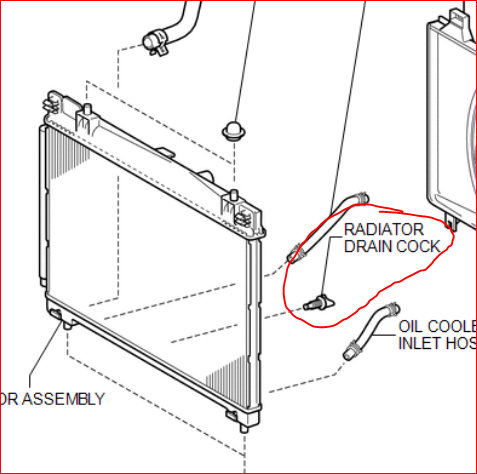

Would there be a plug on the side of the block to drain coolant out?

Hello, I am Danny.

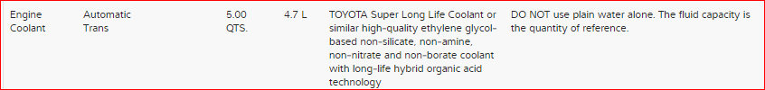

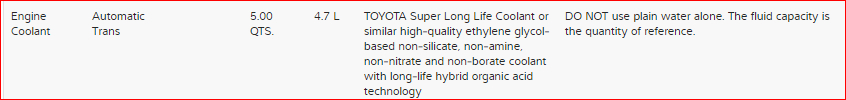

There is a drain plug located at the bottom of your radiator that allows the changing of your engine's coolant. I have attached a picture of what it looks like and in its location. I have also attached a tutorial showing what is involved to drain and flush engine coolant. I hope this helps. I am including a picture of yours cars specifications as to what is needed. Feel free to ask any questions if needed. Thanks for using 2CarPros.
Danny-
https://www.2carpros.com/articles/coolant-flush-and-refill-all-cars

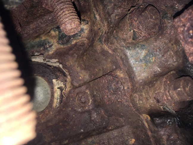

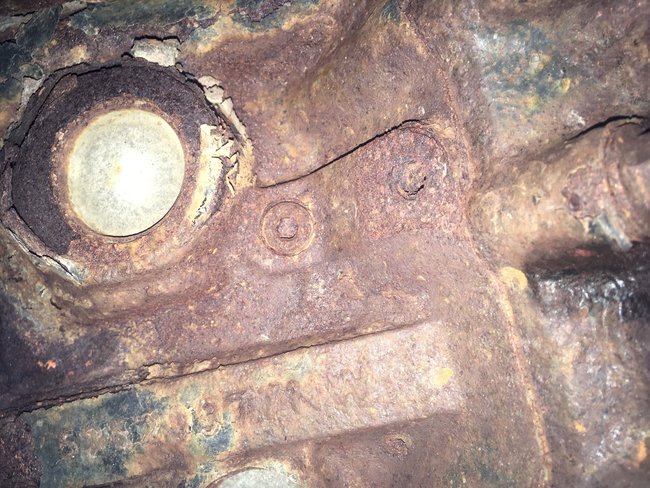

Cannot find drain plug anywhere unless this Allen head looking plug is the drain plug if so no way it is coming out.
