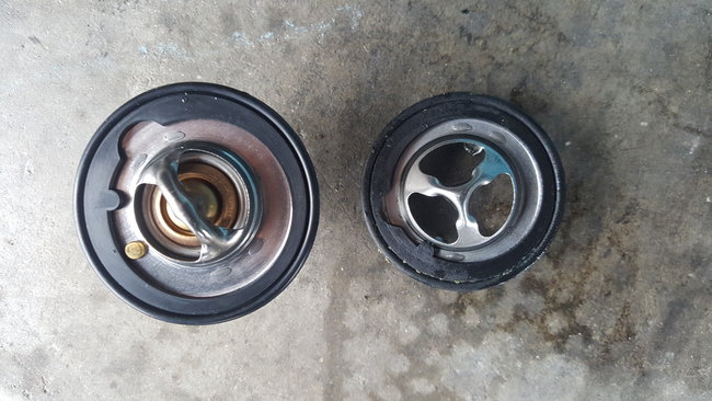

Okay, so about four months ago i change out the thermostat so i figure id replace it again. I will attach a picture of the old that i put in. Keep in mind i did not do that to my old one i guess the shop did it.
Jan 15, 2019 at 7:52 AM
  • 110,244 POSTS
Wow. The guts are missing. Did you remove the missing parts from the engine? Now I'm starting to wonder if there is a blockage forcing coolant back to the radiator.

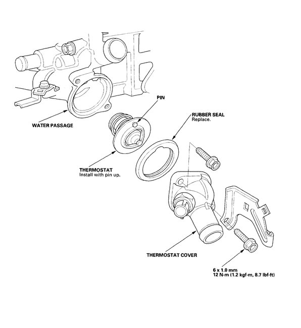

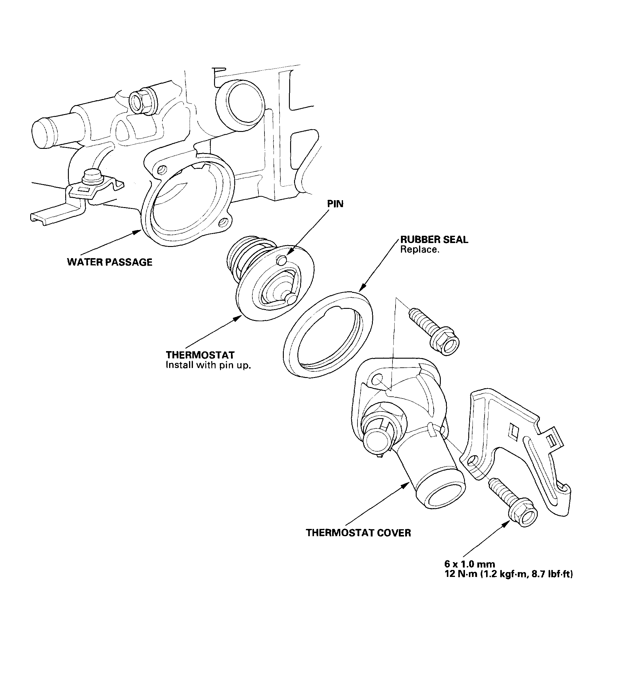

I have attached a picture showing the position of the what I call a jiggle valve, but in the picture it is referred to as a pin. Make sure the gasket is position the way it's shown too. If that pin is blocked or not positioned correctly, you will have a hard time getting air from the system.
Let me know if this helps.

ALEX19899
  • 171 POSTS
I believe the shop i took it to removed the guts from the thermostat.
Jan 15, 2019 at 10:02 AM
  • 110,244 POSTS
I hope so. Has there been any change since you replaced it?
Jan 15, 2019 at 11:59 AM
ALEX19899
  • 171 POSTS
Since replacing it my temperature goes to the middle mark and before it would only go half way to the middle mark.
Jan 15, 2019 at 12:07 PM
  • 110,244 POSTS
That makes total sense. With the guts missing from the thermostat, there was no restriction of coolant flow, so the engine could never warm up. Did this eliminate the issue with coolant loss? Also, I can't believe they put the bad thermostat back in. Confirm they removed the missing part.
