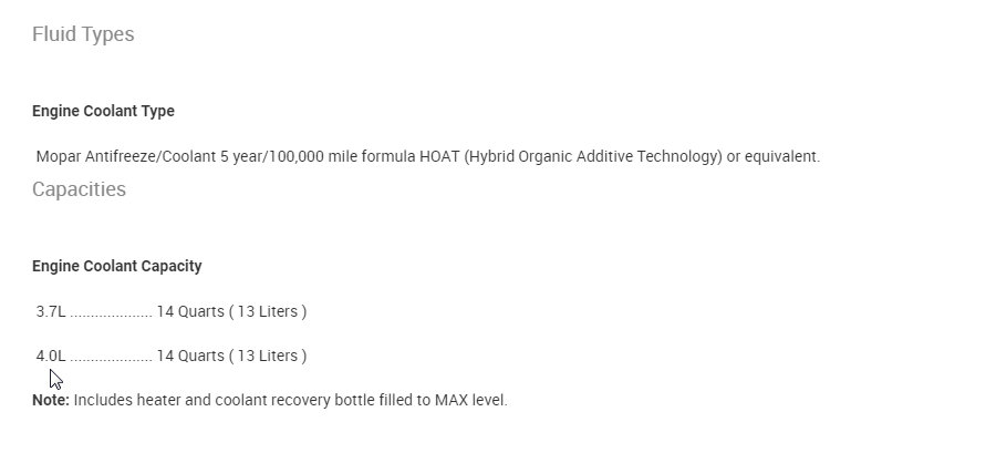

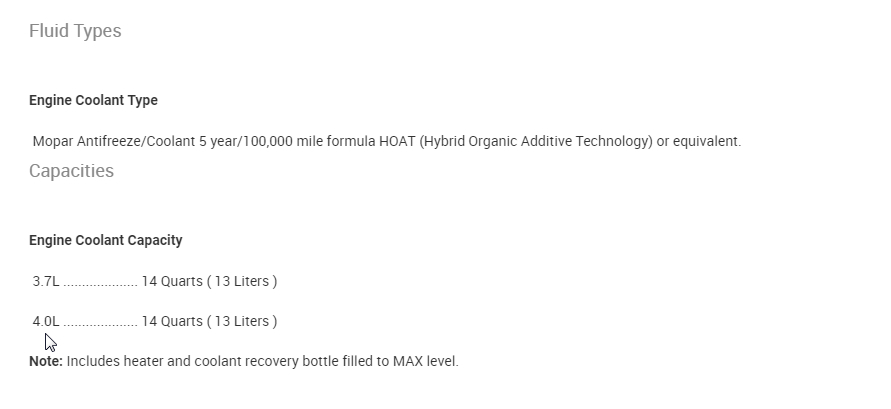

Can I use Havoline universal antifreeze/coolant in my car listed above?
Jan 2, 2020 at 2:06 AM
It appears this coolant is OAT or organic additive technology. Your vehicle takes HOAT or Hybrid Organic Additive Technology.
If you mix them with then you will have issues. I would suggest sticking with the Mopar fluid but you must use any HOAT coolant. If the bottle doesn't say HOAT or Hybrid Organic then it is not and you should not use it even if it says it is compatible with all coolants.
