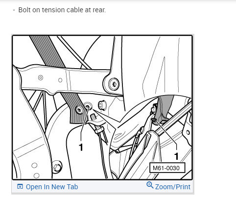

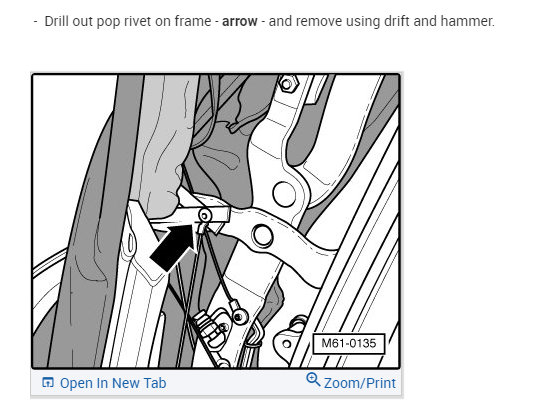

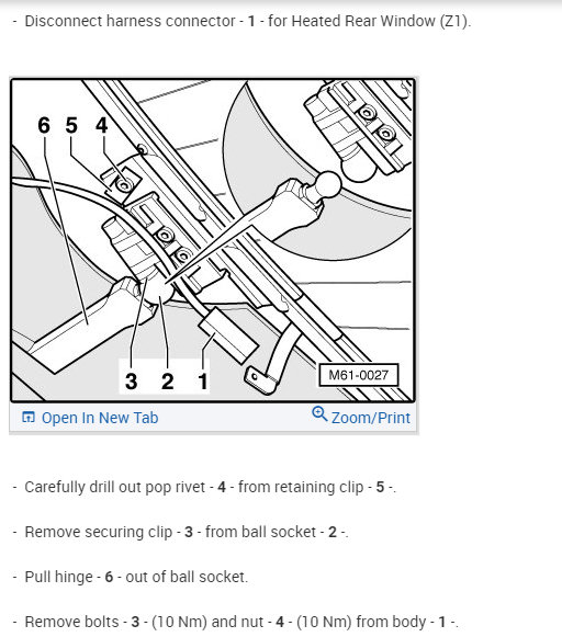

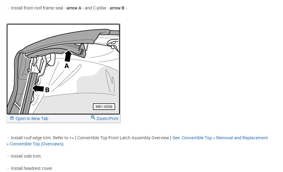

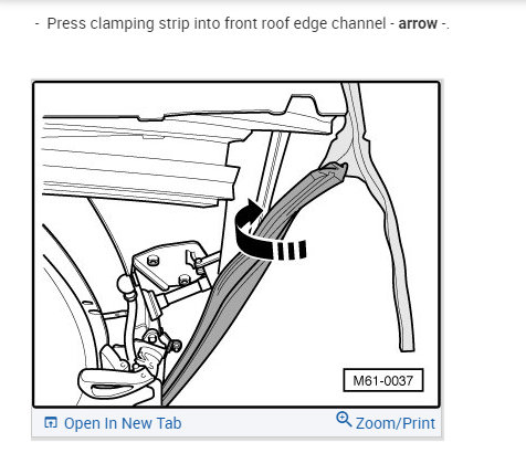

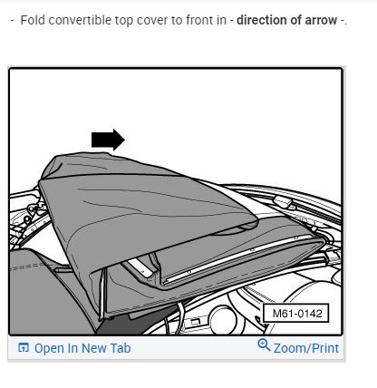

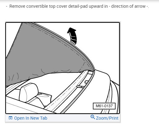

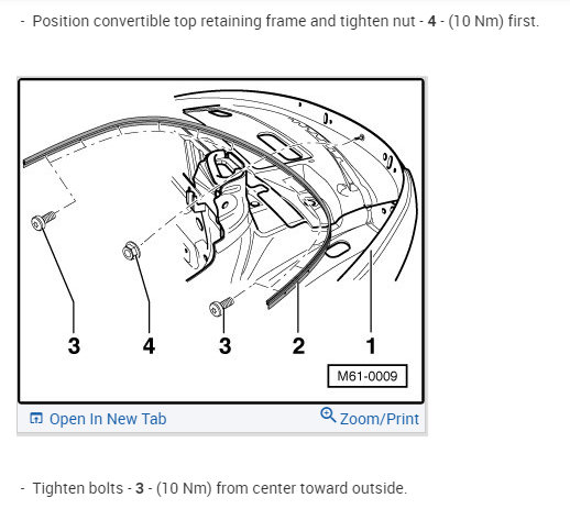

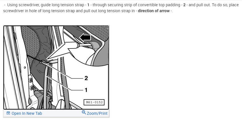

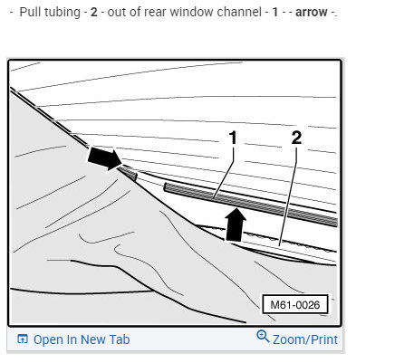

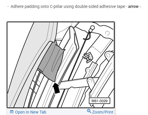

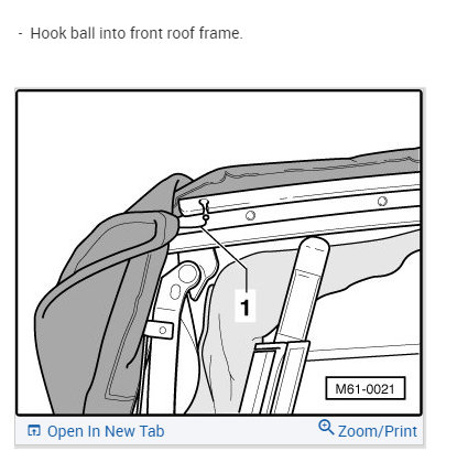

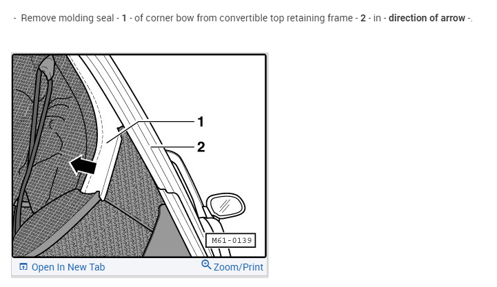

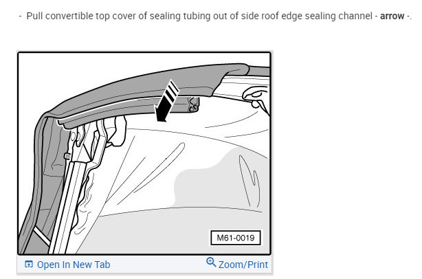

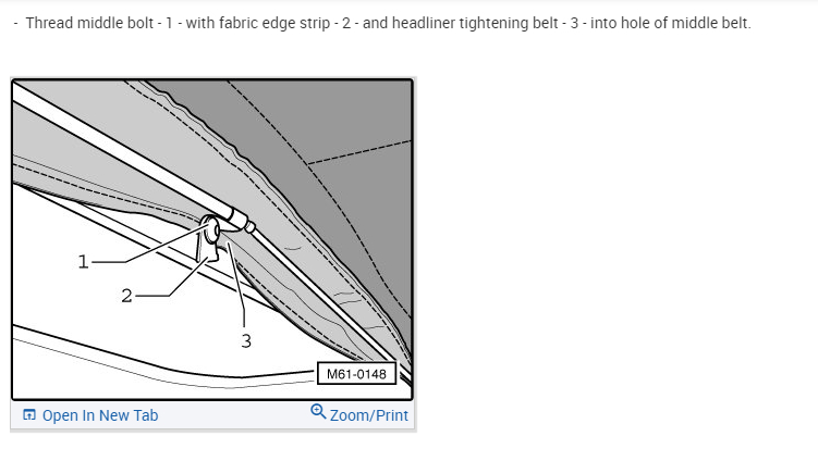

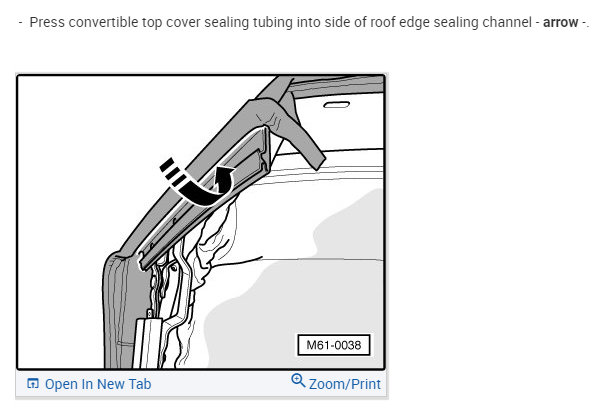

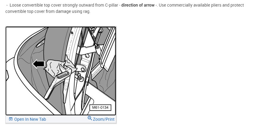

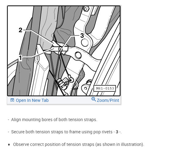

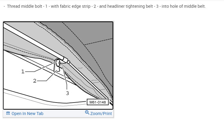

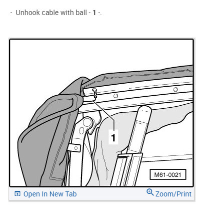

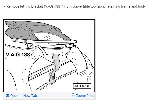

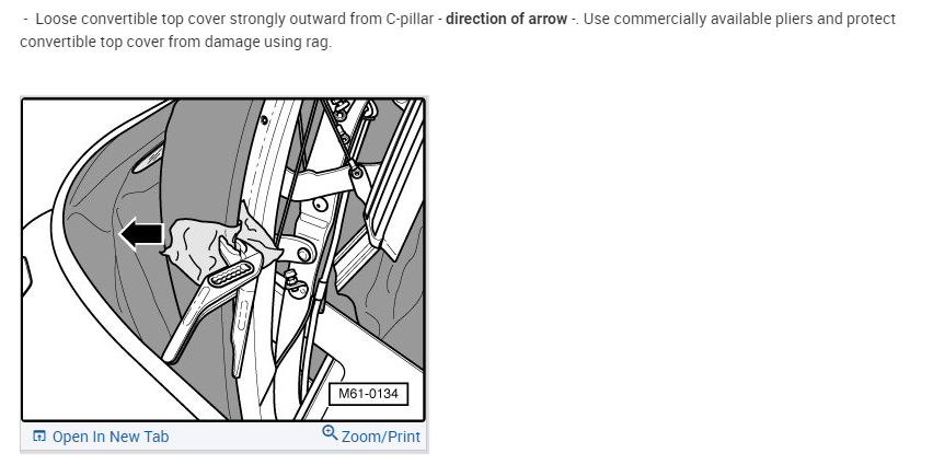

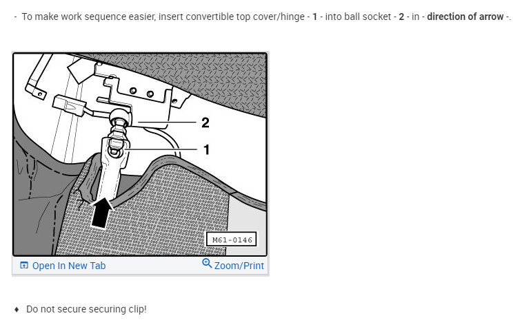

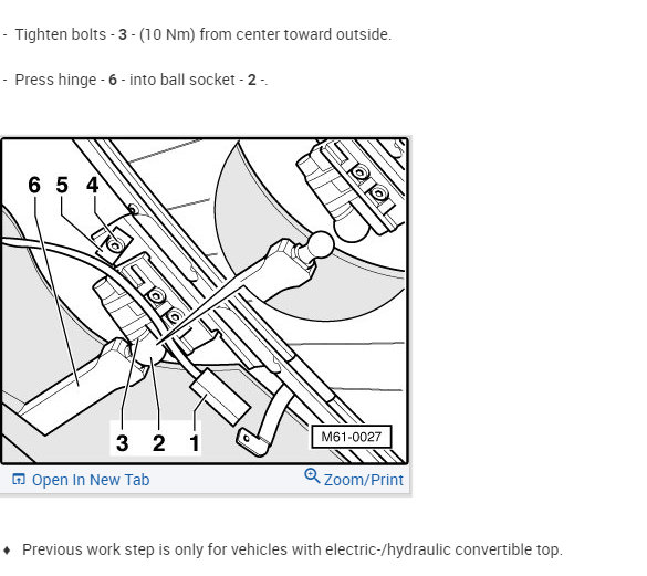

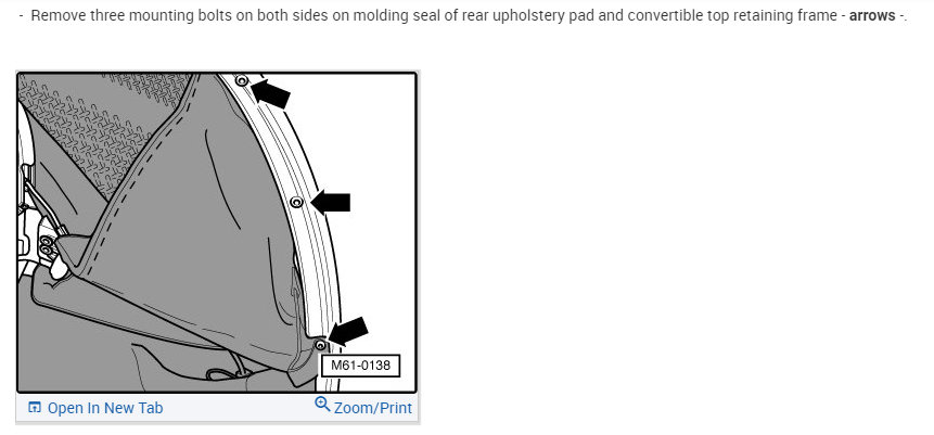

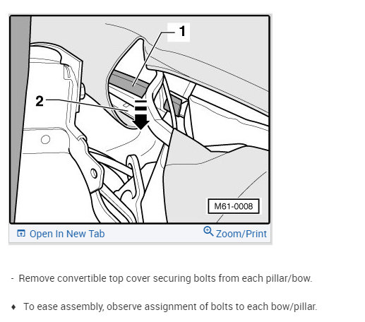

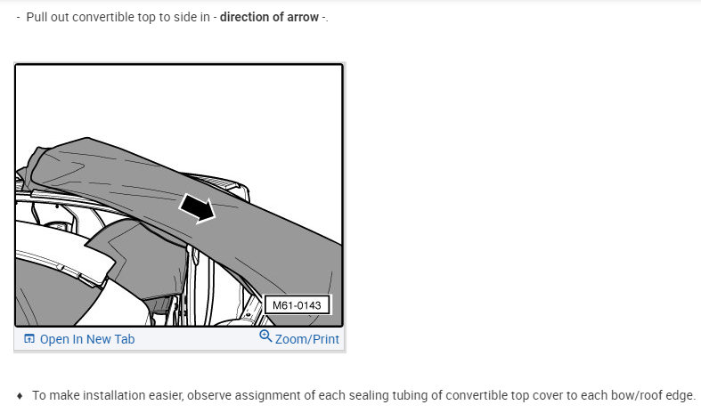

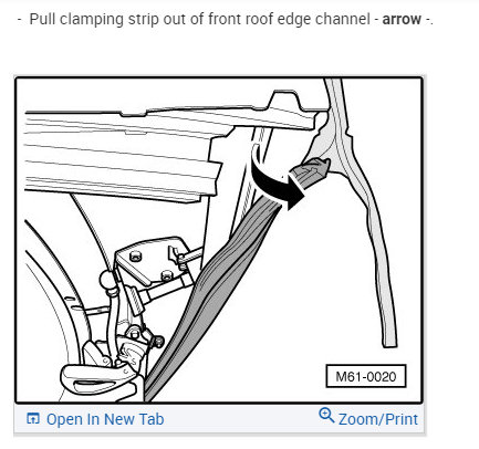

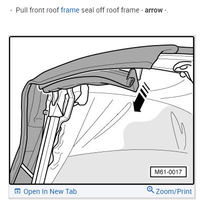

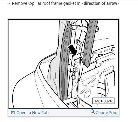

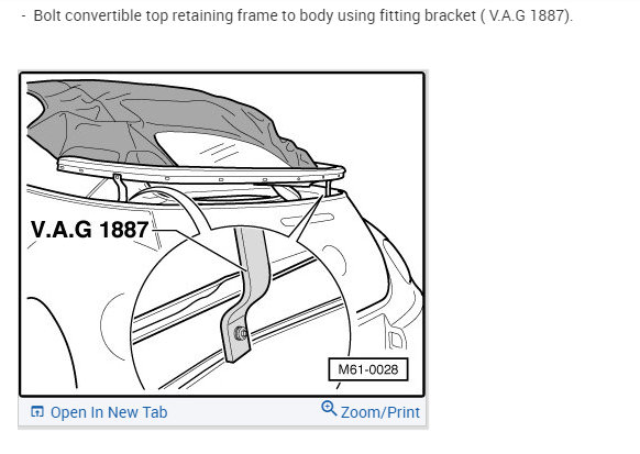

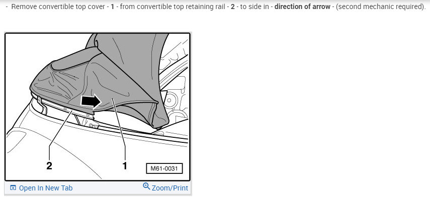

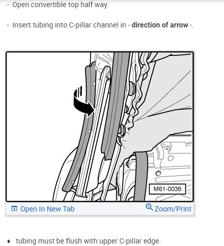

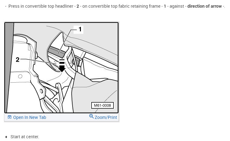

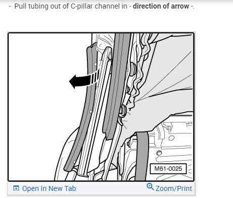

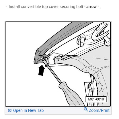

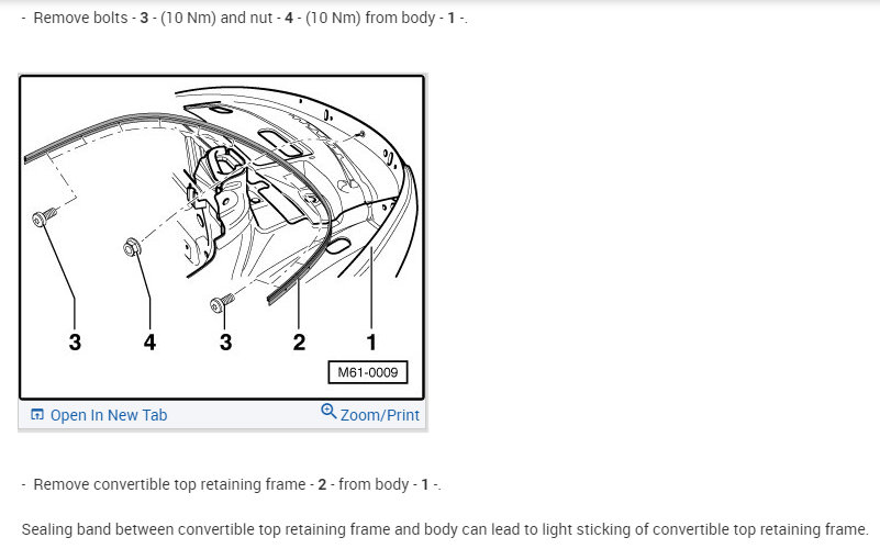

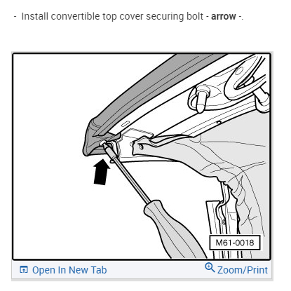

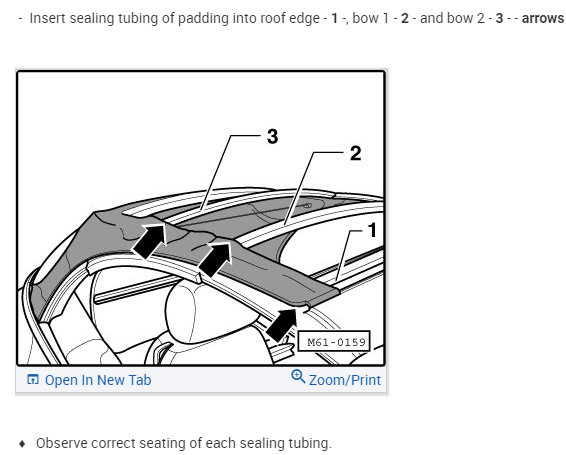

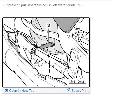

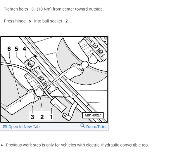

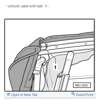

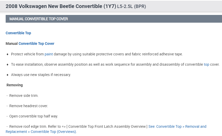

I am replacing the manual convertible top and am in need of instructions. Can you help me?
Jul 20, 2022 at 10:37 AM
  • 110,236 POSTS

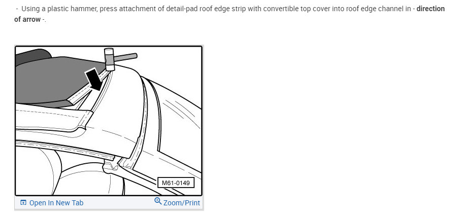

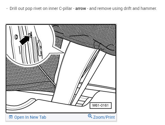

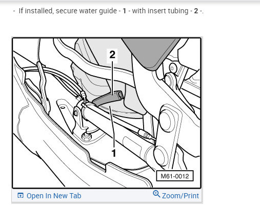

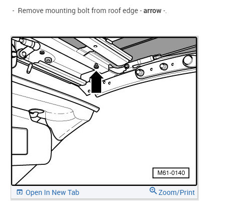

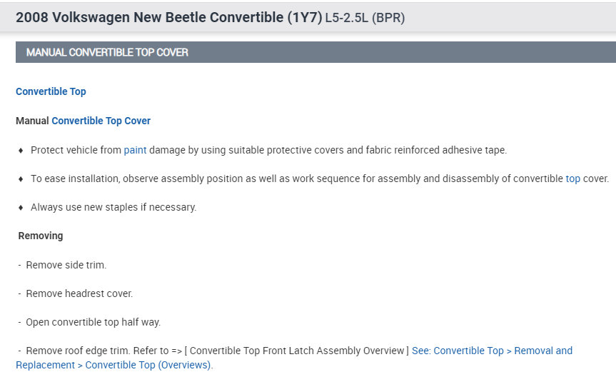

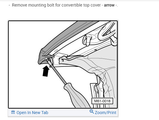

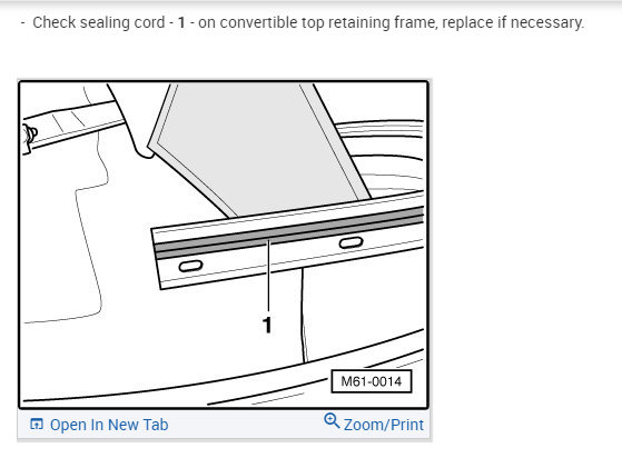

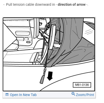

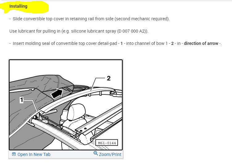

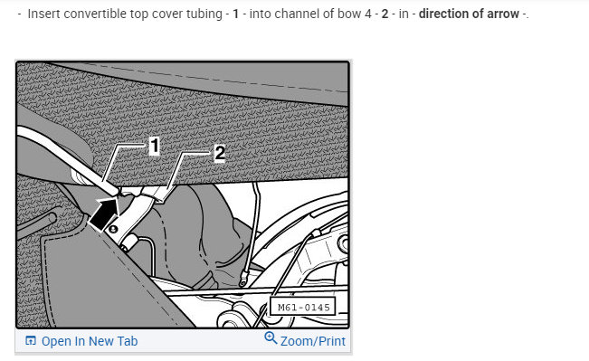

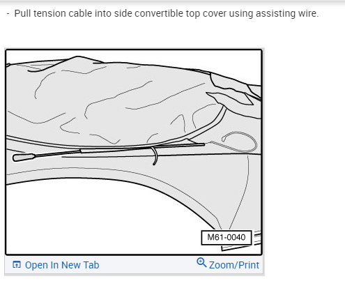

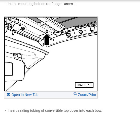

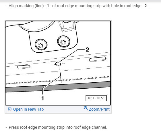

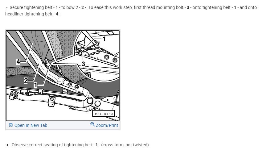

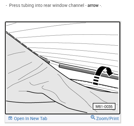

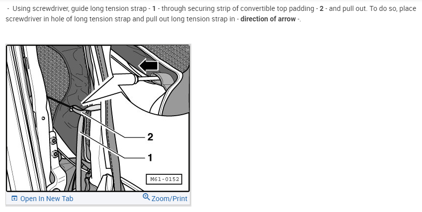

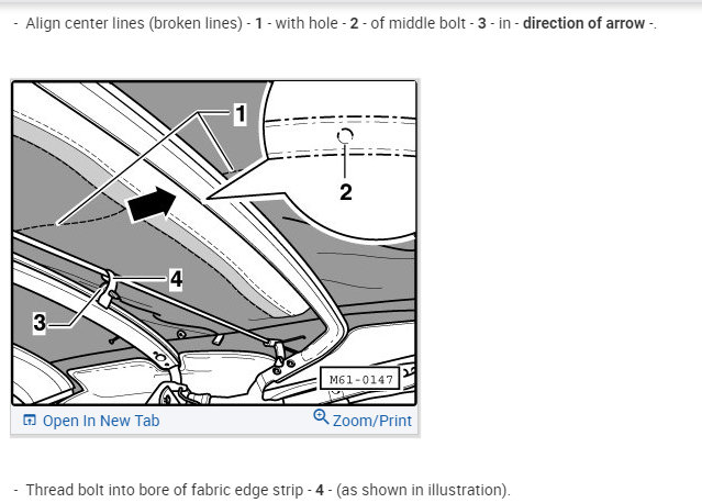

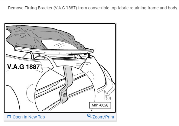

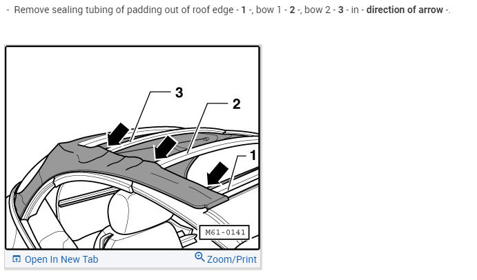

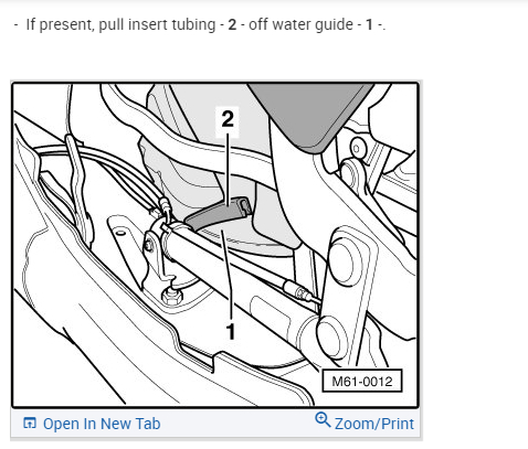

I hope you're sitting when you see the directions. LOL There are several steps, but I did include both the removal and installation of the top.
In the pics below, you will notice approximately halfway through I highlighted the title of one of the pics. That is where the installation begins.
I hope this helps. Let me know if you have questions and how things turn out for you.
