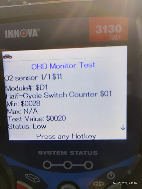

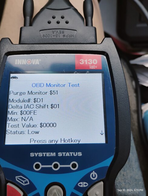

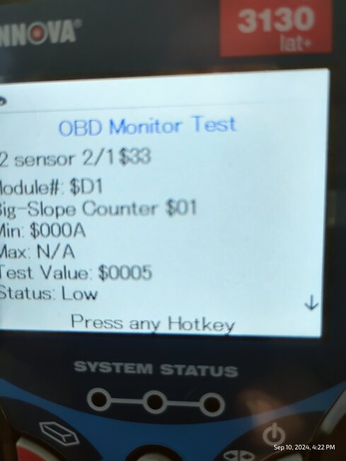

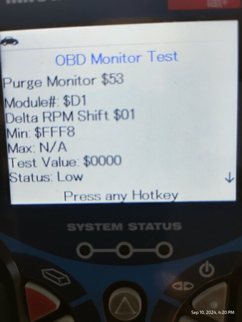

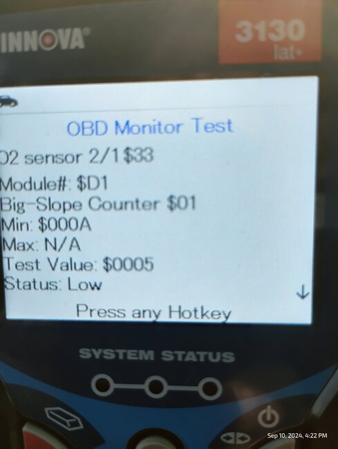

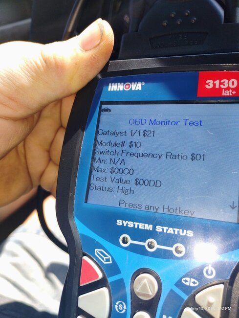

What all should I look at with cat code p0420? It seems to not have a lot of power at times, 02 sensor possible. Bank 1 ? I'm getting a catalytic insufficient. So, I'm not sure this factor it.02 tests show a few saying low on them an 1 says high. The cat tests say normal on some an high on one. Not sure if that's a indication or just what it's measuring but the temperature or use. Sometimes it seems a bit sluggish on acceleration. System tests not codes..on pics See last pic too cat high ..But are these readings only showing standings an not meaning there's a problem .?

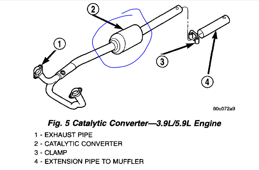

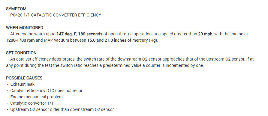

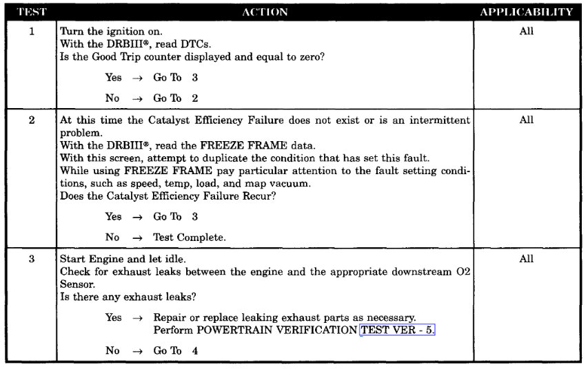

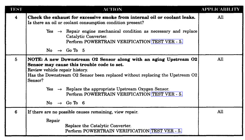

Make sure there are no exhaust leaks before the converter. If there is, fix that first. Next, I attached the diagnostics below for testing. Take a look through them and let me know if you are comfortable performing them.
Also, take a look through this link. It explains how to test it as well. Note there is only one converter on this truck, so that makes it a bit easier.
Let me know what you find.

Usually, you will hear it. Oftentimes when it is near the exhaust manifold or at the manifold, it can sound like a ticking.
When you have the engine running, do you notice anything like that? Also, if you can get your hands on an infrared thermometer, it is easy to check if the temps are off at the converter itself.
To check when the engine is at operating temperature, test the inlet and outlet temperatures of the catalytic converter. The outlet should be a good bit hotter due to the chemical reaction taking place in the converter. The outlet should be between 30°F and 100°F hotter.
