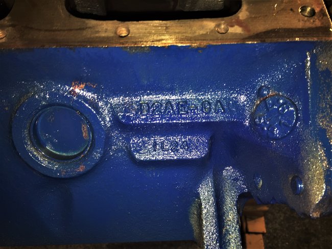

This has gotten to point can't drive truck. Things done and tested: carburetor o/h, Edlebrook 1405. Played with jets and rods. Isolated ignition circuits. Start circuits, changed distributor, pick up. Replaced box. Compression test, 150 across all cylinders. Installed ballast resistor. Voltage seems a bit high out of ballast and increases as rpm goes up, even with regulator disconnected. I've been a master tech over twenty years, I am 64 Monday and had a wrench in my hand since I was about 13. I feel like I'm missing something just can't put my finger on it Thank you for any and all help.

Thanks for all the input. As stated just did valve adjust, and got worse, did the adjust per firing order, (covers off, plugs out) engine only has 2,100 miles on it. Block casting below. All started about seven months ago, with a major backfire from exhaust. Flash of light so bright it reflected off a white wall as I pulled up to a stop sign. Just left work 05:00. Denver. Truck had been flawless for eighteen months. Seems like I've made matters worse with every attempt. I do not know why it happened, no amount of checking has lead to cause of first backfire, nor any repair has changed anything for the better, only gotten worse. Now I sound like I'm whining
