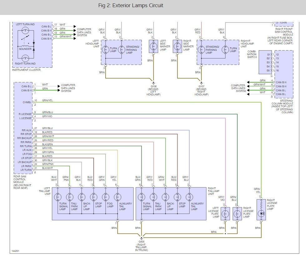

Controls on dashboard and all lights flickering
2000 MERCEDES BENZ S500
165,000 MILES • 8.0L • V8 • RWD • AUTOMATIC
DWAYNE ROBINSON
Flickering interior and exterior lights and headlights. Mostly when it rains. Off and on.
Jun 3, 2017 at 10:45 AM
  • 55,224 POSTS

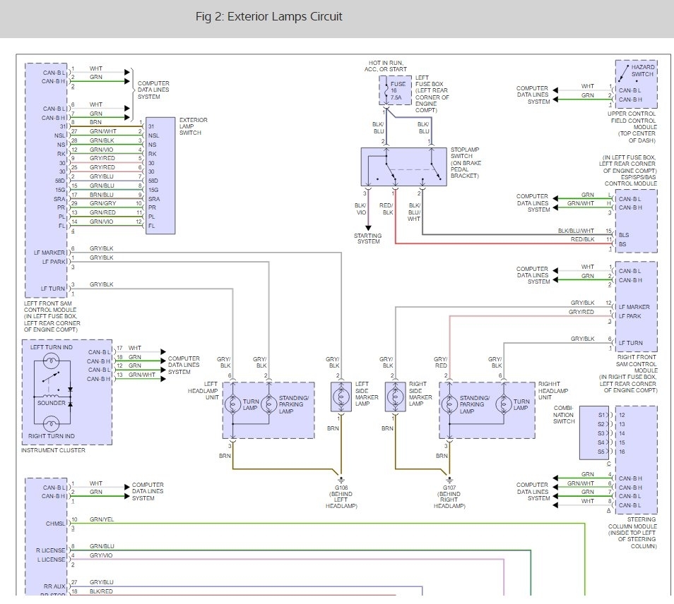

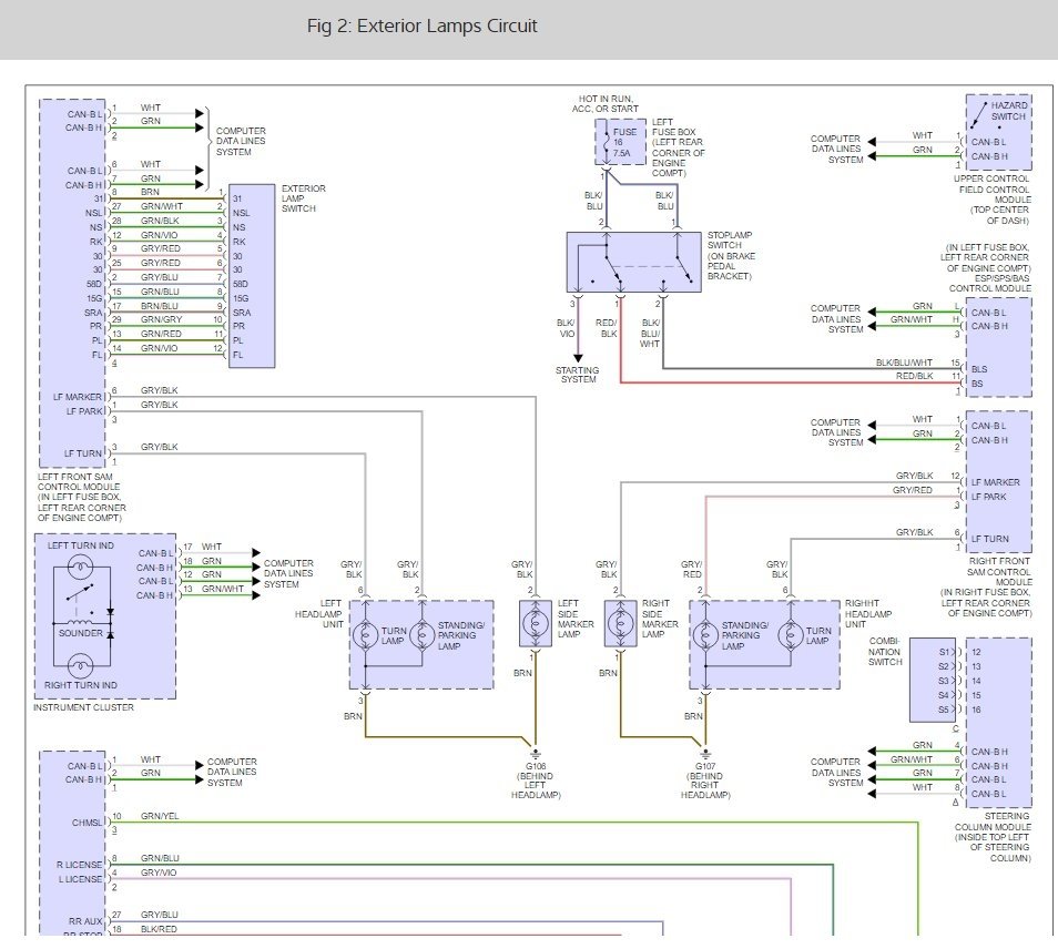

It sounds like one of two things is happening, Either the system has a bad ground or the lighting computer or SAM is starting to go out. Here is a wiring diagram and a guide so you can do some testing to figure out which one it is.
Please run some tests and get back to us so we can continue helping you.
