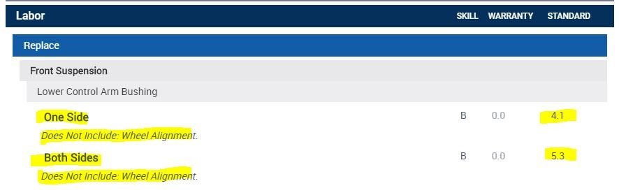

The control arm is an important structural component of the steering and suspension. As far as a cost, the parts price will be determine on where they are purchased and if an aftermarket part is available. I can, however, provide you the flat rate time for the repairs. If you look at picture 1, I attached the labor rates based on if one or both are done. The number on the right indicates hours.

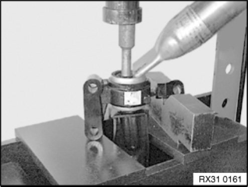

Mount control arm as pictured on press. Heat rubber mount with hot air blower.
NOTE: When pressing out the wishbone, ensure that the inner sleeve of the rubber mount does not remain on the wishbone pin.

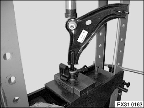

pic 6
Force control arm with press and a suitable tool out of rubber mount.
Replace rubber mount

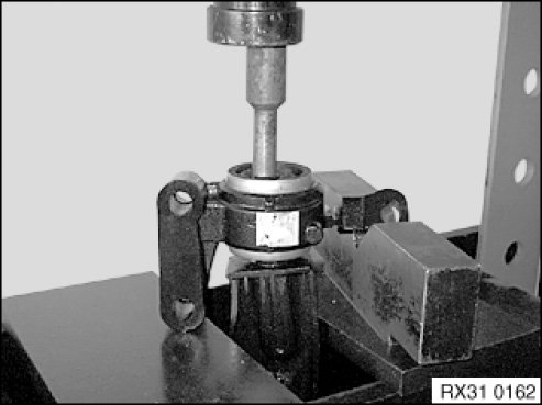

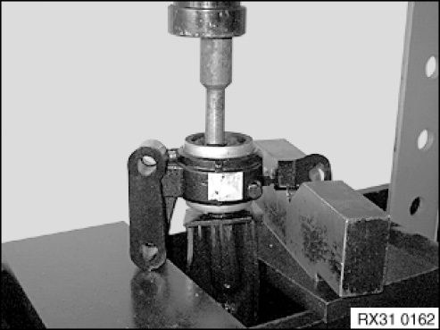

pic 8
Apply a generous coating of Circo Light (sourcing reference: BMW Parts Service) to control arm pin and inner sleeve of rubber mount.
Lay bracket on work surface of press.
Align control arm to bracket and press from above into rubber mount (up to stop).
NOTE: Gap between control arm and rubber mount is 6 ± 2 mm after installation.
