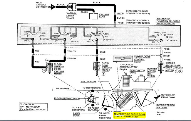

I have several problems with my truck but i will start with two. First it constantly blows heat, after it warms up, even when the heater is turned off. The truck is at running temperature and i have already replaced the thermostat. This is a diesel are they supposed to run this hot?
The other problem i want to address right now is the blower motor for the heater does not work. It will blow heat but wont push it out in the winter. Where should i start looking before winter hits again?

The idea that you can't turn the heat off sounds related to what is called the blend air door actuator. This actuator is responsible for the air temperature entering the vehicle.
If I remember correctly, on this year and model, it is controlled by a cable. When you try to change the temp from hot to cold or opposite, do you feel resistance in the slide? If you look at the attached pic, I highlighted where the cable is mentioned. Start by checking to make sure that cable is not broken, disconnected, or loose.

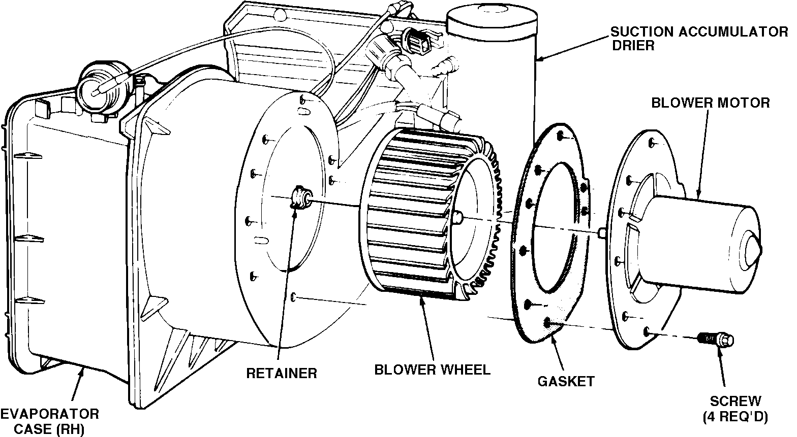

If you have power and ground, here are the directions for replacement:
1990 Ford Truck F 350 4WD Pickup V8-7.3L DSL
Blower Motor
Vehicle Heating and Air Conditioning Blower Motor Service and Repair Procedures Blower Motor
BLOWER MOTOR
1. Disconnect battery ground cable.
2. On California models, remove emission module forward of blower motor.
3. Disconnect electrical connector and cooling tube from blower motor.
4. Remove blower motor and wheel attaching screws.
Fig. 27 Disassembled view of blower motor & wheel assembly
Pic 2
5. Move cooling tube aside and carefully remove blower motor assembly from vehicle, Fig. 27.
6. Reverse procedure to install.
With Air Conditioning
2. Disconnect air cooling tube and electrical connector from blower motor.
3. Remove blower motor attaching screws and the blower motor assembly.
4. Reverse procedure to install.

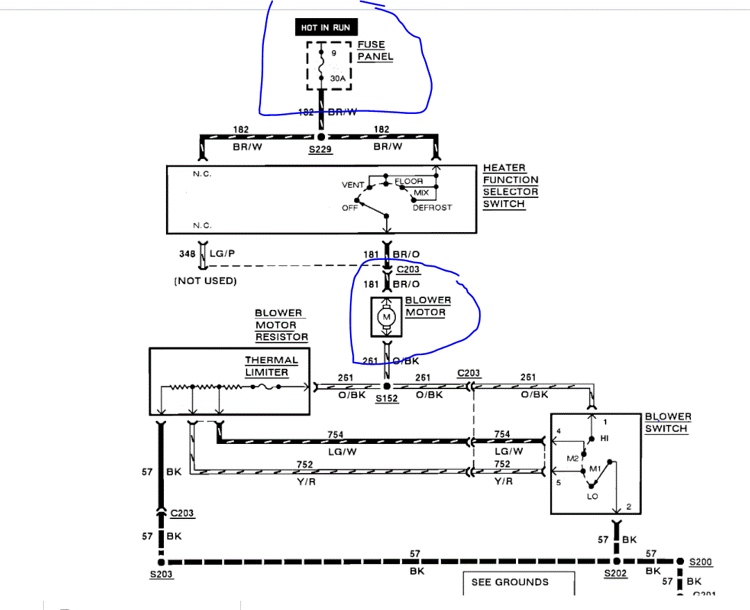

The blower motor has a plug. But i should get power from testing inside the plug but i have nothing. What next?

If you have no power to the blower motor, first check fuse 9 in the fuse panel. If there it is good, confirm there is power to it. If there is, move to the brown wire with the orange tracer and see if there is power to it at the motor.
See the attached pic.

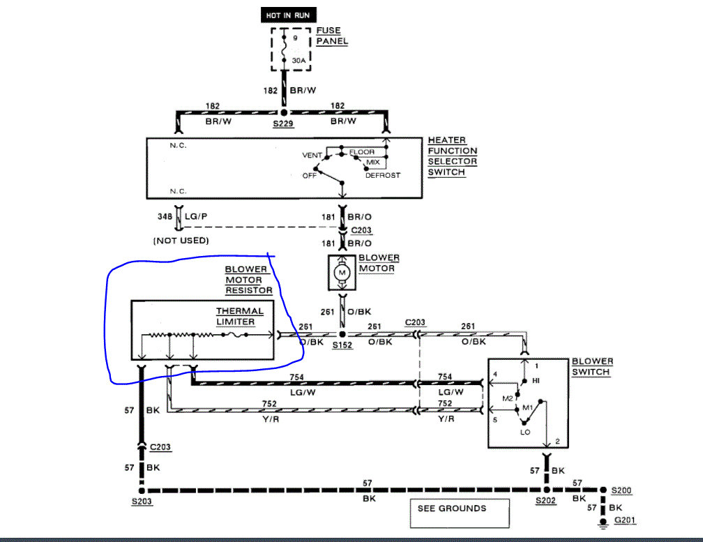

So there does not seem to be a cable to switch hot to cold. But i did switch it to where the cable should go. Its no longer blowing heat. I wonder if you can give me a part number for that please.
The blower motor has power. The fuse has power. So i would imagine i need to find the resistor. So if u have a diagram for that i would appreciate it. But it also makes me wonder if its the switch to turn it on. A lot of bare plug ins under the dash. One of them was plugged in but not all the way. When plugged it in all the way there was nothing..

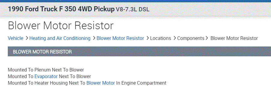

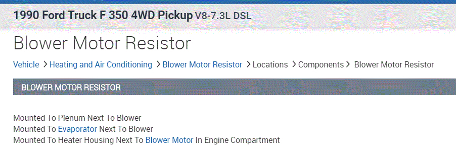

I attached two pics below. The first one is the wiring schematic for the blower motor/resister. The second one is for the resister location. Note that the manual indicates three possible locations.
Which part number are you referring to?
