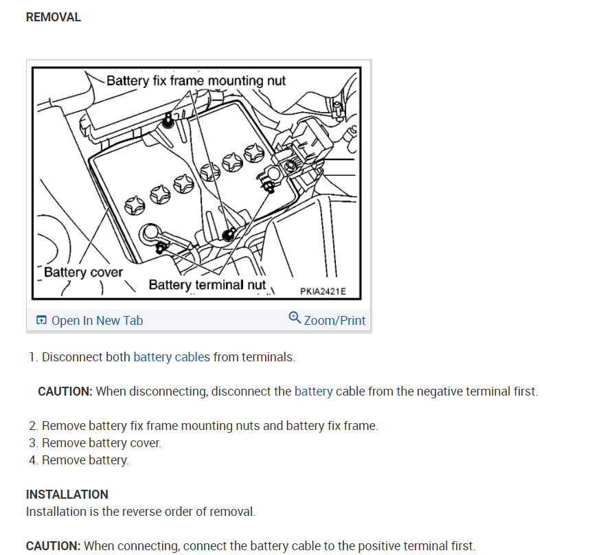

Good morning,
How did you load test the battery? I attached a guide for you to view.
When you jump a dead battery, it never gets to full charge that soon. This sounds like the battery is the culprit.
https://www.2carpros.com/articles/how-to-replace-a-car-battery
