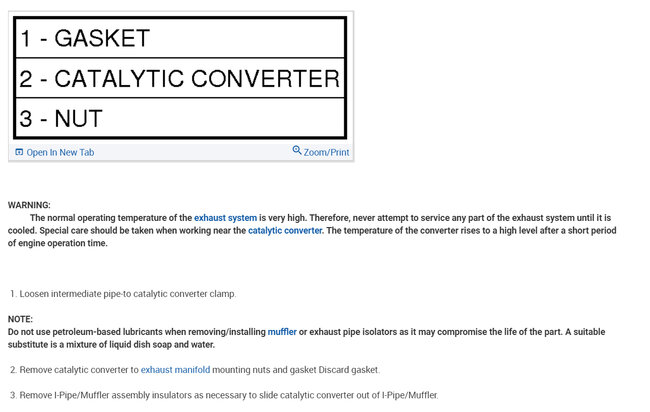

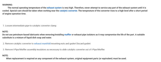

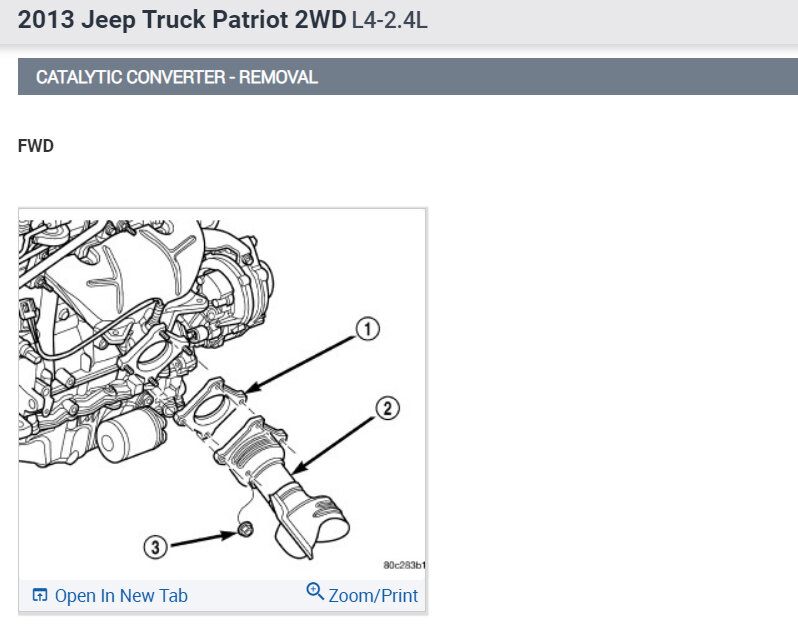

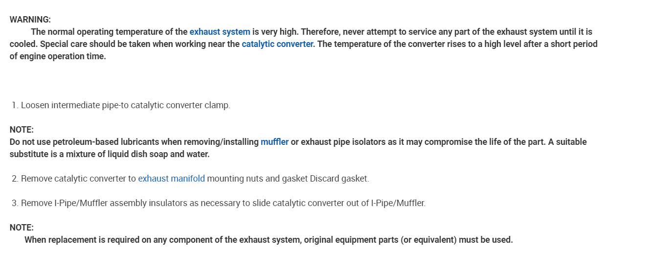

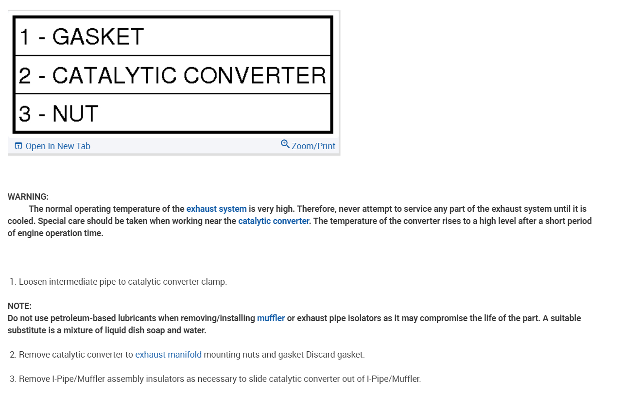

The P0420 code indicates that the catalytic converter is not functioning as efficiently as it should be. So, it looks like the catalytic converter is bad here is how to change it out in the images below. Check out the images (below). Please let us know if you need anything else to get the problem fixed.
