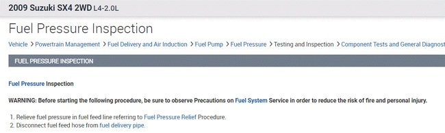

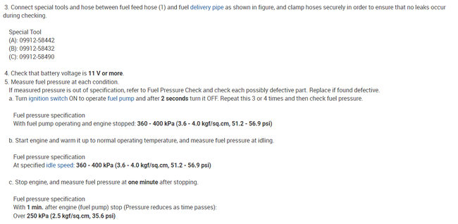

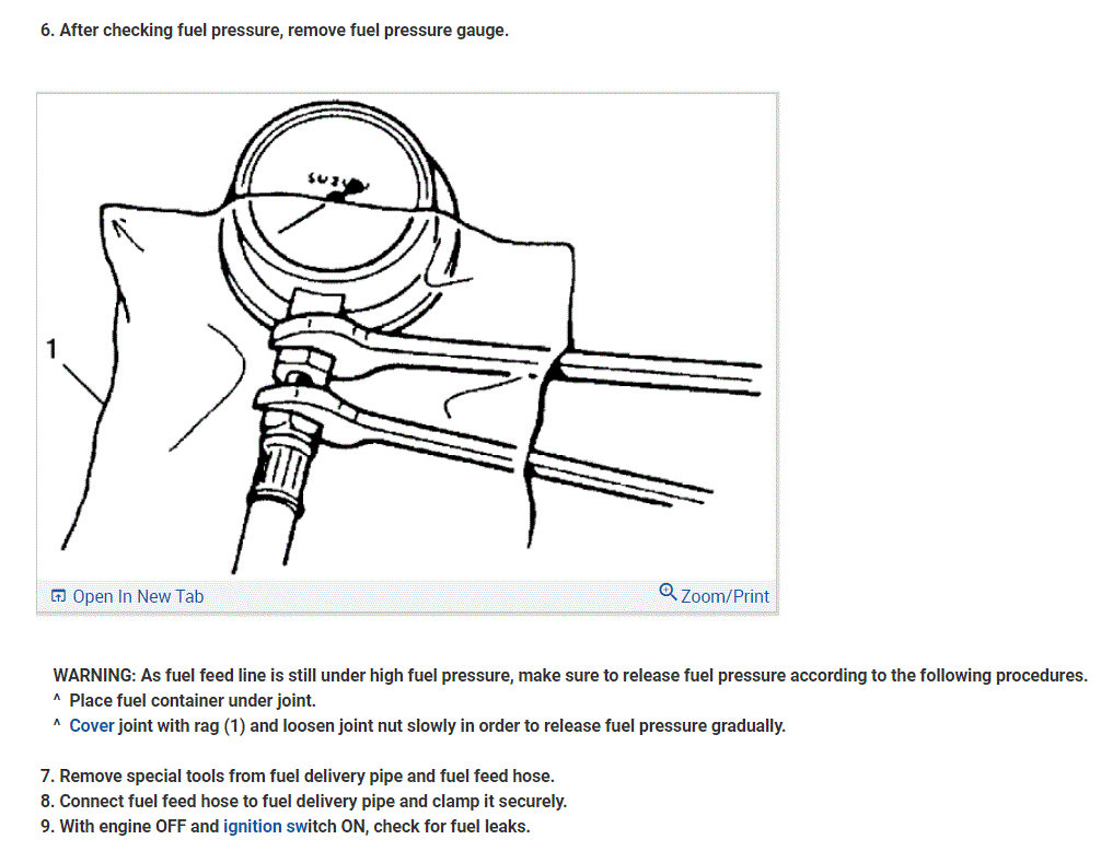

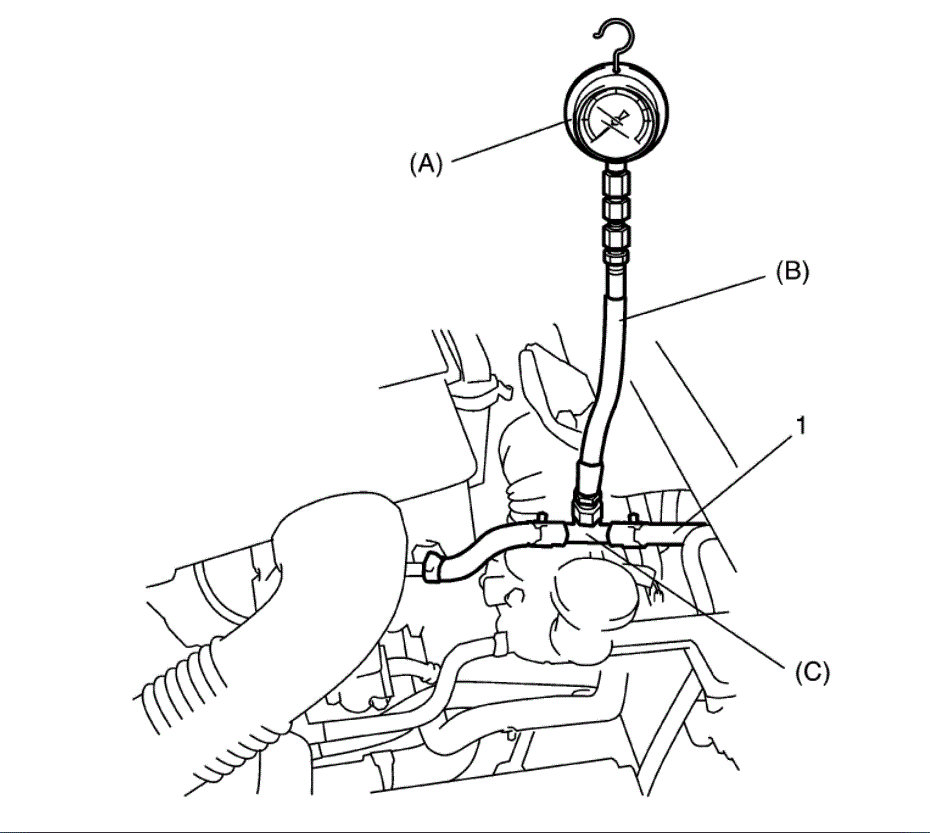

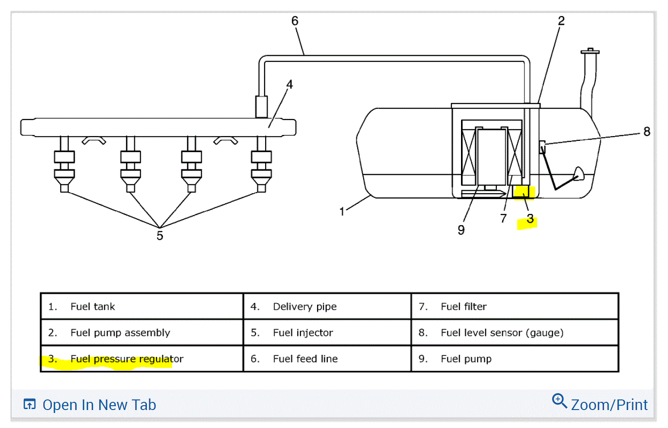

If the engine is getting too much fuel, that is the problem. Since the light is on, I do suggest having the computer scanned. I'm not sure where you are located, but most parts stores will do it free of charge.

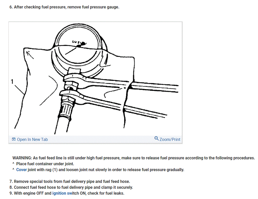

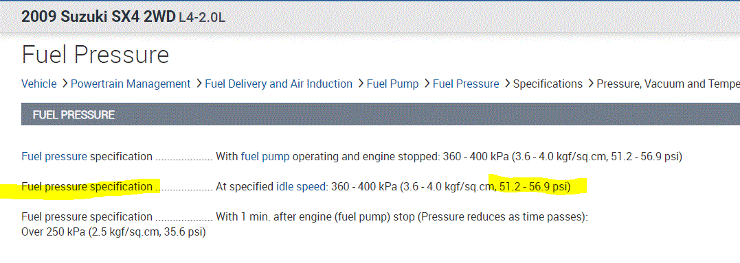

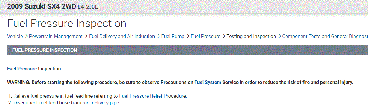

Next, we need to check fuel pressure. Here is a link that shows in general how it's done:
Pic 1 below shows the manufacturer's specifications for fuel pressure. The remaining pics show how to test pressure specific to your vehicle. You will need a fuel pressure gauge, but most parts stores will lend one to you.
If the pressure is too high, the fuel pressure regulator is likely bad. It is located in the fuel tank. The very last pic below shows its location.
I do suggest having the computer scanned so we know exactly what diagnostic trouble codes are stored. If you do, let me know what codes are found.
Let me know if I can help or if you have other questions.

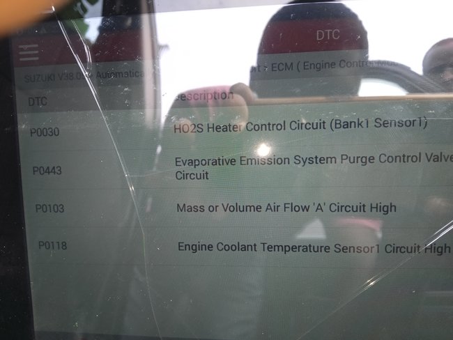

BAMMI
  • 6 POSTS
Hello Joe,
Been able to get a technician to do a computer scanning. Below are the results. Also attached here is the snapshot of the result from the computer screen of the technician.
HO2S Heater Control Circuit (Bank1 Sensor1) P0030
Evaporative Emission System Purge Control valve Circuit P0443
Mass or Volume Airflow 'A' Circuit High P0103
Engine Coolant Temperature Sensor1 Circuit High P0118
Aug 15, 2021 at 7:52 PM
  • 110,241 POSTS
There are a couple of things there that can cause the issue. The mass airflow sensor (MAF) is higher than 4.5v which is beyond where it should be. That can certainly cause an issue. Also, the coolant temp sensor is exactly the same. The voltage is higher than 4.5v. And also can cause the problem.
Here is what needs to be done: Since they are both showing high voltage (MAF and ECT), I don't think the sensors are bad. Instead, I have a feeling there is a short to power.
The first thing I would check is the reference voltage to both. Each should have a 5v reference from the PCM. I suspect they will be a good bit higher. If they are, then the tech needs to determine where the short is located.
Do you know if that has been checked?

BAMMI
  • 6 POSTS
Thanks.
Tech said short is from the ECU.
Aug 17, 2021 at 11:19 AM
  • 110,241 POSTS
That will do it. Something internal must have shorted. If you have a chance, let me know if that takes care of your problem.
