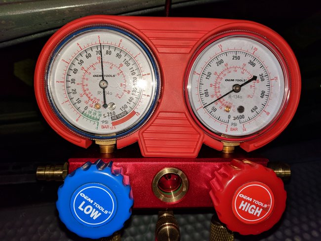

I checked error codes and there were none. Both fans are running and pulling air through the condenser. While using the OBD2 scanner I did notice after a while the (ACP) sensor reading went from Open to Closed and kicked off the compressor clutch
I then had to wait a few hours for things to cool before I could get the compressor clutch to to engage again to get readings with a set of gauges. It is currently 77° and I have got an LP of 24 and a HP of just over 150 (see photo). The LP started around 30 then after ten to fifteen minutes dropped to 24.

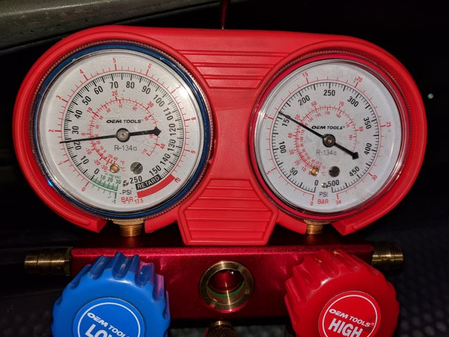

Static pressure readings as well in case it helps, LP 73, HP 70.

Those pressures are low add more refrigerant the high side should be closer to 230.
