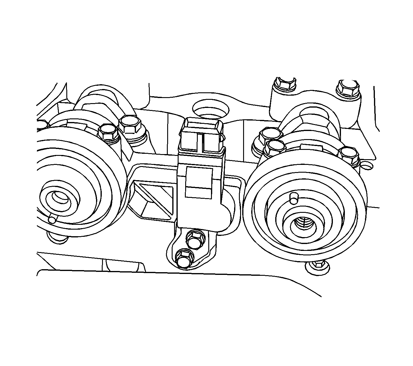

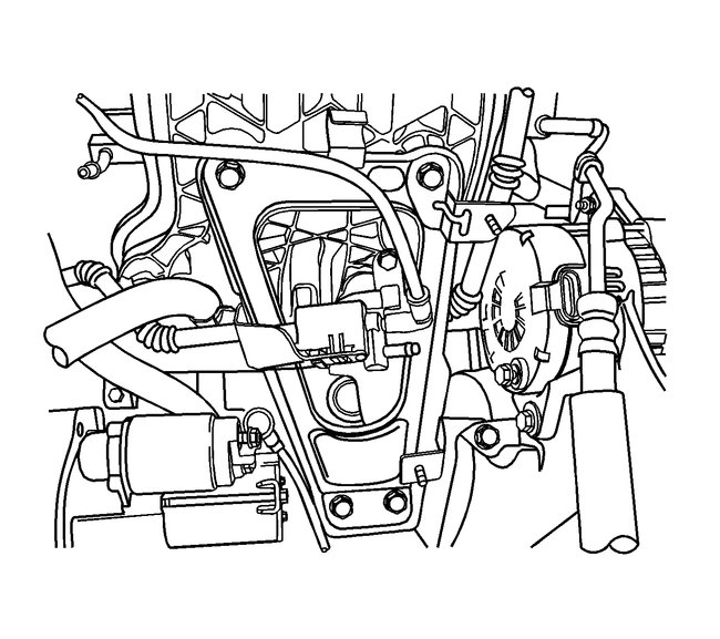

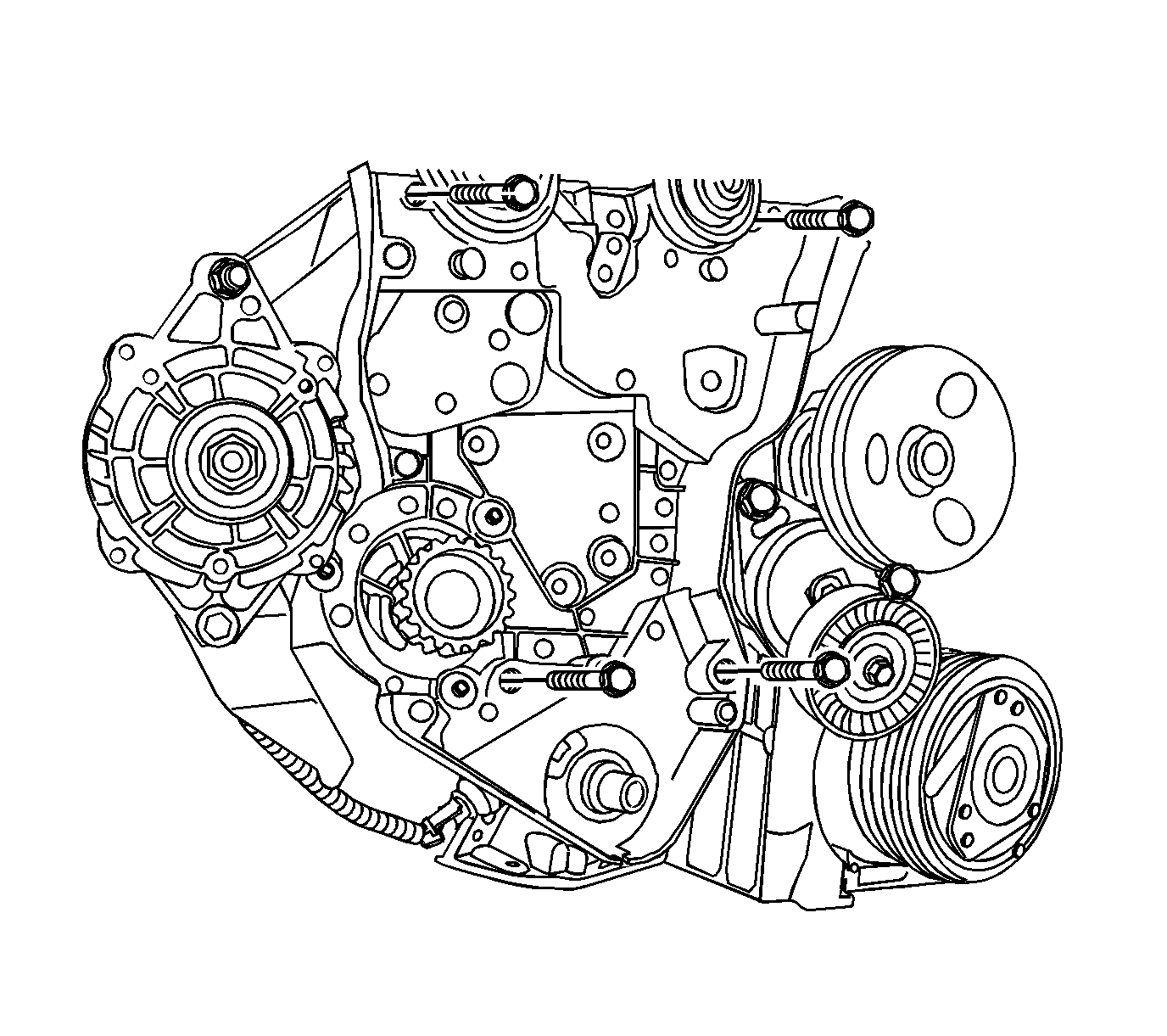

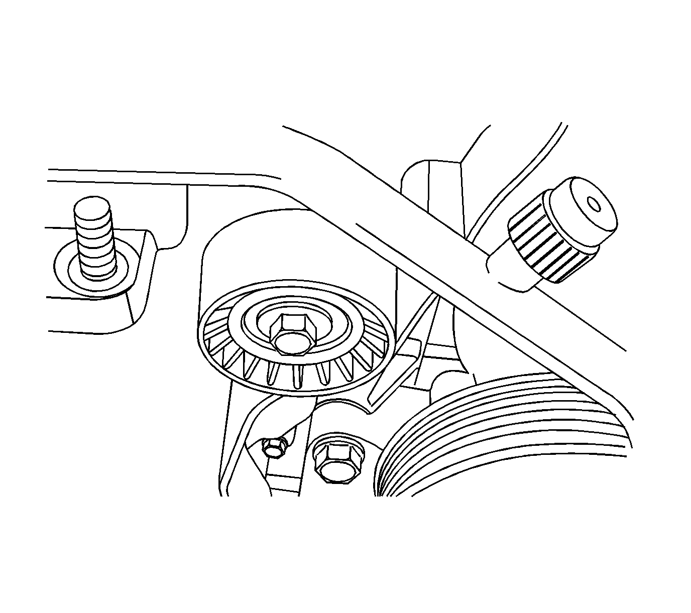

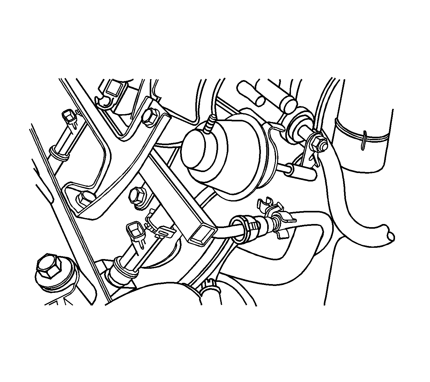

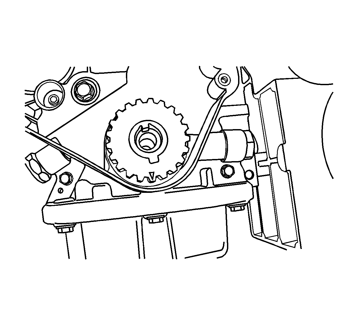

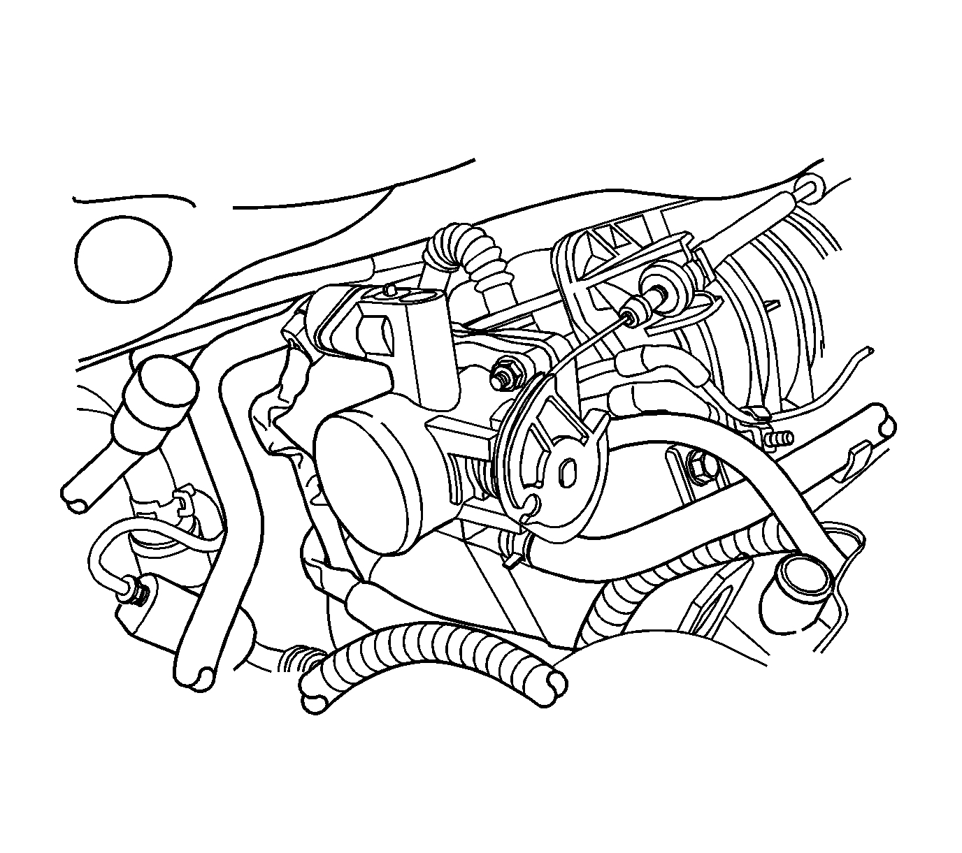

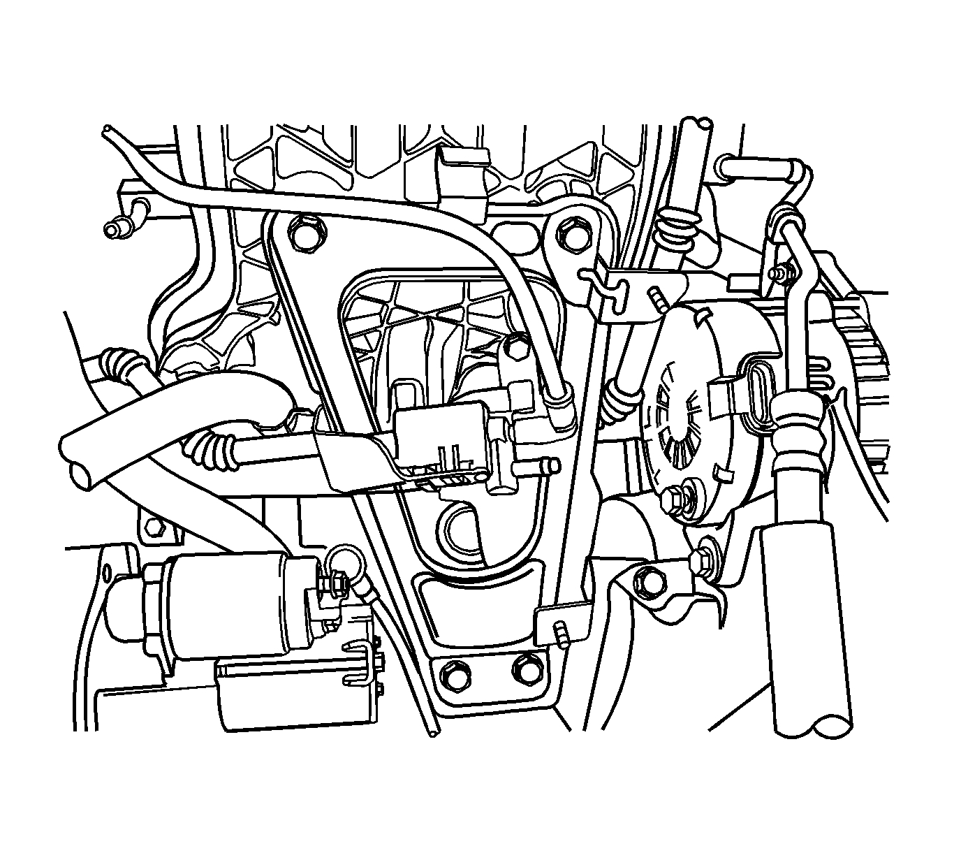

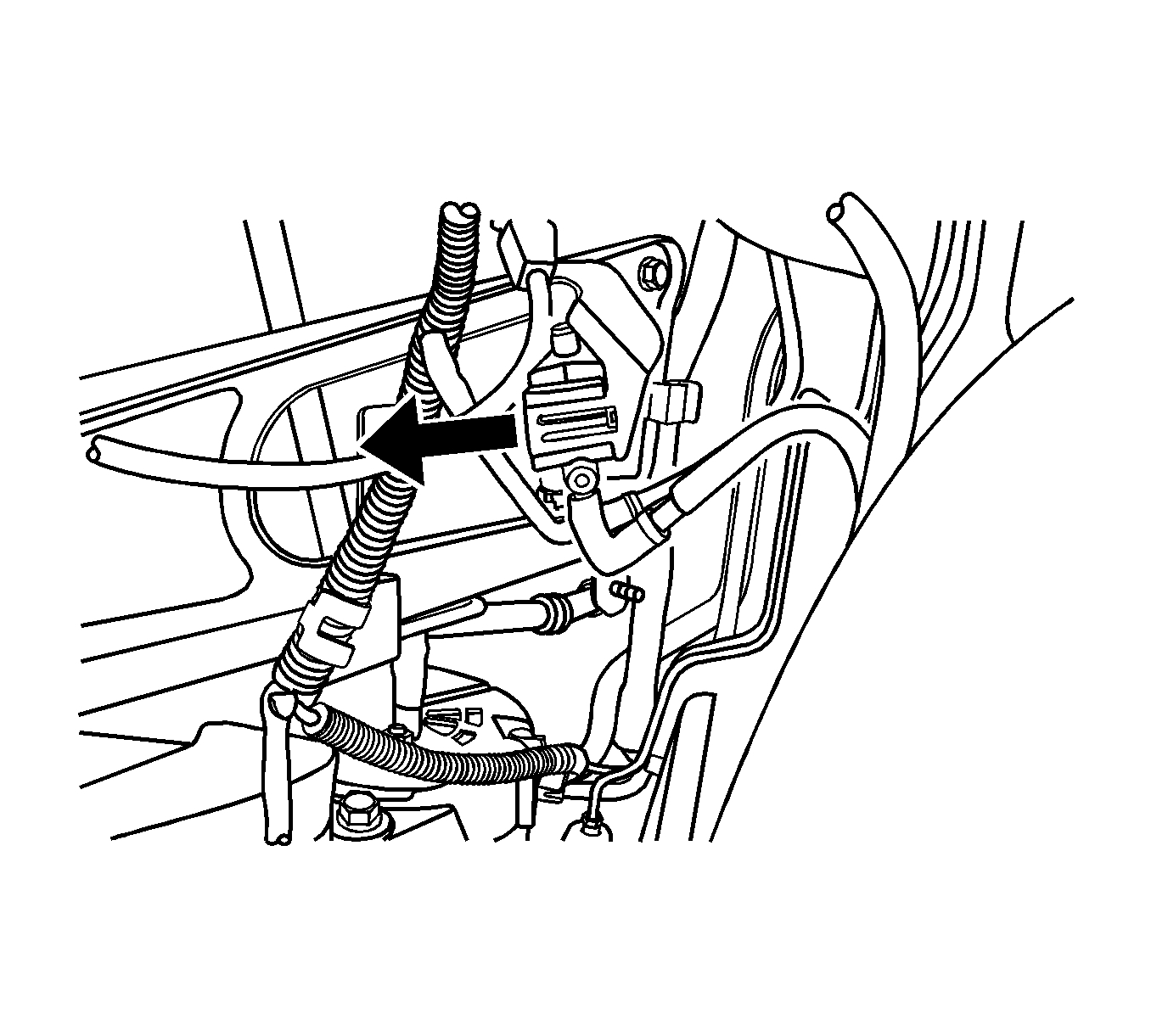

We are pretty sure something went wrong with the upper half of the engine; valves probably. 2 questions.
(1) If it is just valves would you recommend a head job (mill, valves, cams, etc.) or switch out the entire engine? FYI, we are in FL and the car was a NY car. Has some rust obviously.
(2) If we go with switching out the motor, could you confirm the compatible years (we think 2007-2009)?
Thanks,
Jon
Jan 26, 2021 at 1:49 PM
  • 110,194 POSTS
As far as the replacement engine, I would only use the same year, make, and model. They are changing things so often, you may run into trouble.
As far as the cylinder head, it really needs to be removed and inspected to see what happened. Can you tell me if there is noise or another issue that leads you to believe there is a problem with the valves?
If you decide to remove the head, here are the directions. They are a bit extensive but can be done. The attached pics correlate with the directions.

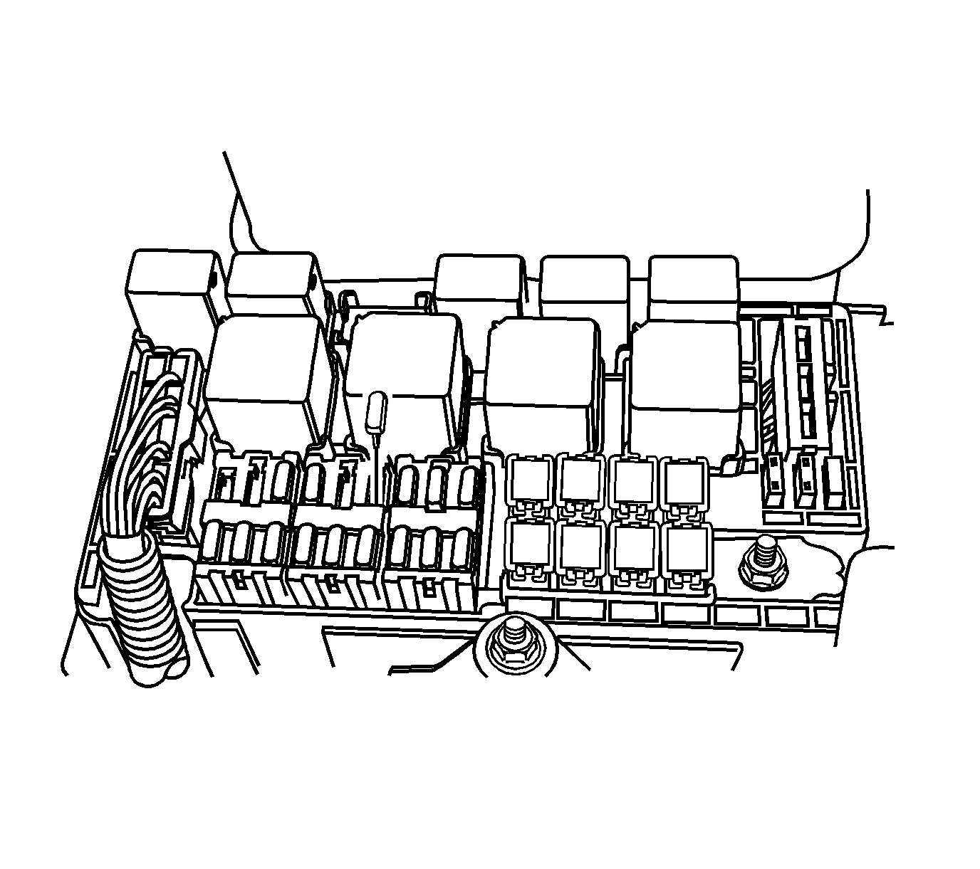

pic 1
Caution: Refer to Safety Glasses Caution.
1. Remove the fuel pump fuse.
2. Start the engine. Crank the engine after the engine stalls for 10 seconds to rid the fuel system of fuel pressure.
3. Drain the engine coolant.

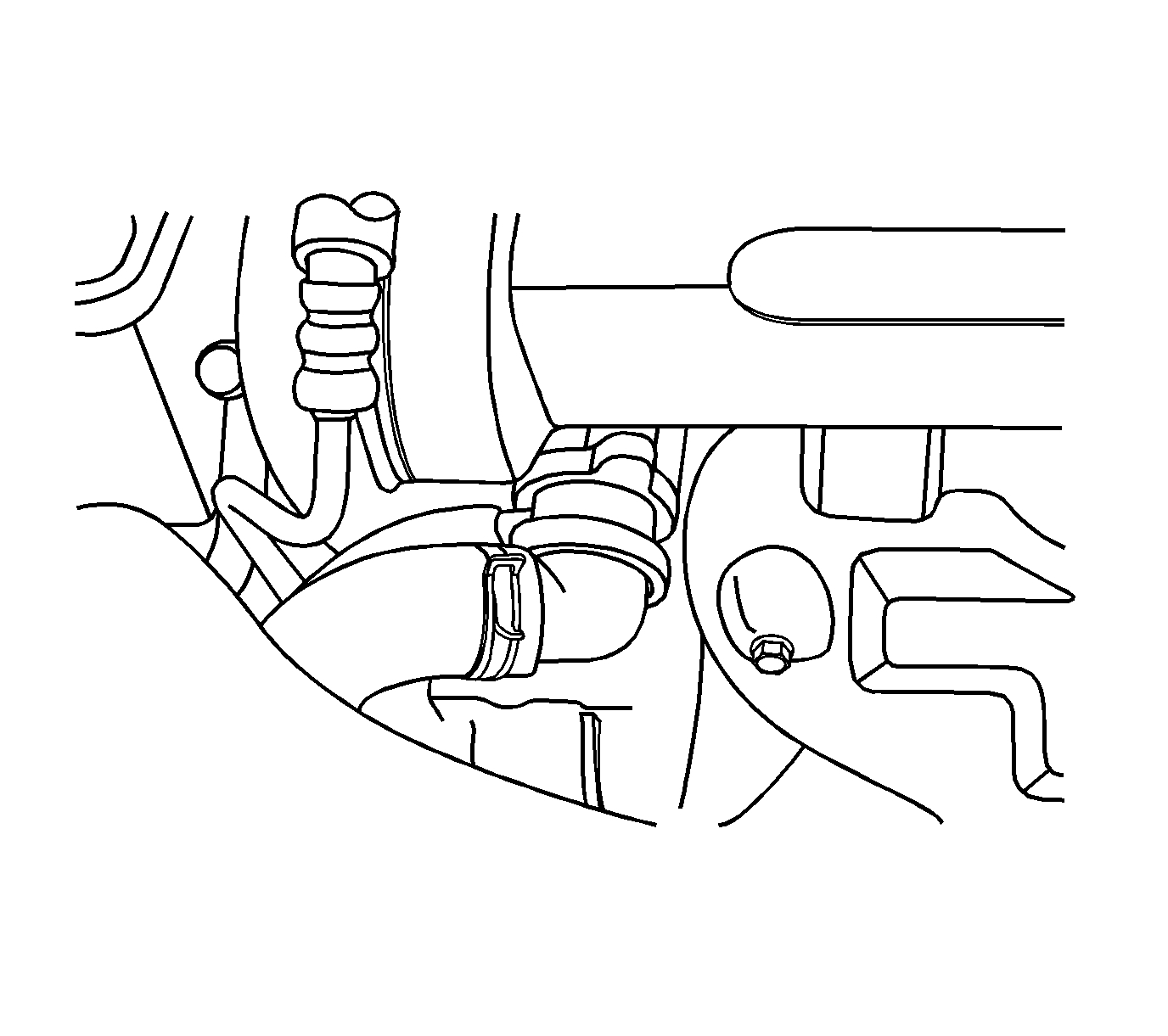

pic 2

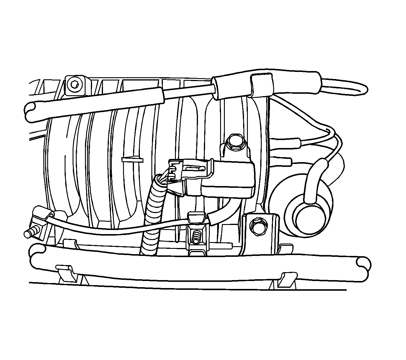

4. Disconnect the breather tube from the valve cover.
5. Disconnect the intake air temperature (IAT) sensor connector.
6. Disconnect the air intake tube from the throttle body.

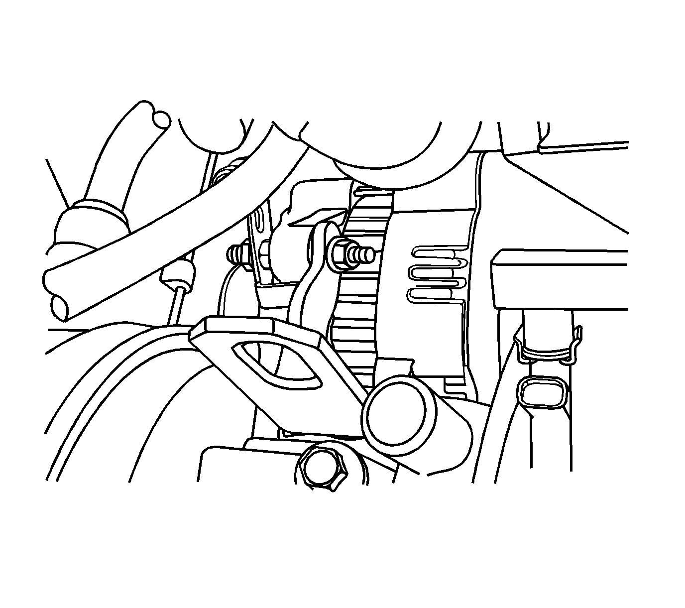

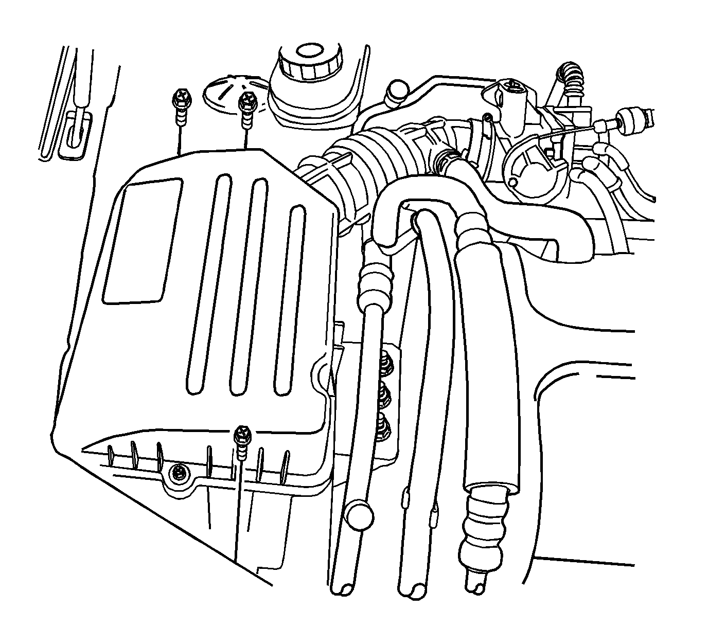

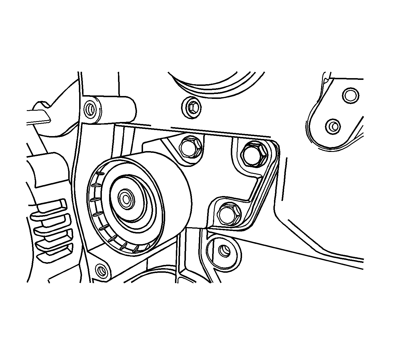

pic 3

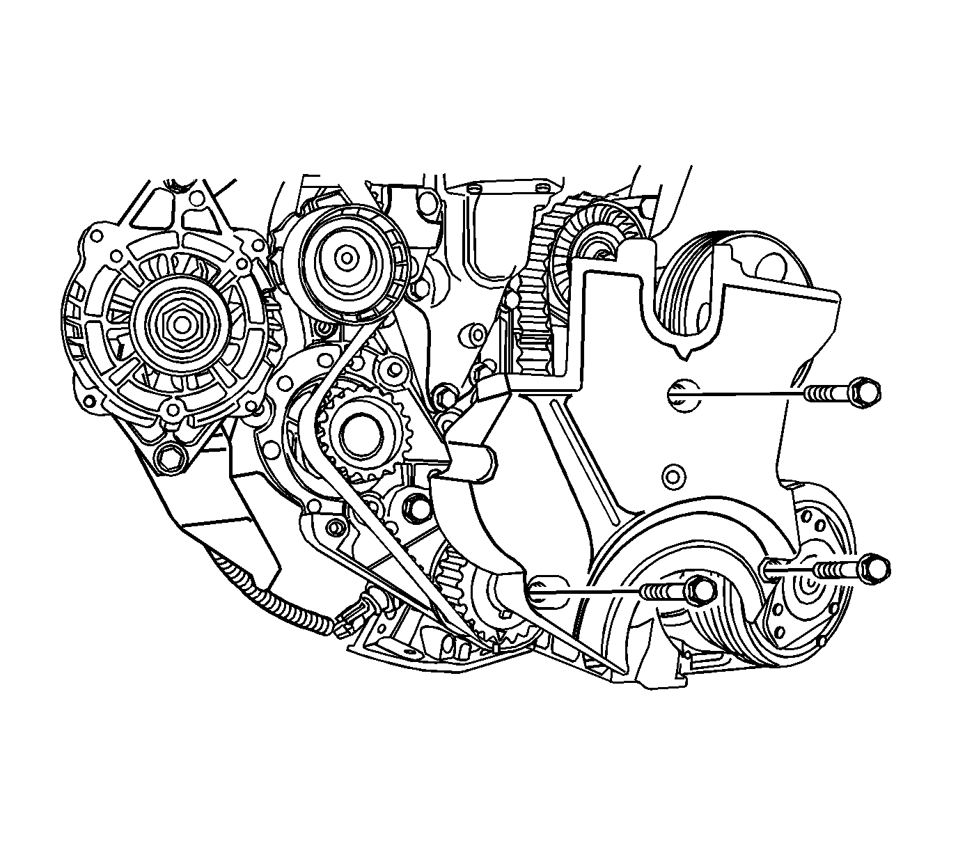

7. Remove the air filter housing bolts.
8. Remove the air filter housing.

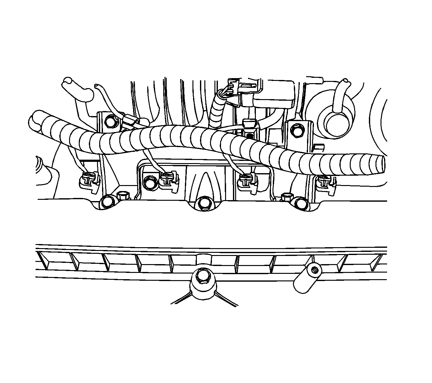

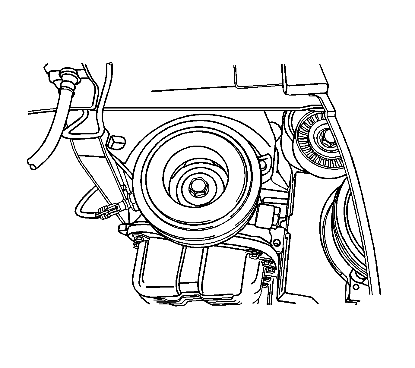

pic 4

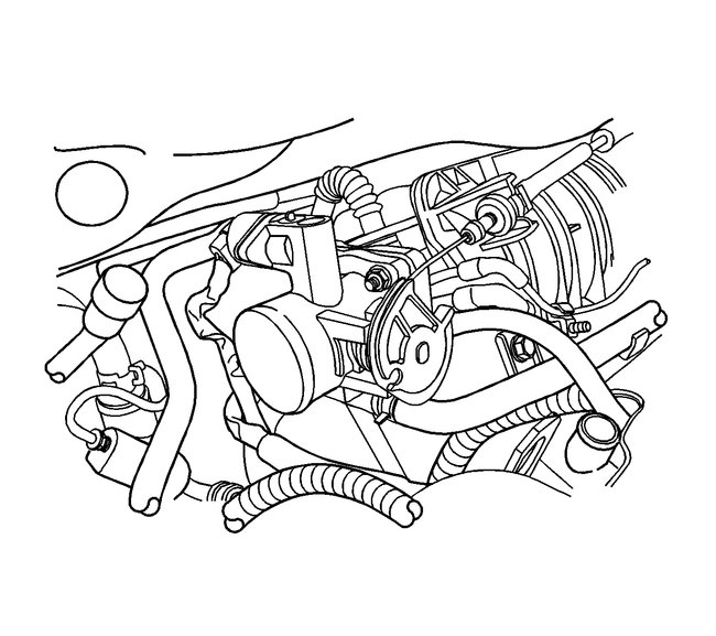

9. Disconnect the A/C pressure (ACP) transducer connector.

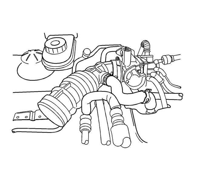

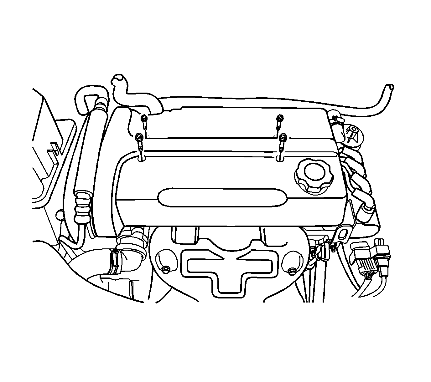

pic 5

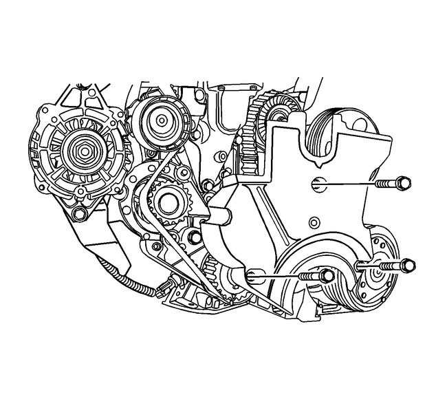

10. Disconnect the idle air control (IAC) valve connector.
11. Disconnect the throttle position (TP) sensor connector.
12. Disconnect the throttle cable from the throttle body and the intake manifold.
13. Disconnect the engine coolant inlet/outlet hose at the throttle body.

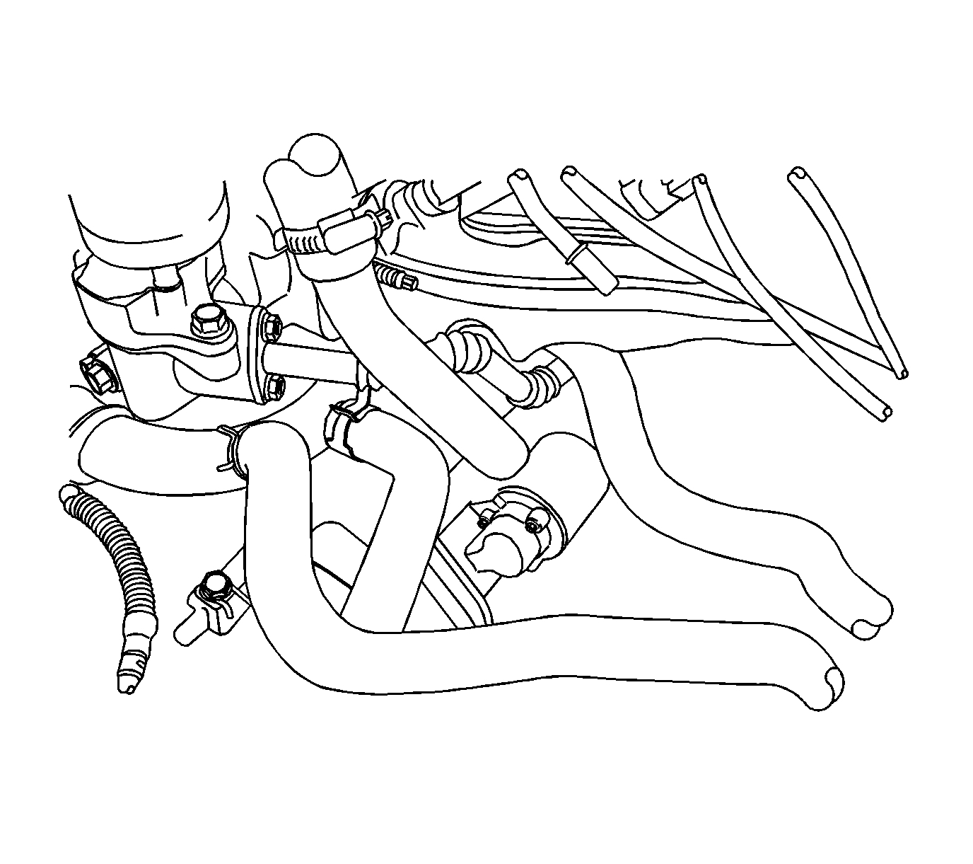

pic 6

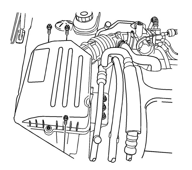

14. Disconnect the manifold absolute pressure (MAP) sensor connector.
15. Disconnect the brake booster vacuum hose.
16. Disconnect the variable geometry induction solenoid (VGIS) connector.
17. Disconnect the VGIS vacuum tank hose.

21. Disconnect the camshaft position (CMP) sensor connector.

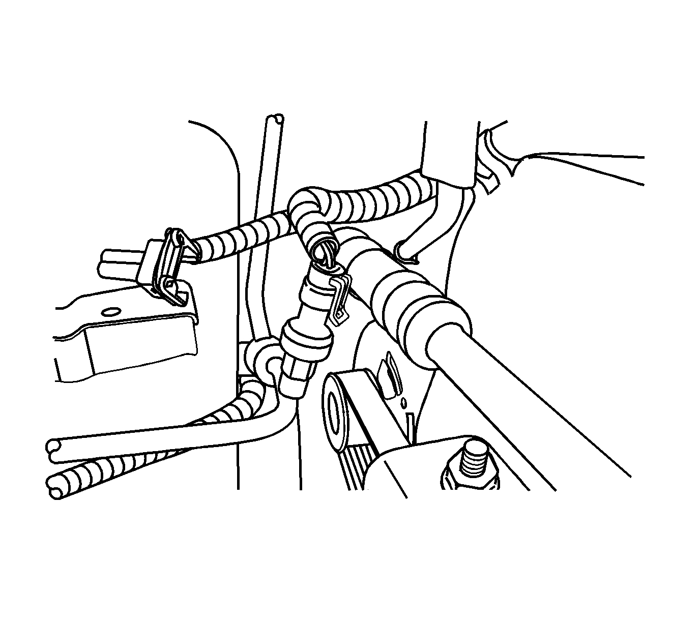

24. Disconnect the fuel line.

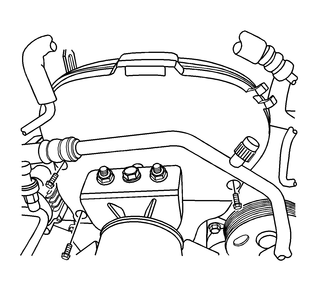

25. Remove the bracket nut from the power steering pressure pipe.
26. Remove the power steering pressure pipe.
27. Remove the alternator adjusting nut.

28. Remove the accessory drive bolt.

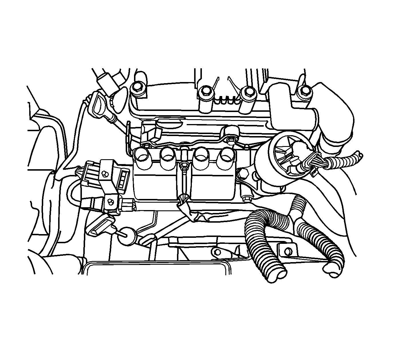

30. Disconnect the ignition coil connector from the electronic ignition (EI) system.
31. Disconnect the front heated oxygen sensor (HO2S) connector.

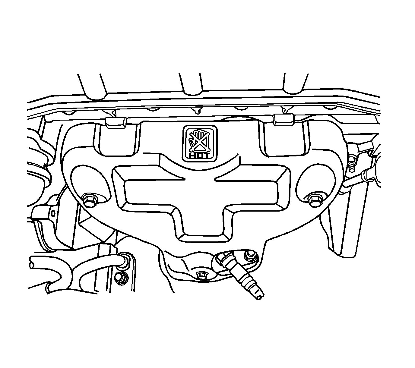

39. Remove the exhaust manifold heat shield bolts.
40. Remove the exhaust manifold heat shield.
41. Remove the catalytic converter.

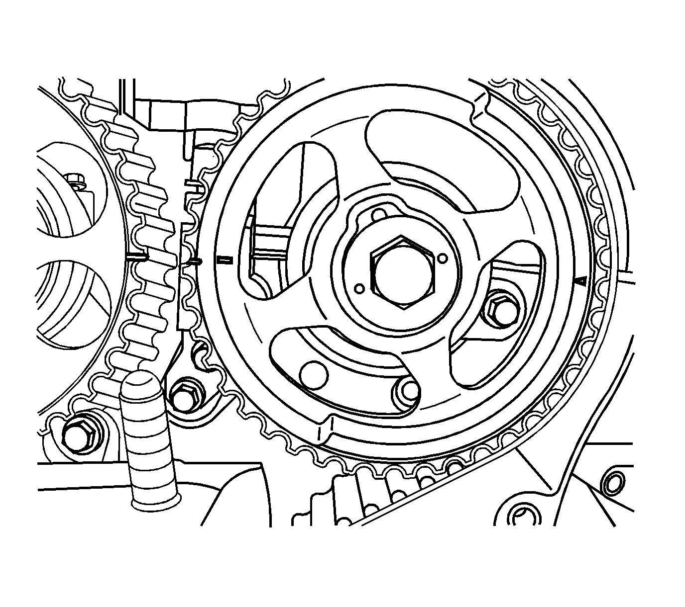

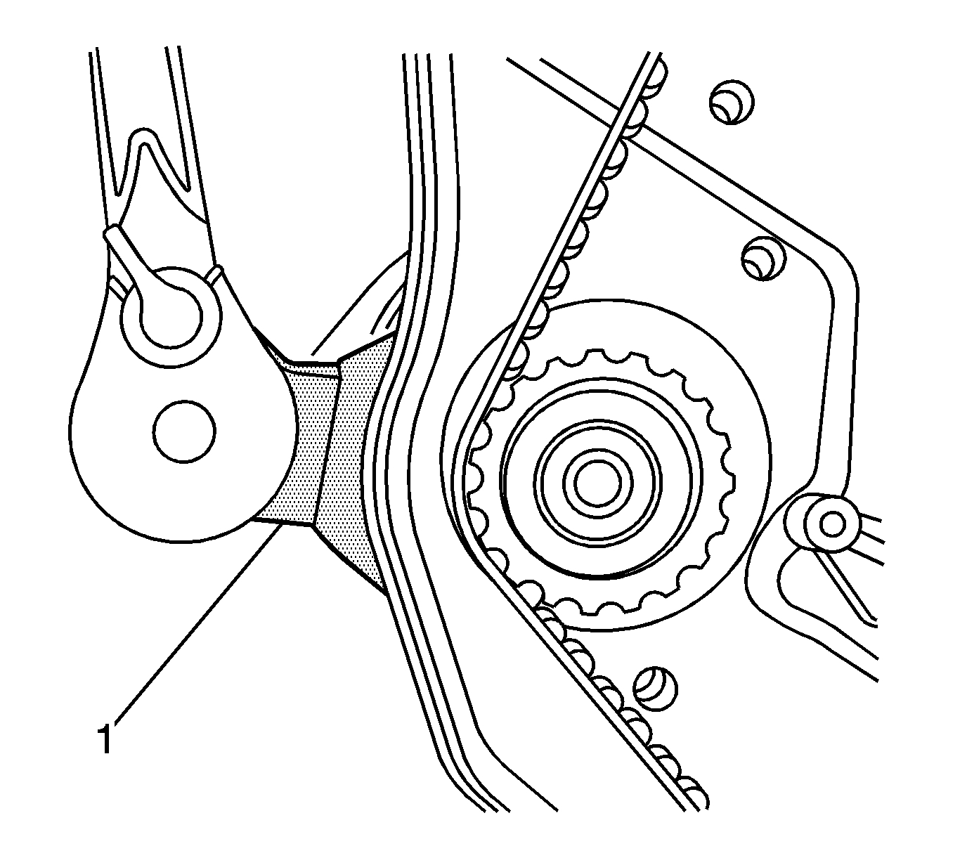

50. Align the camshaft gear timing marks.
pic 20
51. Slightly loosen the coolant pump retaining bolts.
52. Rotate the coolant pump counterclockwise using J 42492-A (1) to relieve the timing belt tension.
53. Remove the timing belt.

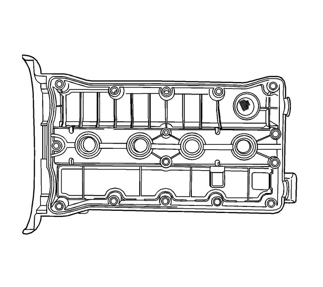

54. Remove the valve cover.

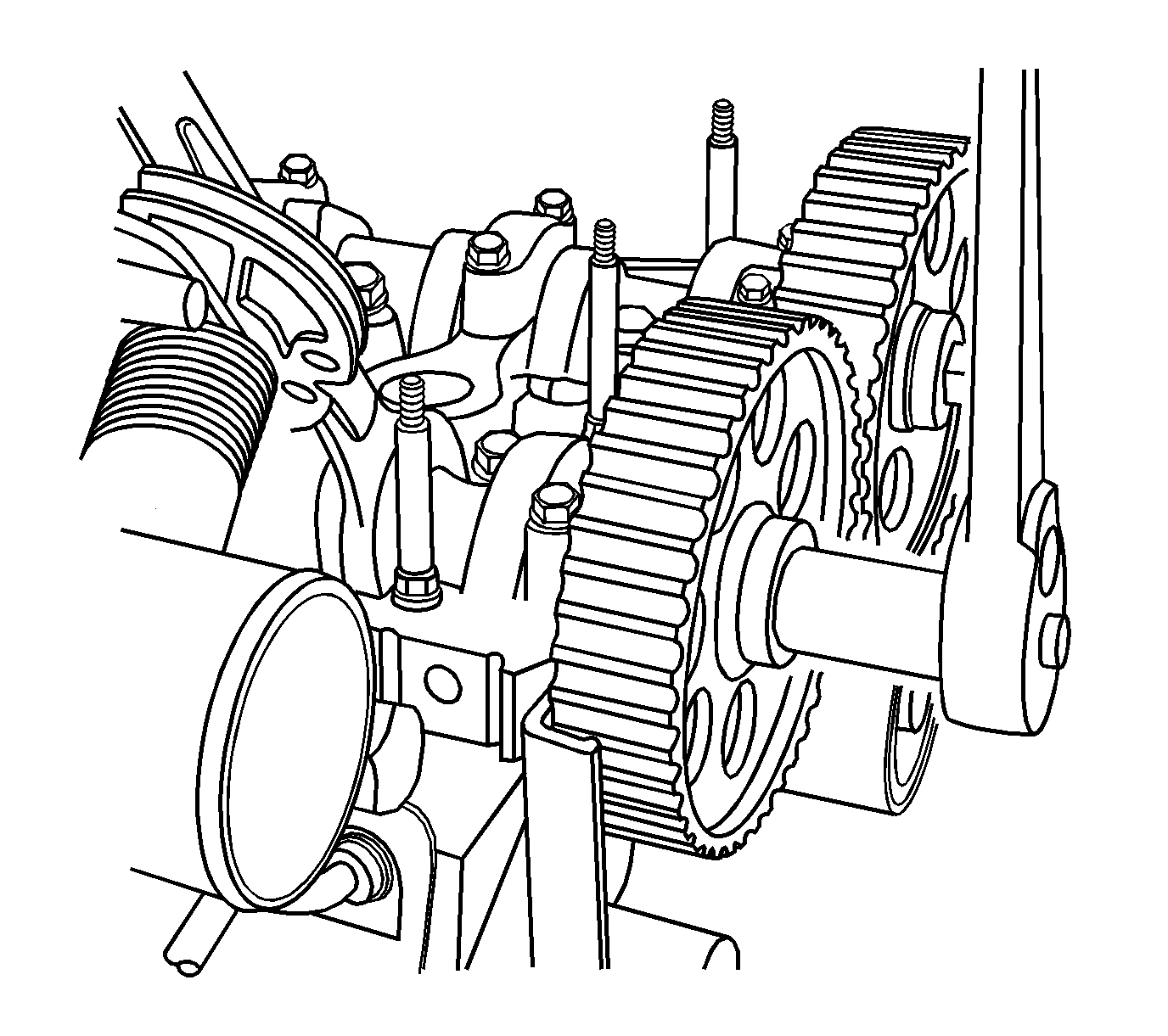

55. While holding the intake camshaft firmly in place, remove the intake camshaft gear bolt.
56. Remove the intake camshaft gear.
57. While holding the exhaust camshaft firmly in place, remove the exhaust camshaft gear bolt.
58. Remove the exhaust camshaft gear.

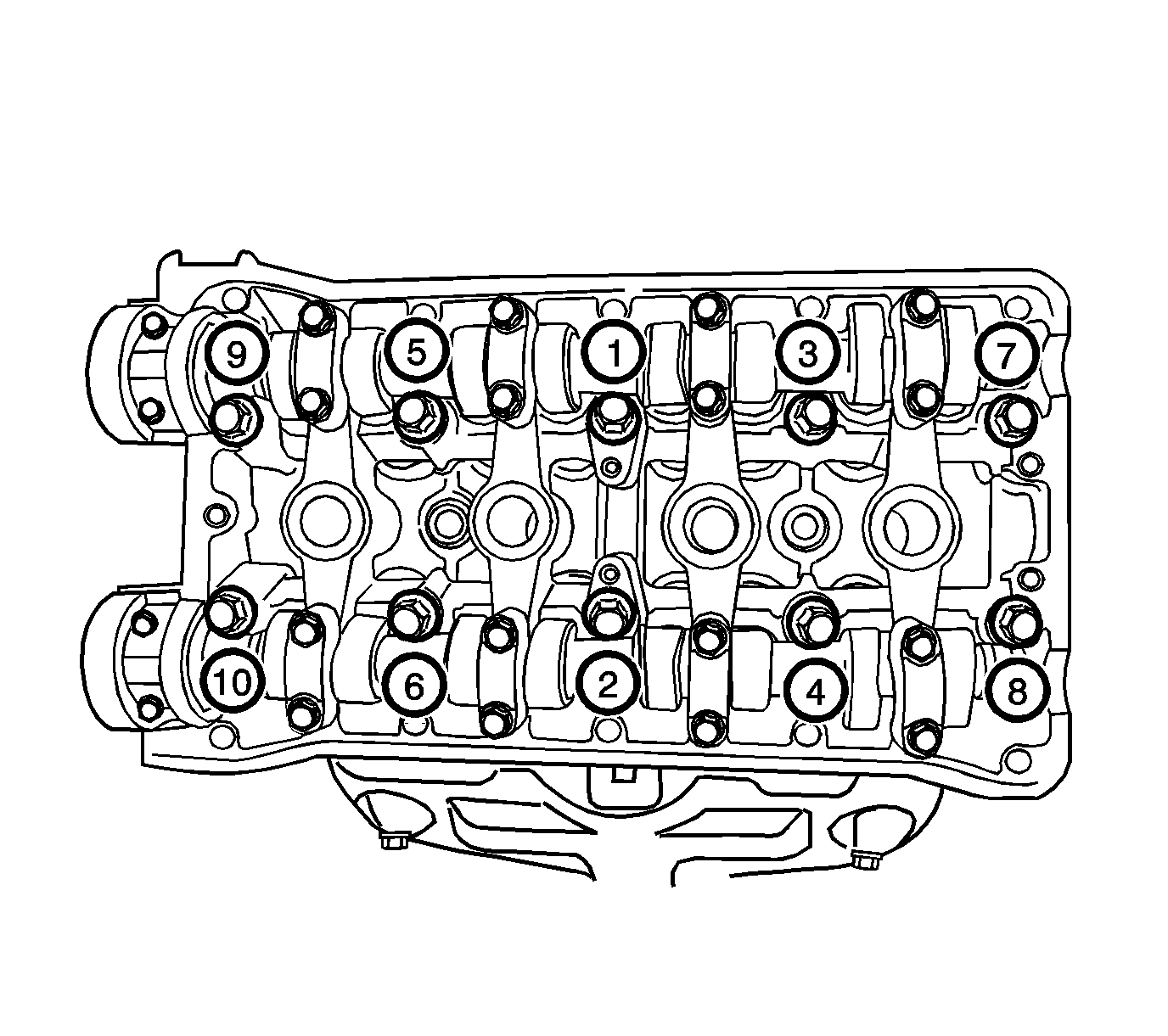

68. Loosen all of the cylinder head bolts gradually and in the sequence shown.
69. Remove the cylinder head bolts.

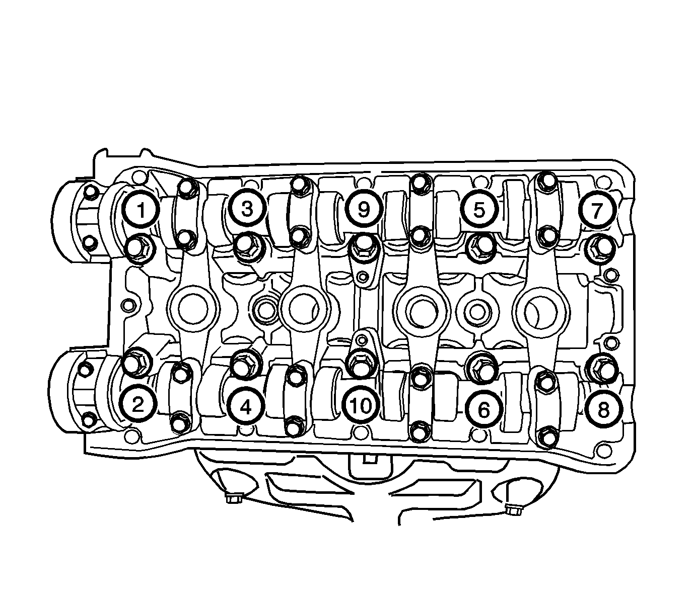

5. Tighten the cylinder head bolts gradually and in the sequence shown.
Tighten the bolts to 25 N.m (18 lb ft). Adjust the bolts to 60 degrees plus 60 degrees plus 60 degrees plus 10 degrees using J 45059 or KM-470-B.

pic 53
61. Connect the A/C pressure transducer connector.
pic 54
62. Install the air filter housing. Install the air filter housing bolts.
Tighten the bolts to 8 N.m (71 lb in).
pic 55
63. Connect the air intake tube to the throttle body.
64. Connect the IAT sensor connector.
65. Connect the breather tube to the valve cover.
66. Install the fuel pump fuse.
67. Connect the negative battery cable.
68. Fill the engine cooling system.
