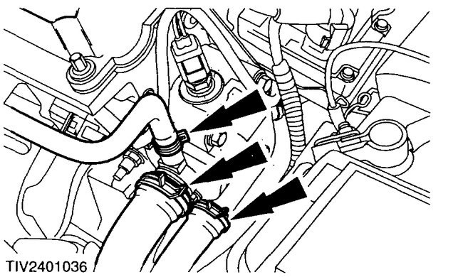

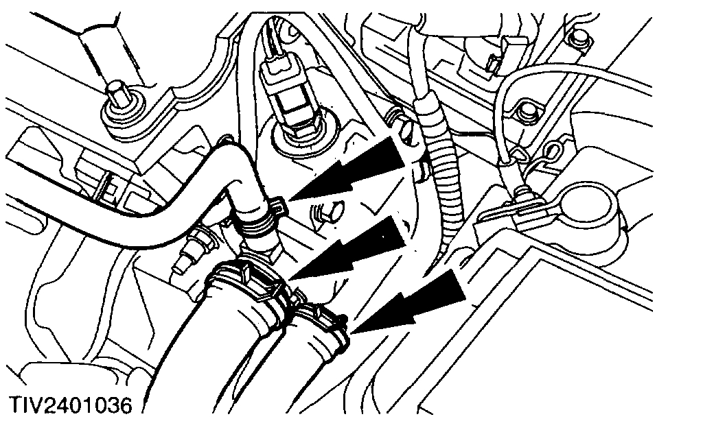

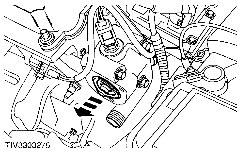

I replaced the thermostat and hose on my car now it's leaking from the housing. I can't afford a new housing unit. Is there any cars that are compatible with the car I have?
Dec 21, 2018 at 2:25 PM
  • 110,194 POSTS
If the thermostat is leaking, chances are it just needs resealed. As far as other vehicles compatibility with your vehicle, you would have to actually look at them to confirm they are the same. It seems like everyone of them are different in some way.
Now, can you tell me where it is leaking from? Is it the hose, where the housing mounts, or is the housing cracked? Also, when you installed the new thermostat, was the housing and where it mounted clean and dry? Are you sure the thermostat was properly positioned prior to installing the housing? Was the gasket/o-ring in good condition?
Here is a link that shows how in general one is replaced. Make sure you followed these directions.
Here are the directions specific to your vehicle for replacement. Read through them to confirm you did everything it shows. The attached pictures correlate with these directions.
______________________________

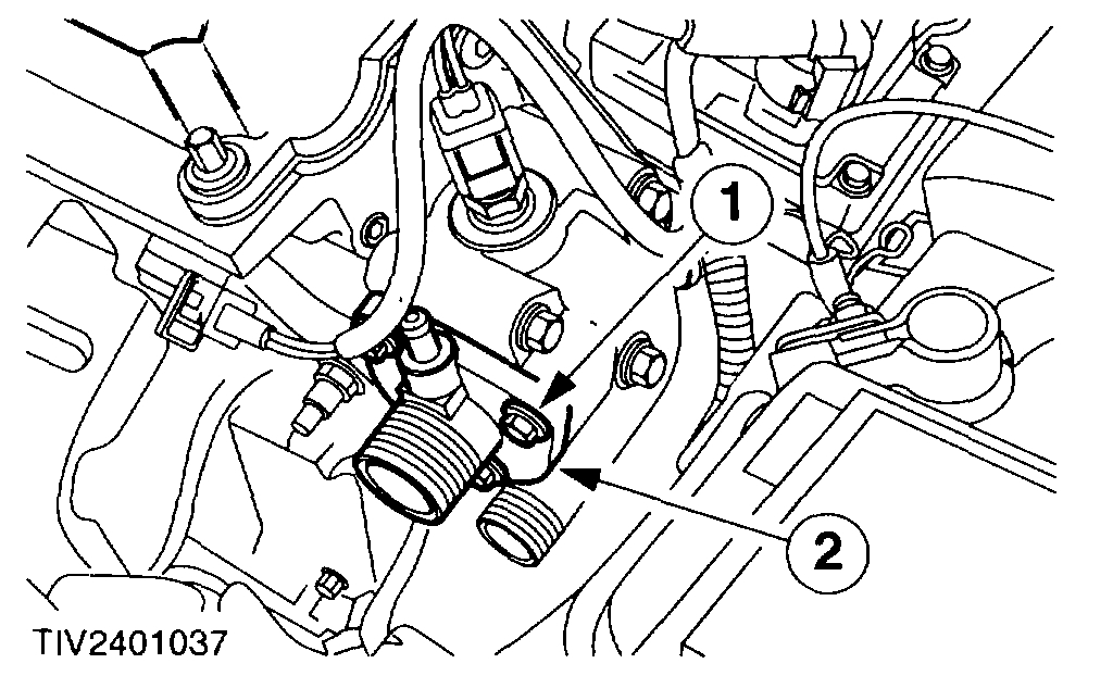

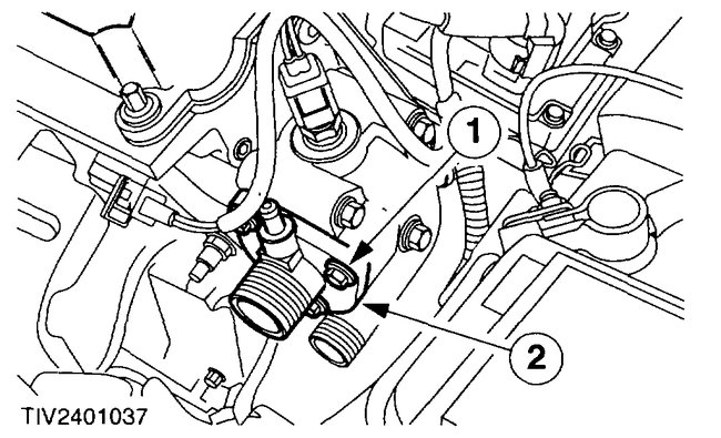

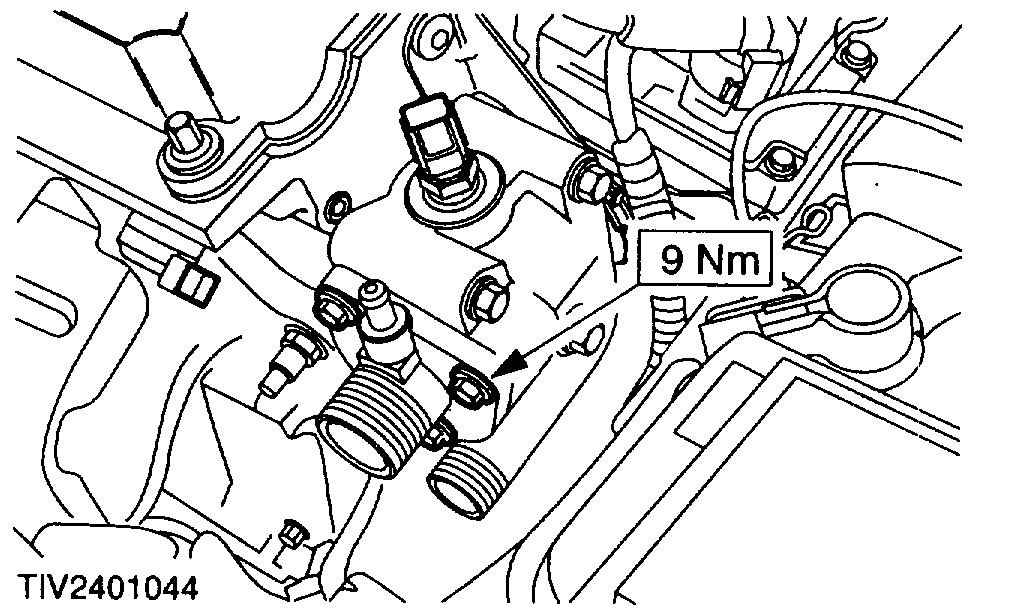

PROCEDURES
Removal
1. Drain the cooling system.
2. Disconnect the thermostat hoses.
3. Remove the thermostat cover.
1 Remove the three bolts.
2 Remove the cover.
4. Remove the thermostat.
Installation
1. To install, reverse the removal procedure.
2. Refill the cooling system.
Let me know. If you plan to get one from another vehicle, it will have to be the same model year, engine, and then you would have to confirm it is the same.
Let me know if this helps.

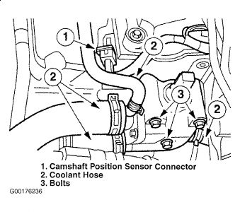

BMRFIXIT
  • 19,053 POSTS
https://images.2carpros.com/forum/automotive_pictures/99387_Graphic1_532.jpg
Disconnect the camshaft position sensor electrical connector. Disconnect the coolant hoses and position to one side. Unscrew (3)bolts and remove the thermostat housing

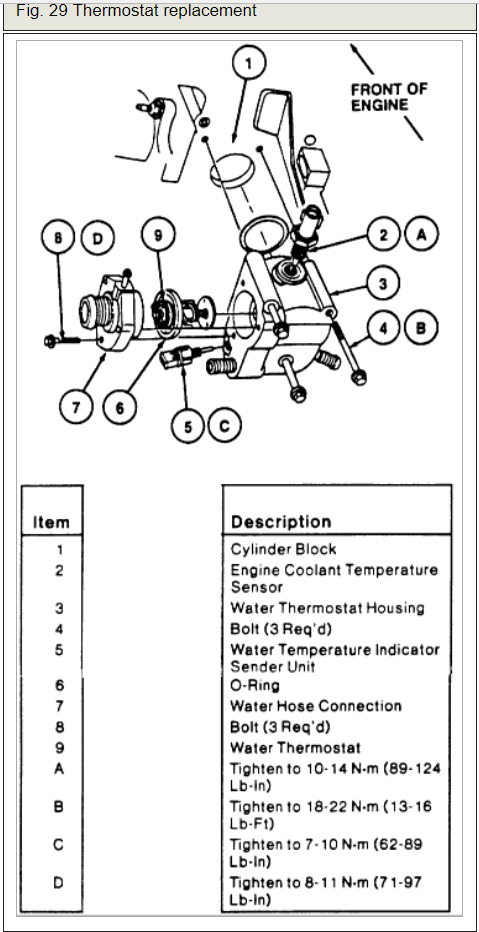

where is thermostat located, how difficult to change?
Feb 9, 2021 at 12:22 PM (Merged)

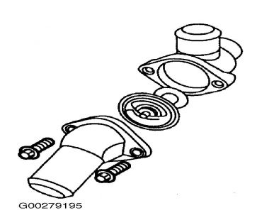

BMRFIXIT
  • 19,053 POSTS
V6 2.5Lengine disconnect battery ground terminal drain coolant system remove air cleaner remove engine plastic cover disconnect hoses remove thermostat housing remove the two bolts separate the hosing remove and replace thermostat

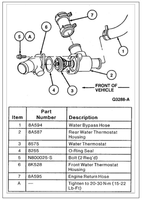

i was wanting to know how to change the thermostat on the ford contour its a 1995 model can you please help me
Feb 9, 2021 at 12:24 PM (Merged)

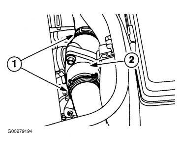

BLUELIGHTNIN6
  • 16,542 POSTS
Here is a guide to help you see what you are in for when doing the job.
Check out the diagrams (Below) both engines
Cheers
