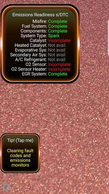

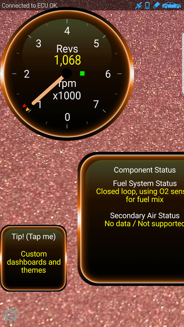

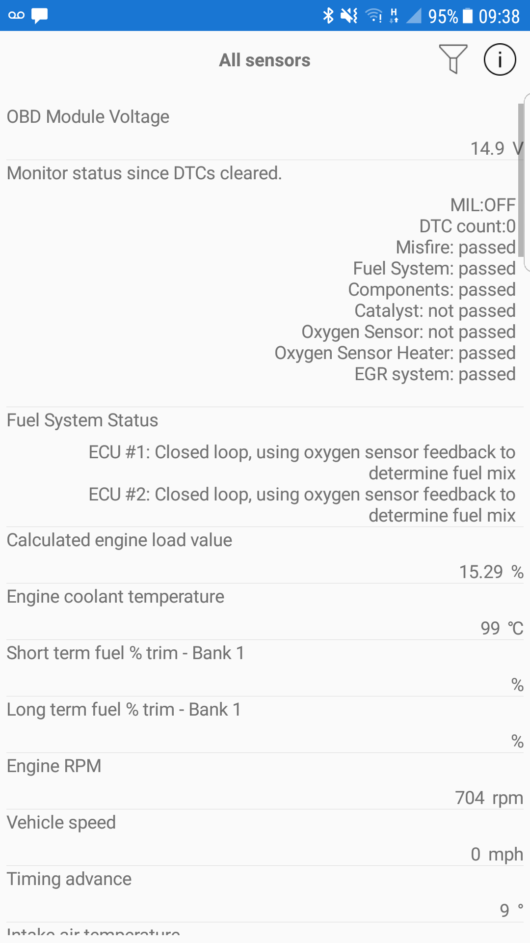

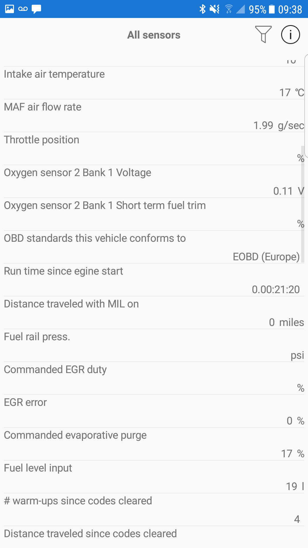

I have attached a few images of readings that i took using OBD scanner on a cold start.
Could there be a 02 sensor fault on cold start causing misfire?
Coolant level seems to be fine so does vacuum operating gauge. Can i rule out vacuum leak?? and CTS seems fine as well as it is reading correct temperature but my car does not blow hot air. Any suggestions?

Hi and welcome back:
The idea that it is working in a closed loop is normal at start up. I noticed that the O2 sensors are incomplete. Basically, that means the codes have been cleared and the system has not completed a drive cycle (driven far enough) to reset that portion of the emissions readiness.
If you can, send me pictures of the STFT (short term fuel trims) and LTFT from the scanner. I may have a better idea of a vacuum leak with that. Also, you could still have a vacuum leak regardless. I'm not sure why you have no heat. It could be a plugged heater core or even a blend air door issue. If the blend air door isn't working and IF it is actuated by engine vacuum, that may be both the vacuum leak and the heater problem.

My scanner fails to pick up STFT and LTFT.
