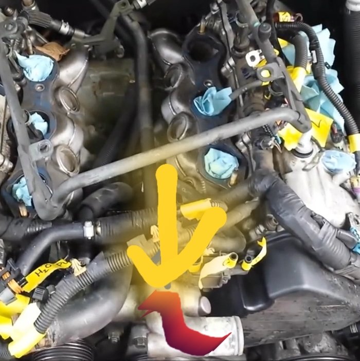

Do you guys know the name of this part?
Feb 15, 2020 at 12:17 PM
JIS001
  • 3,412 POSTS

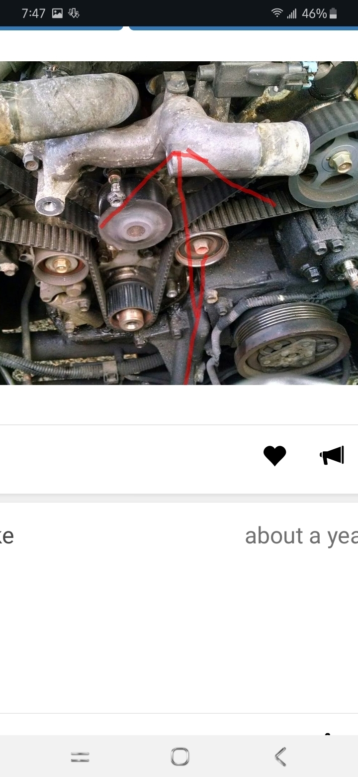

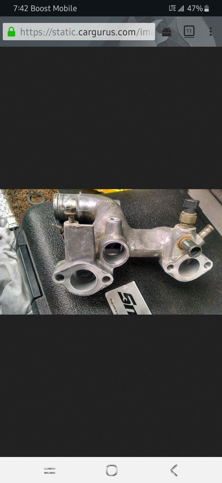

The second image is the water outlet. You looking to replace that or for gaskets?
Feb 15, 2020 at 1:08 PM
ANGEL0324
  • 26 POSTS

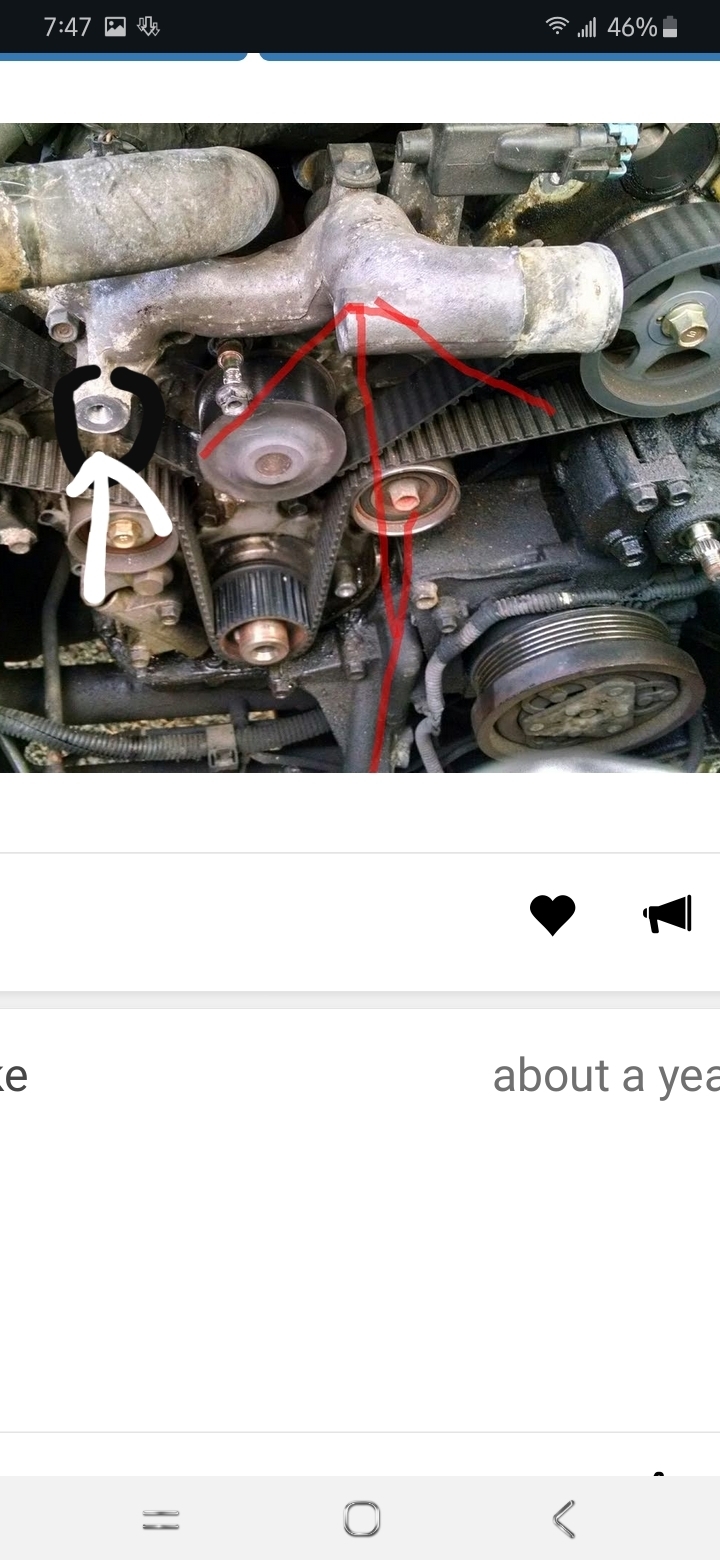

I need the assembly because the threads of the pulley bolt are broken.
Feb 15, 2020 at 1:11 PM
JIS001
  • 3,412 POSTS
Which pulley bolt?
Feb 15, 2020 at 1:17 PM
ANGEL0324
  • 26 POSTS
The idler pulley.
Feb 15, 2020 at 1:21 PM
JIS001
  • 3,412 POSTS
Okay, I think I see it now on the white arrow. That is the water outlet pipe.
Feb 15, 2020 at 2:03 PM
ANGEL0324
  • 26 POSTS
Yes, I have to replace that, right?
Feb 15, 2020 at 2:18 PM
JIS001
  • 3,412 POSTS
If that is where the pulley goes then yes.
Feb 15, 2020 at 2:53 PM
STEVE W.
  • 15,344 POSTS
If you mean the threads in the hole are stripped it is possible to repair that part using a thread repair kit like a heli-coil or a threadsert type insert. A heli-coil would likely be the easier of the two as it would remove less of the material.
