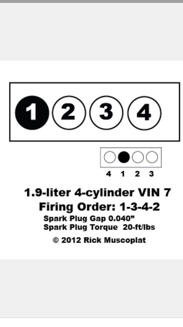

I am getting a code that says #4 cylinder is misfiring. My question is, how do I know what plug wire goes where? In other words, the firing order for the coil is 4123. What cylinder does #4 go to, #1, #2, #3 from the coil to the cylinder(plugs).

Maybe this diagram will help you. The engine block of course is the big one and the small one is your coil

3 rhings, make sure you got the wires going to the right coil spots, check compression on the cylinders especially number 4, check to see if you getting power to the injector number 4 with a test noid. I wouldn't drive it a lot if it's missing

The diagram I sent earlier go by that to make sure the wires are located in the right spot. The rest you need special tools like compression gage, and some noid testers to, check power for injectors
