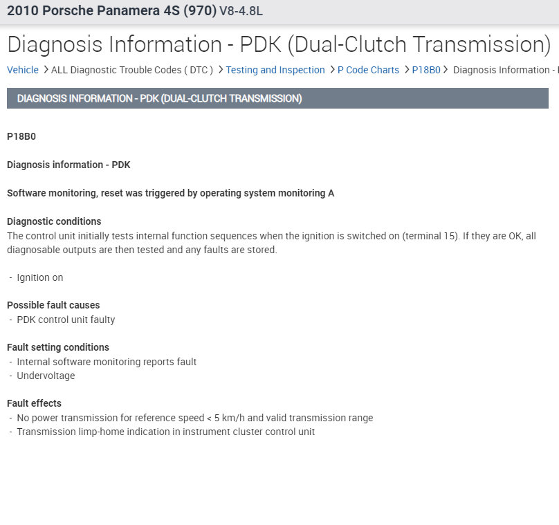

Can you find out what these codes refer to?
Also, the battery is weak in the car, not sure if it has anything to do with it.
Jan 2, 2022 at 3:28 PM
SQM
  • 6,383 POSTS
The code P18B0 is due to an issue with the PDK (dual clutch transmission) control module.
Typically, the issue points to a faulty module.
The U0456 refers to fault within the air conditioner control module. Most of the time this does not affect functionality.
What type of issues are you experiencing?
The weak battery should be due to these codes. It could just be old or have bad cell(s).
Have you done a load test on it?
I have attached the diagnostics for the P18B0 below.

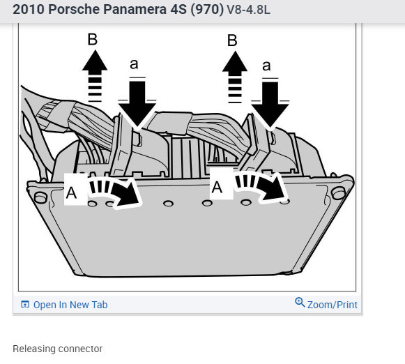

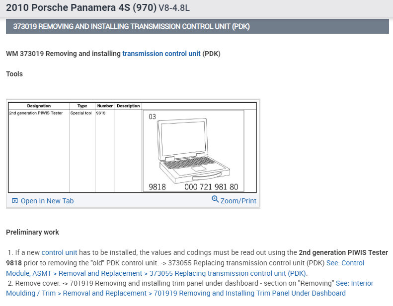

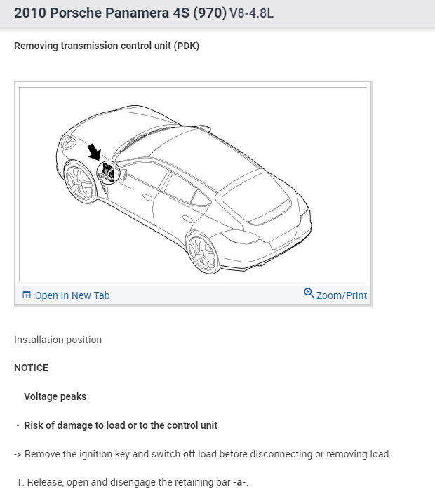

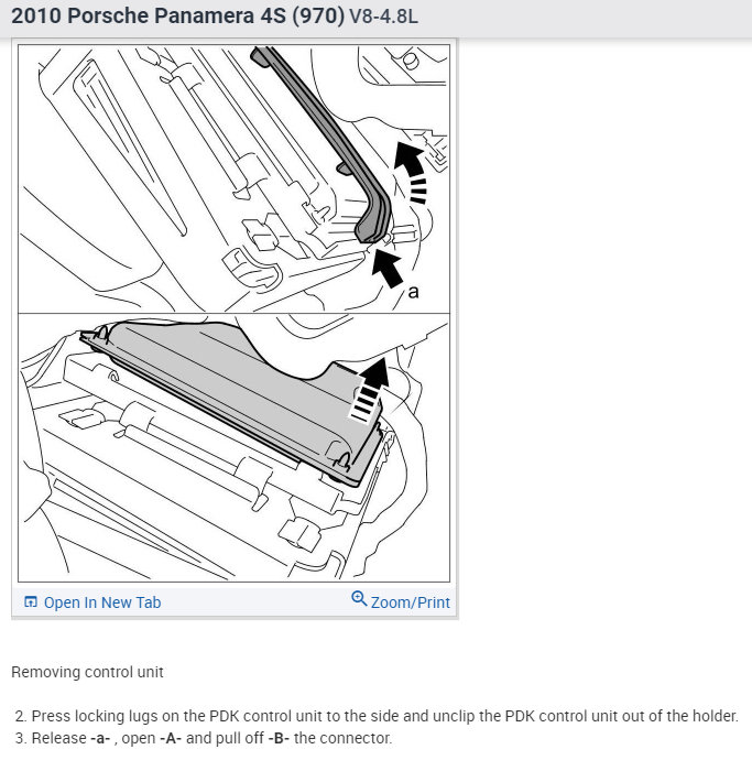

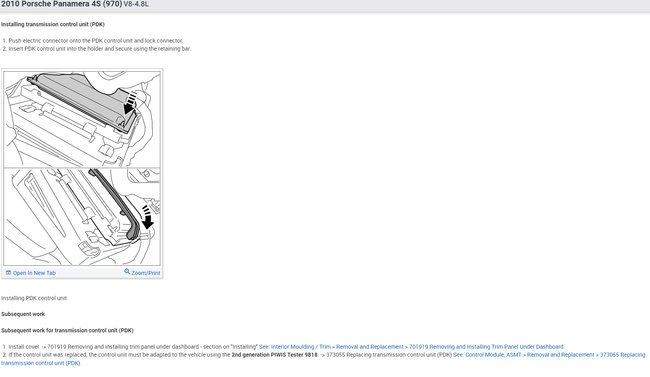

Where is the PDKs control unit by the way?
Jan 3, 2022 at 7:24 AM
SQM
  • 6,383 POSTS
That control unit is located under the dash on the driver side. I have attached diagrams below.
