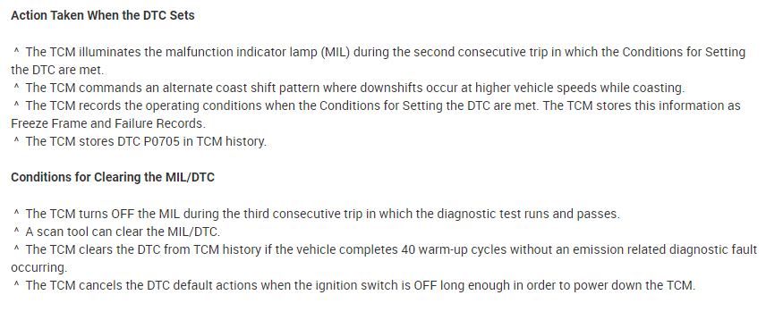

I know my quick fix isn't the answer, but I need your advice
Day #1 - Car went crazy locks up and down, rough shifting, power steering warning light, engine light on. Research online showed it's a common problem and my OBDII code reader showed P1682. Quick fix attempt worked well by grounding the TCM itself to the car frame. No more code P1682 so I cleared all codes with my reader.
Day #2 - Engine light comes back on. Code P0705 now appears.
One other thing (don't know if it's related) all of a sudden, my shifter locks in park and won't release when pushing in the shifter button. Instead, I hear a clicking sound coming from the steering Column. Also when I step on the brake, I hear a clicking sound coming from the shifter itself.
Help ! Thanks in advance.

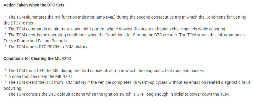

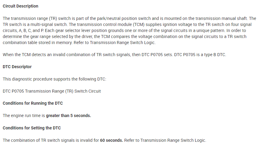

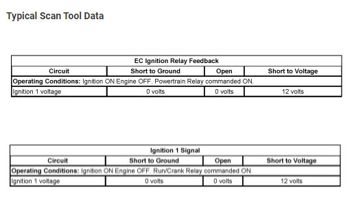

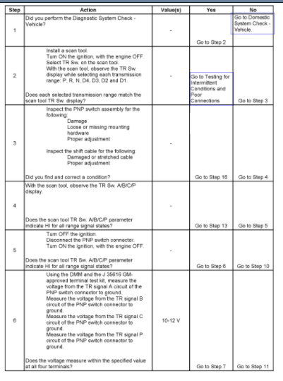

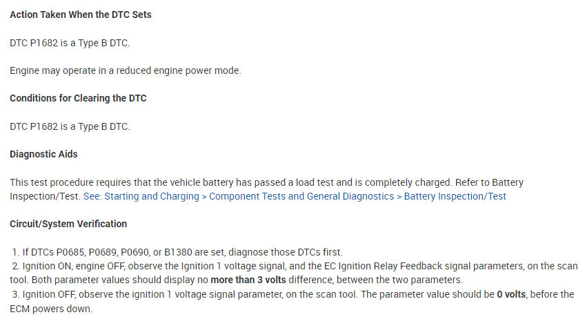

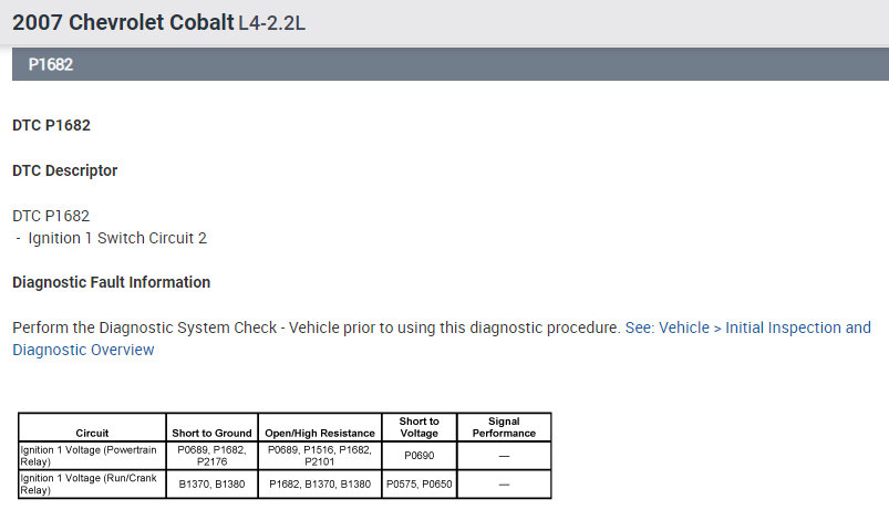

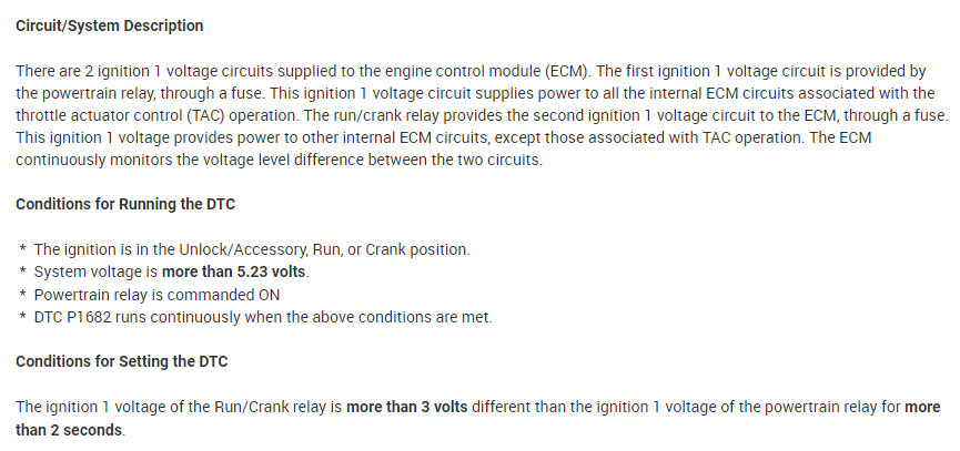

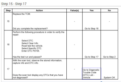

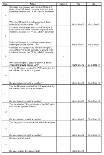

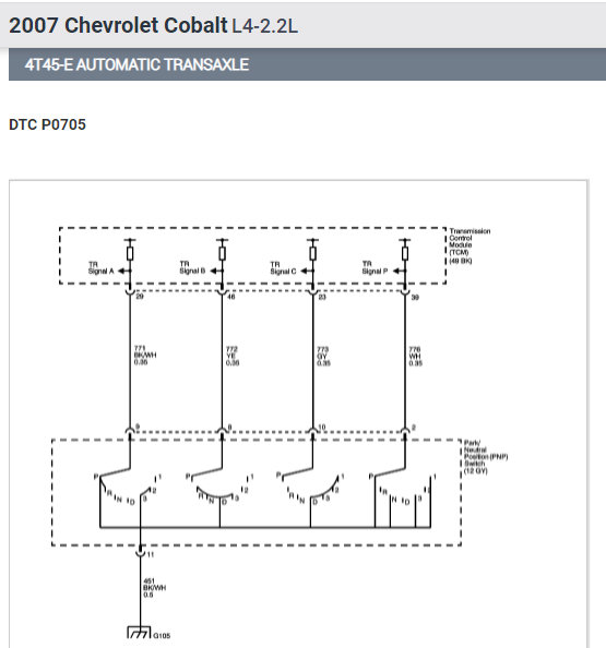

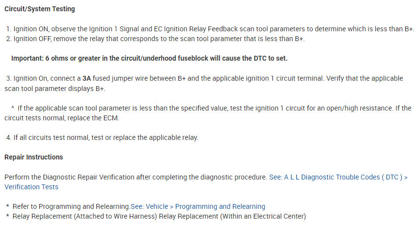

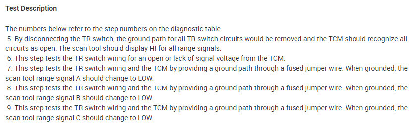

I've attached below the code information for both code P1682 and P0705. Code P1682 has to do with ignition voltage being supplied to the ECM-engine control module via a fuse controlling the throttle actuator control operation. Code P0705 has to deal with the transmission range selector and shifter operation. I've attached the code information below with picture diagnostic flowchart steps for your car. Get back to us with anything you find and we'll go from there. Hope this helps and thanks for using 2CarPros.
