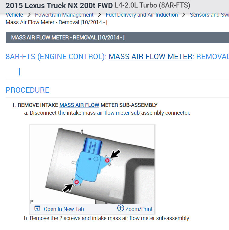

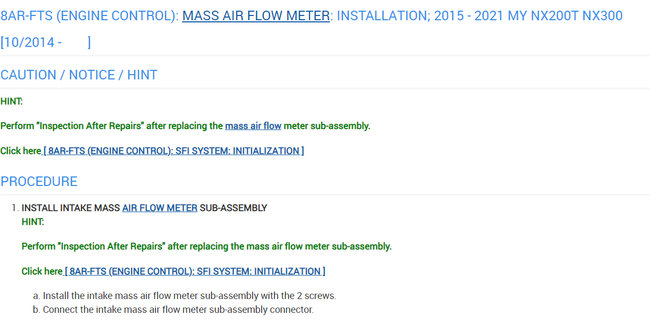

P219C - Bank 1 Air/Fuel Ratio Imbalance: This code suggests that there is an imbalance in the air/fuel mixture in bank 1 of the engine.
So, I would check for vacuum leaks and try servicing the MAF sensor but if cleaning it does not work, I would replace it with a new unit. Use this guide when the engine is cold only:
and
https://www.2carpros.com/articles/mass-air-flow-service
Here is the location of the MAF sensor below.
There is no TSB for valve guides.
