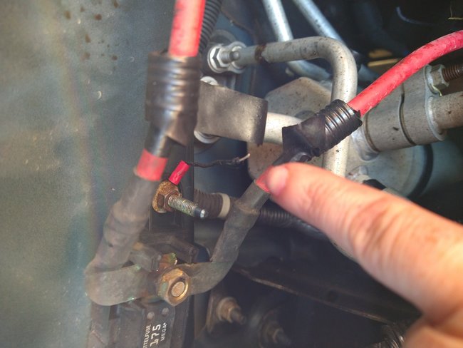

Vehicle pulling p0700 and u0073, warning lights illuminating, trac control stops working and RPM's wig out bad. it acts like it wants to shut off. also not sure what this wire is, i included a pic. but it looks like it broke. not sure what it is or if it's supposed to be connected.

Sorry for some reason it wont let me upload, but the wire in talking about is a small wire coming off of the bolt on the side on the 175 fuse located on firewire.

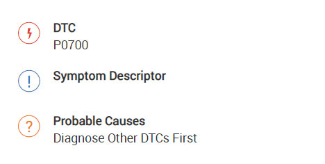

Good evening,
The 700 is a general code for the transmission indicating there are other codes. The 73 is a communication issue.

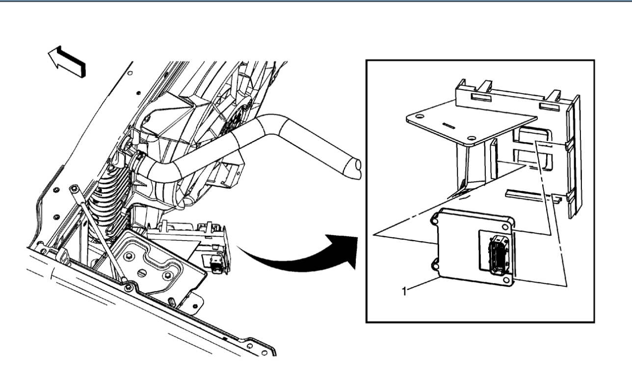

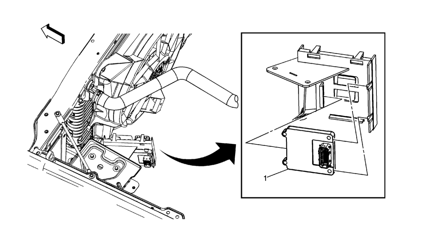

Can you communicate with the transmission control module. The most common issue is dirty connections at the connectors for the module. I posted the location of the module for you below.

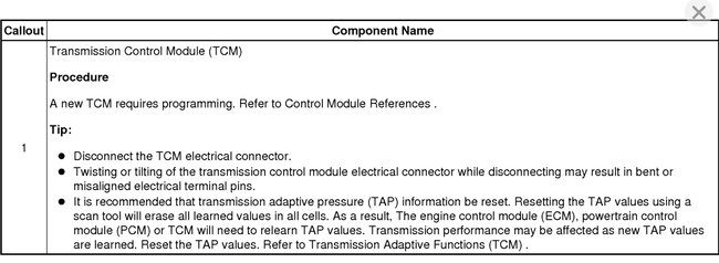

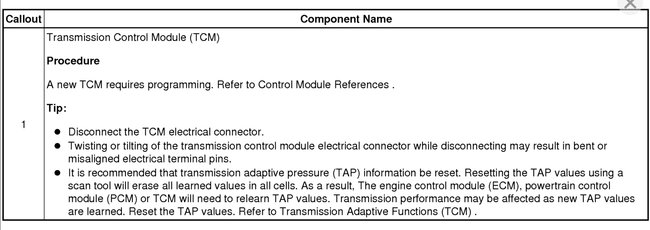

You would have to call around and see if they will rent one.

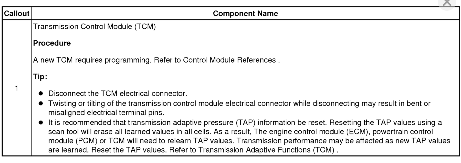

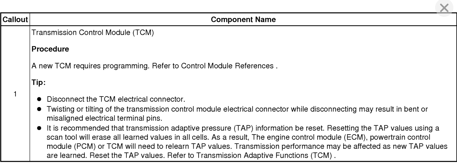

The TCM is an expensive guess since you need to buy a new one and have it flashed or programmed to your car.
I attached the location and procedure for you below.

I'm on my way to Pick-N-Pull now. I'm going to try to get one from there since it'll be a lot cheaper. so that's where I'm headed. there's two different things I've read one is that it's up in the engine compartment and the other is that it's in the back in the transmission case which one is it? It's up in the front of the engine bay right correct? and I've gotten one from Pick-n-Pull before and the third one that I got actually fixed my problem on my Mazda it wouldn't even like move when I had to come to a dead stop trying to accelerate again was difficult and replacing the TCM fixed that issue. the third one that I got was a good one from Pick-n-Pull and so I didn't have that problem anymore. but with that one I really didn't have to reflash or program anything. I just put it in and then it learned itself. again I thought that would be the same situation here from what I understood and I'm sorry if this is so long but I'm using talk to text while I'm driving. but if you could let me know I would greatly appreciate it, thanks.

You are taking a chance with a junkyard unit. It still has to be programmed to you VIN number for it to function.
It is where the picture I sent you. It is under the battery in the engine compartment.
I would have someone with a scan tool check and see if the TCM is working first.

Okay, i just drove it myself and got a little better of a idea of what exactly it's doing. i don't know l if it will make a difference or if you will be able to give me an idea without better scanner because i don't halve access to one or money for one at the exact moment. but the stabitrac off comes up then and only then the RPM's will repeatedly drop then come back up pretty fast .t feels likes its stuck in a lower gear when this happens. also i was able to include al pic of the wire that i'm not sure what or if it should be connected or grounded or what? If you know. Thanks

Somebody added that wire to that stud. That is not factory at all.
