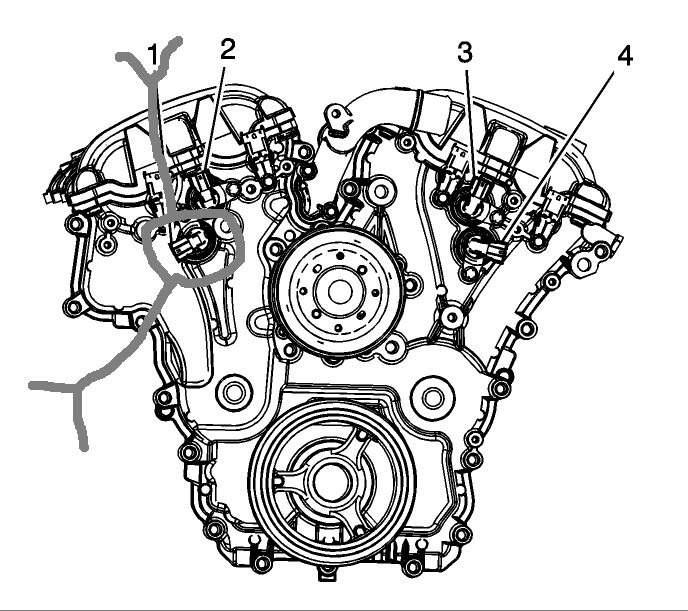

Where is the location of camshaft sensor?
Apr 6, 2018 at 3:25 AM

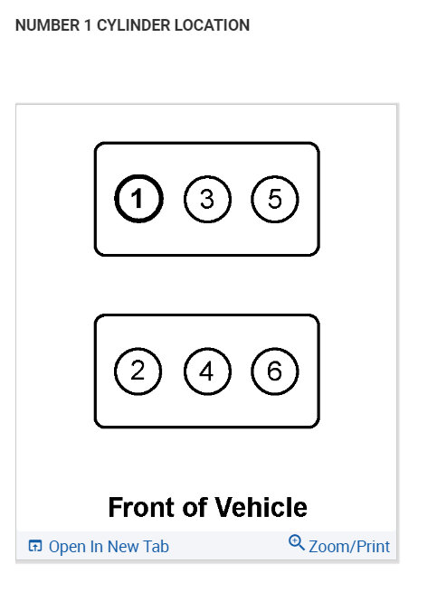

I attached a picture of the location of both sensors. there are two. the one for this code is bank 2 sensor. Bank 1 closest to the fire wall. They are number one and four in the diagram. Check out the images (Below). Please let us know if you need anything else to get the problem fixed.

The 11 code is the intake cam sensor.
the fact that there are cam sensor codes, verify there is 5 volts to the sensor connectors. if there is, check the connectors. if they are good, it is possible the sensors are bad but the possibility of a timing issue is strong between the cams and the crank

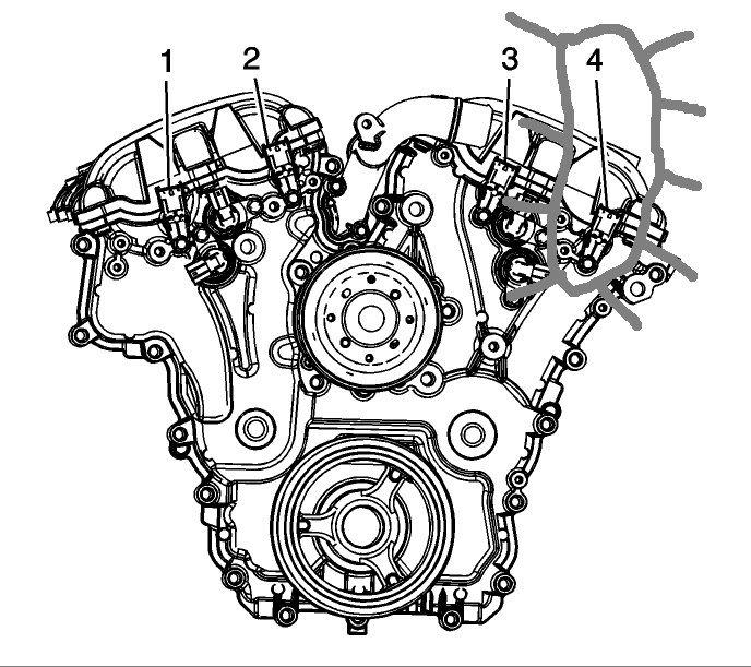

The first code indicates an issue with the exhaust camshaft sensor on bank 2 while the other refers to the intake cam timing on the opposite head. First thing I would do is look for damaged wiring as both of those could be caused by shorted wires. The first code because the sensor signal is wrong (either shorted to power or ground) and the other code could be caused if the VVT solenoid is being commanded fully open from being shorted to the same power feed that is causing the bad signal on bank 2.

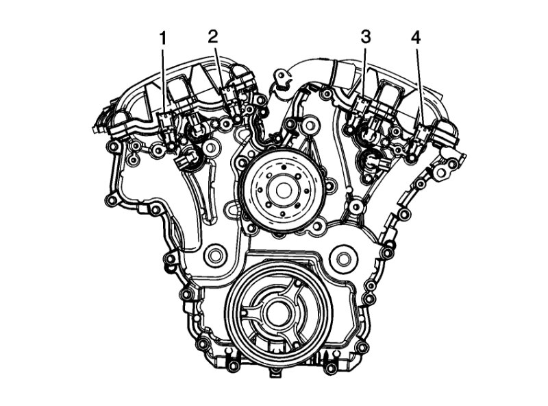

It is also possible you have two separate issues and have a bad cam sensor on the exhaust cam and a failed VVT control solenoid on the other side. I will include images of both parts locations.
Bank 2 exhaust cam sensor circled in gray in picture one. The others are the other cam position sensors one per cam.
Bank 1 Intake VVT solenoid circled. Similar to the sensors there is one for each cam.
To replace any of them you need to support the engine and remove the front mounting strut to gain access to the bolts and have room to remove the parts. Once you have access it is a simple process of removing the bolt and gently pulling the sensor straight out. They are plastic and can break off in the hole. The solenoid is a bit stouter but still pulls out once the bolt is removed. Check the seals prior to replacing either part.
Bolt torque for all of the bolts on the solenoids or sensors is 10Nm.
