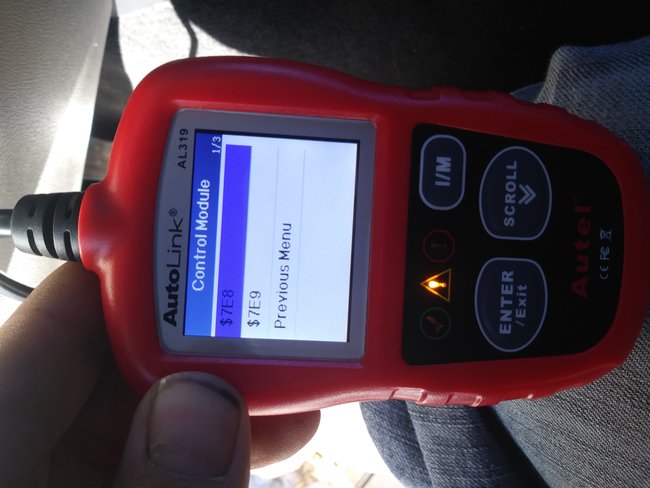

Okay this was the codes.
+36
Tuesday, January 22nd, 2019 AT 8:14 AM
  • 52,797 POSTS
It says 1 of 3. I only see 2.
You need to go to a parts store and have them read it in the correct format.
-1
Tuesday, January 22nd, 2019 AT 8:17 AM
JOHNNY EUDY
  • 6 POSTS
Yea, the third part is the previous menu when you scroll down number 3 is on previous menu only 2 codes.

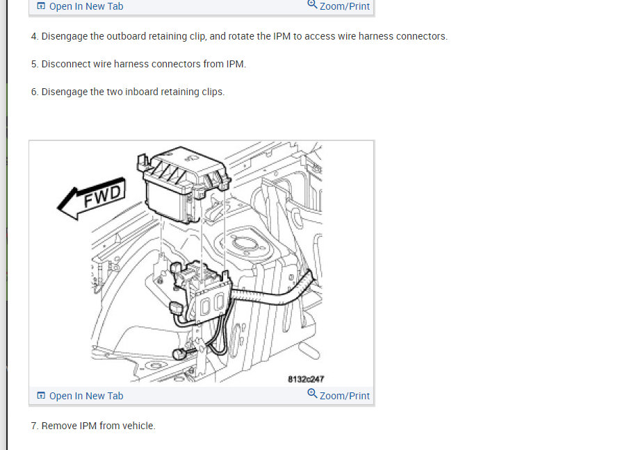

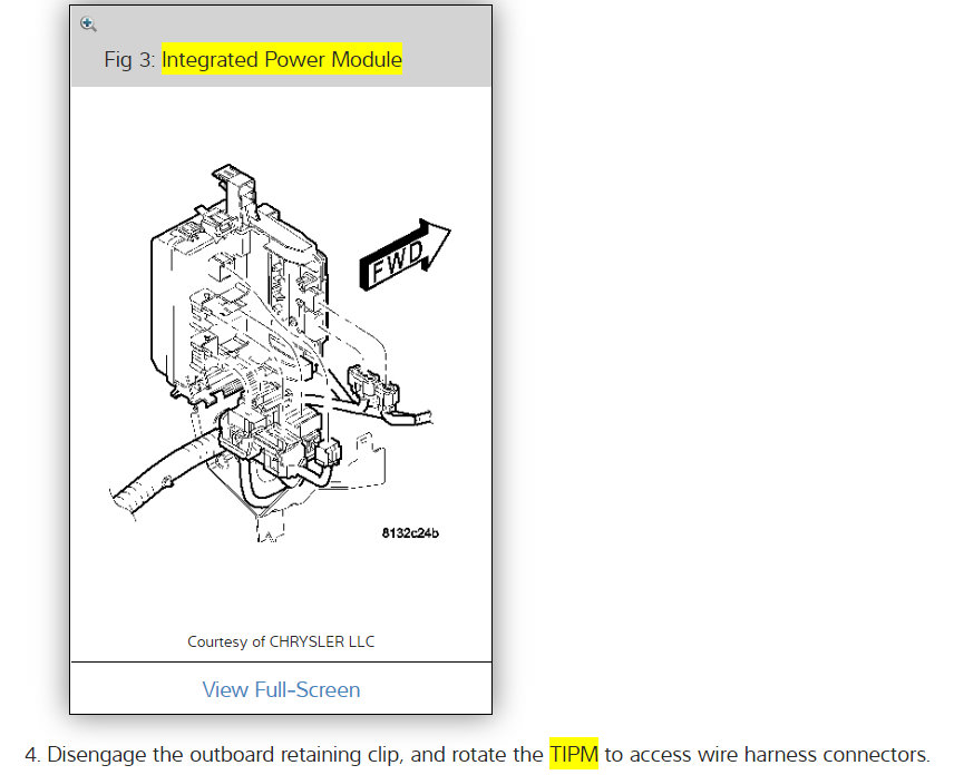

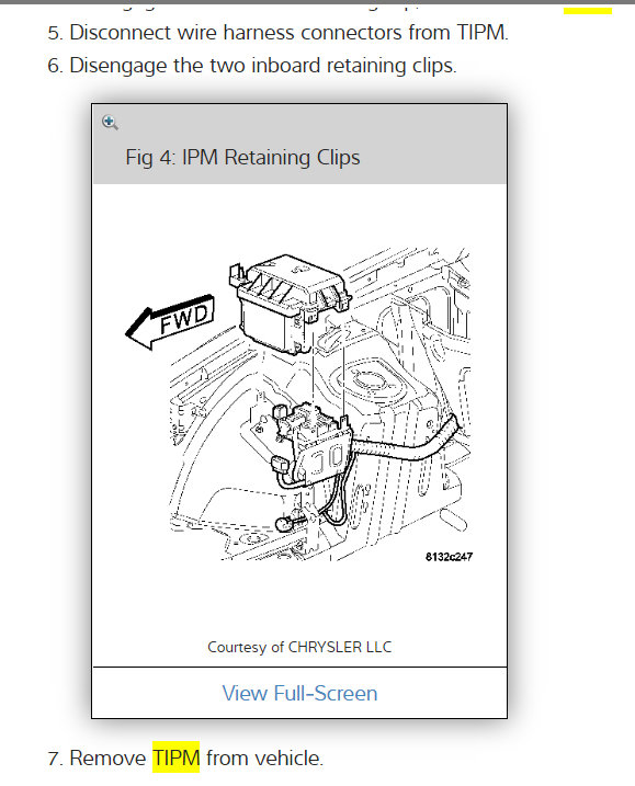

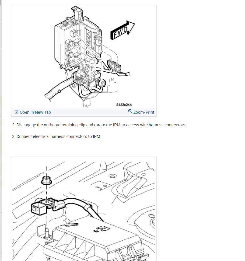

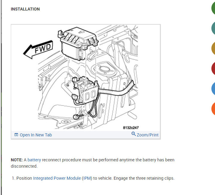

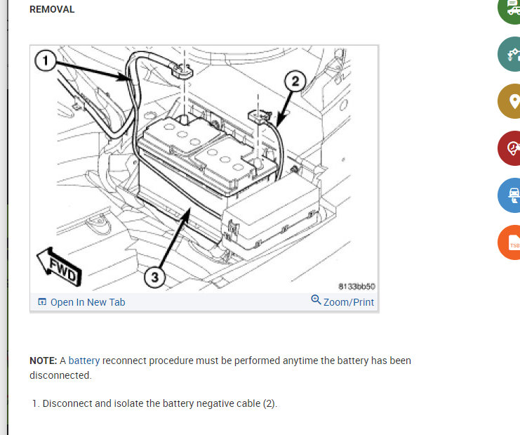

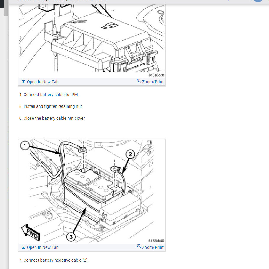

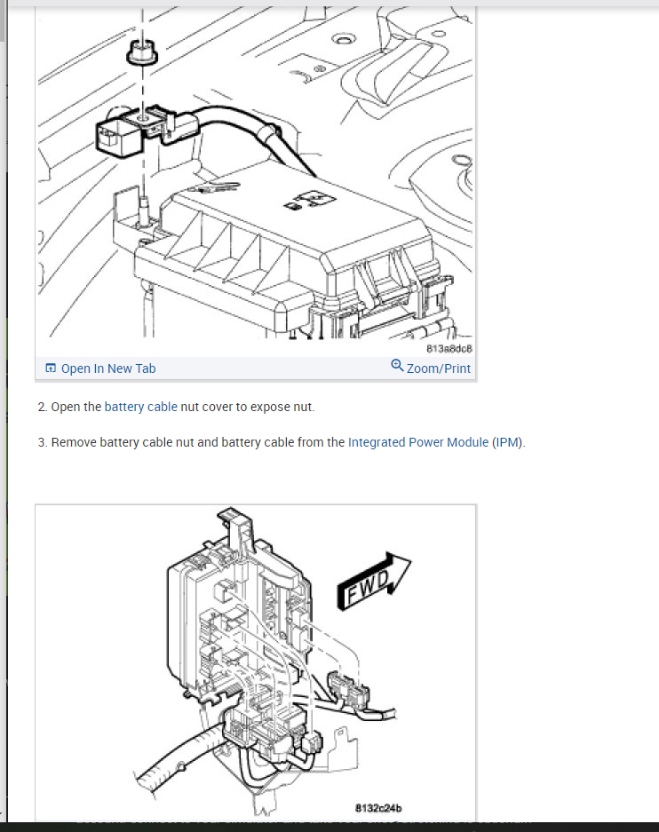

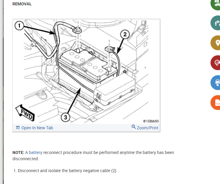

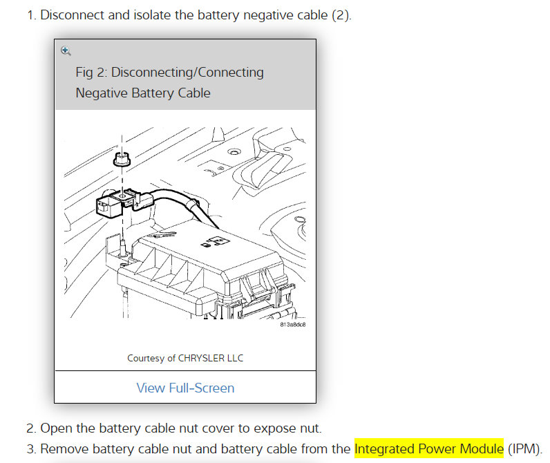

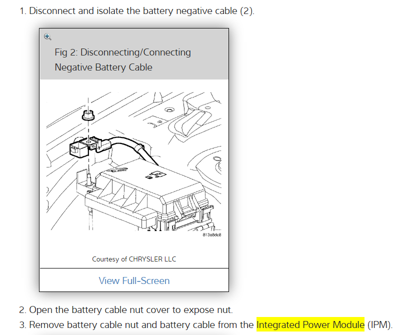

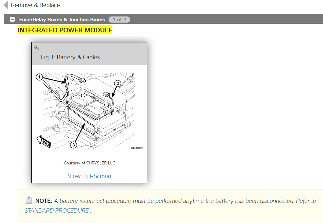

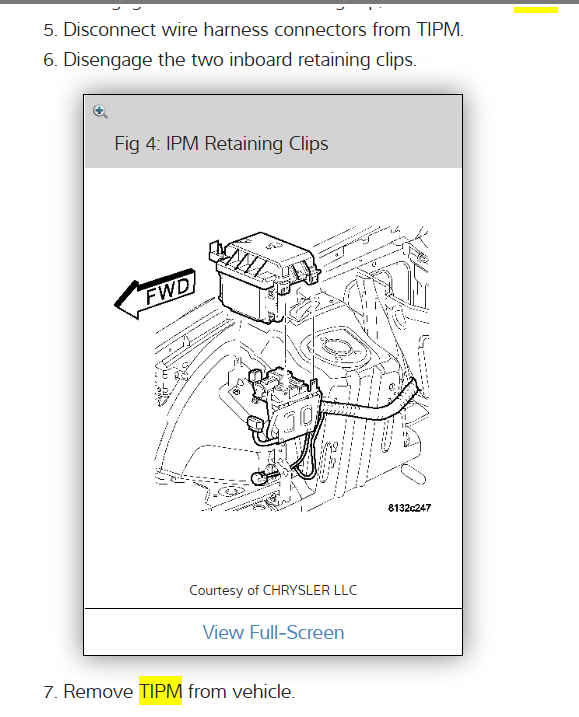

Just in case others have questions on this. This is a pretty common issue on these vehicles. TIPM stands for Totally Integrated Power Module, but this vehicle does not have a TIPM. It has an IPM Integrated Power Module. Slightly different but basically does the same thing.
These codes are very common but they are actually a generic scan tool issue on not being able to read the actual codes that are there.
The most common correction of this is a TIPM or IPM as the circuit boards fail and cause all sorts of different issues. It is very common.
I attached the process below for more info on how to replace it.
+5
