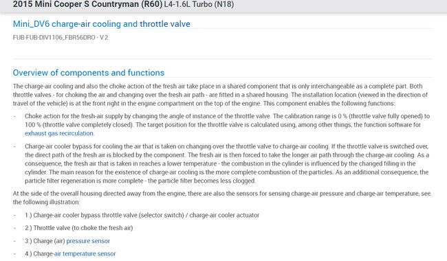

Codes p1588, p1589, p1588, and p1589, what do these codes mean?
2015 MINI COUNTRYMAN
102,474 MILES • 1.6L • 4 CYL • 2WD • AUTOMATIC
TIMATREE
I have some codes and I don’t know what they mean. p1588 p1589 p1588 p1589.
Jun 18, 2023 at 5:01 AM
  • 55,412 POSTS

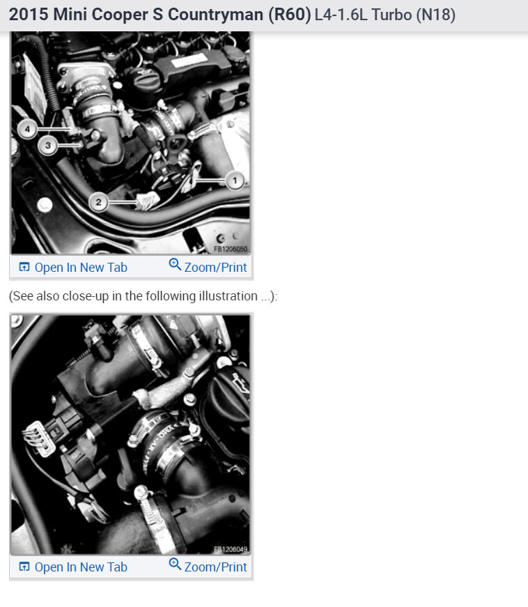

This is common when the throttle body need to be serviced. here is a guide that can help and instructions in the images below to show you how on your car:
P1588 - Throttle Control Malfunction:
P1589 - Throttle Control Adaptation Not Started:
Check out the images (below). Please let us know how it goes
