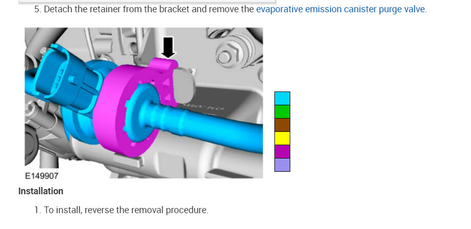

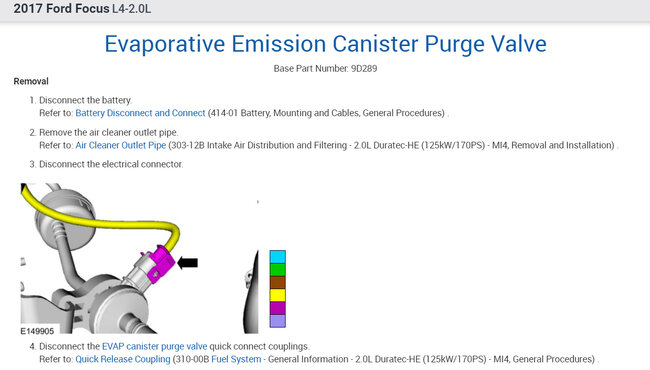

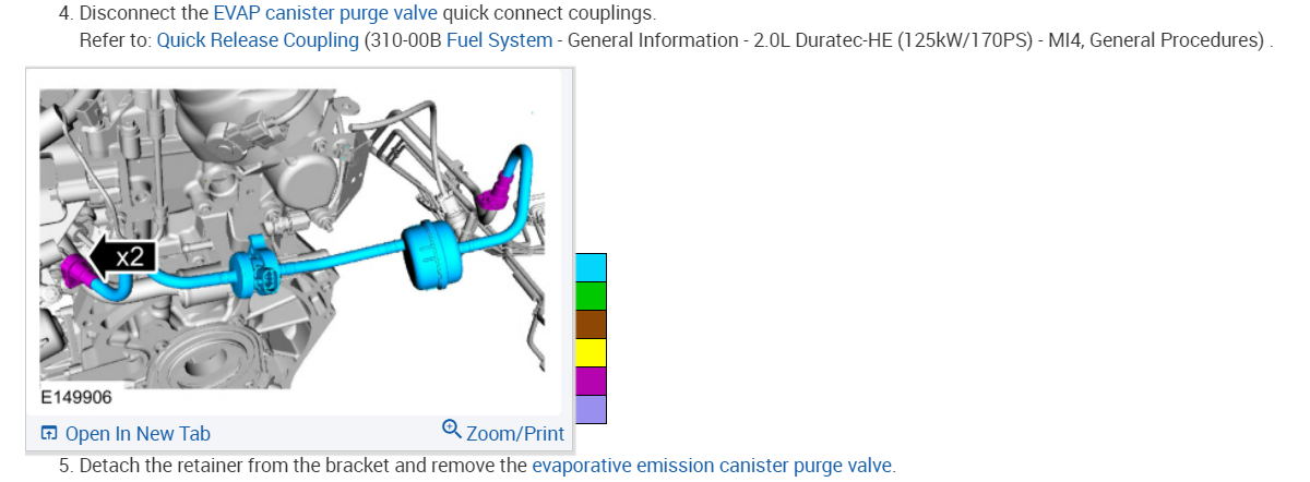

Codes P144A and P1450, what do they mean and how do I fix it?
Apr 29, 2023 at 6:43 AM
  • 55,399 POSTS
Here are the code meanings:
P144A indicates that the evaporative emission system has detected a restriction in the purge vapor line.
P1450 indicates that the evaporative emission control system is unable to bleed up the fuel tank vacuum.
So, it looks like you have an EVAP purge valve that is not working. Here is the location so you can check it out. Check out the images (below). Please let us know what happens.
