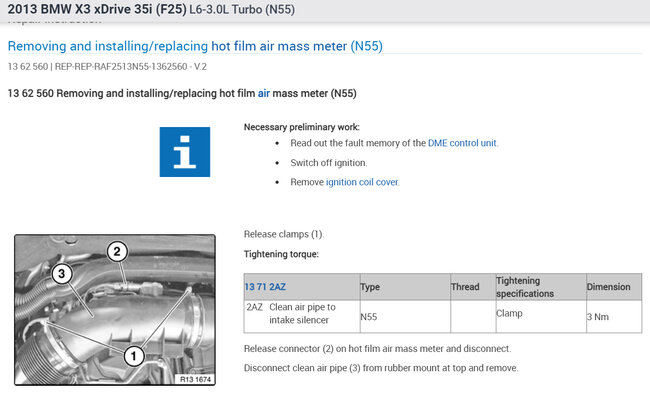

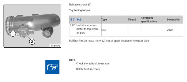

The error codes you provided are associated with BMW vehicles. Here's some information about each code:
120308: This code corresponds to the "Valvetronic eccentric shaft sensor guide" on a BMW.
118001: This code is related to the "Mass or Volume Air Flow 'A' Circuit Range/Performance" on a BMW.
So, I would make sure the air intake is in good shape with no cracks, if there were no leaks I would change out the MAF sensor and then clear the codes. Check out the images (below). Please let us know how it goes.
Jul 15, 2023 at 4:32 AM

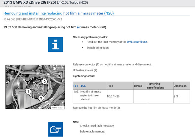

Thanks for getting back to me. My vehicle is BMW X3 2013 2.0 turbo N20 engine but your reference is related to N54.
Jul 16, 2023 at 2:47 AM
  • 55,414 POSTS
My bad, sorry, here is the correct information. Check out the images (below). Please let us know what happens.
