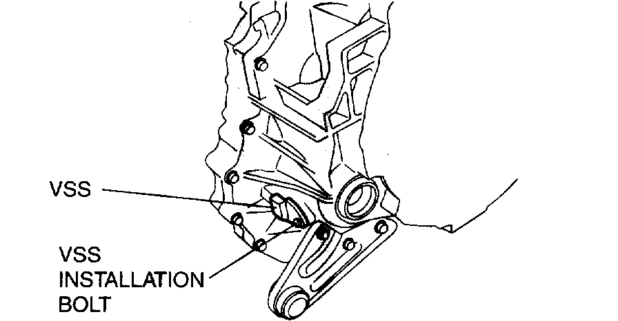

This is my first time owning a Mazda. Got this car, clutch was great, nothing leaking or running weird, next day I go to drive it and the battery is dead. My problem is only beginning, my speedometer and odometer is now not working. my fuse blew in my wipers after I had the battery replaced and then had to figure out the bad connections (low voltage from cables, so they shimmed it). then the blower motor relay blew, froze out December thinking it was the motor (found the relay on my own without the help of the mechanic that said it was the motor). where is the location to speed sensor A? What would the voltage be if the sensor is good? It's now running rich (Code P2188), so MAF sensor or harness? This whole bottom is rusted out the previous owner had it spray foamed and painted the color of the car. already lost a strut mount. yes I got a dud.

It is located on the lower portion of the transmission. You need to remove the battery cover duct to see it. Here are the directions for replacement. The attached pics correlate with the directions.

4. Disconnect the VSS connector.
pic 1

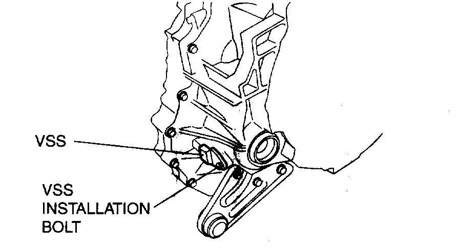

5. Remove the VSS.
6. Apply ATF to a new O-ring and install it on a new VSS.
pic 2
7. Install the VSS.
Tightening torque 8 - 11 Nm (82 - 112 kgf-cm, 71 - 97 inch lbs.)

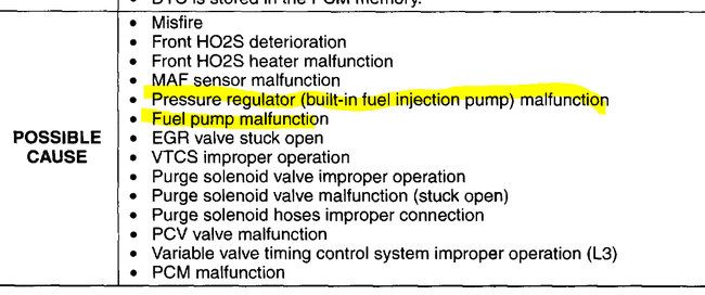

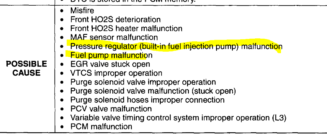

Thanks for the info. I really appreciate all the knowledge! The car frame is solid just the floorboard has a hole then the strut mount. I'm replacing all struts, and the mounts and front ens also just a lot to do. Would the VSS cause the gas to become rich?(P2188)Or should I just check the MAF and harness?
Jan 14, 2020 at 12:33 PM
  • 110,194 POSTS
Most commonly, a rich fuel mixture is due to high fuel pressure. If the regulator isn't working properly, it can allow fuel to get higher in pressure than it should. If you look at pic 1, it shows the possible causes for the code you listed. I would start by testing fuel pressure.

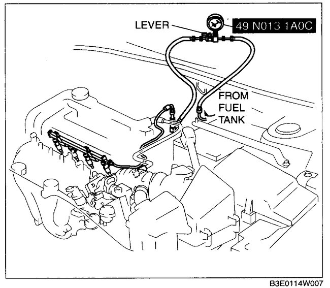

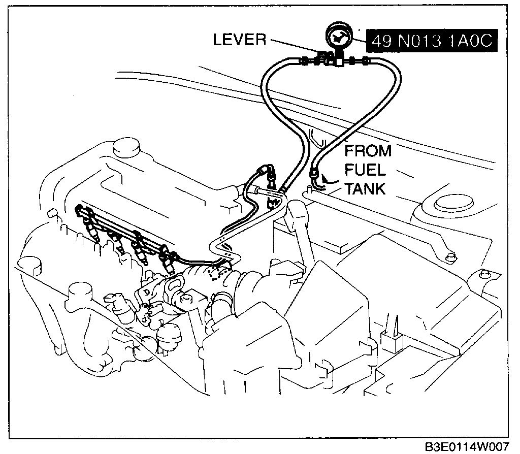

3. Disconnect the quick release connector (in the engine compartment.
pic 2
4. Turn the lever of the SST parallel to the hose as shown in the figure.
5. Insert the SST quick release connector into the fuel pipe until a click is heard.
6. Verify that the quick release connector is firmly connected by pulling it by hand.

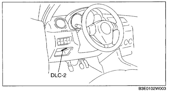

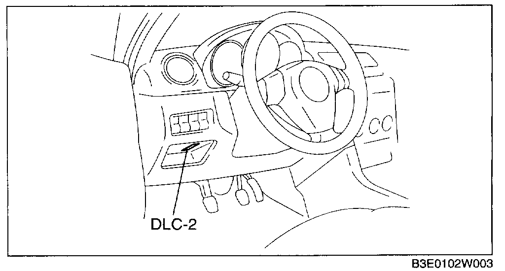

1. Connect the WDS or equivalent to the DLC-2.
2. Start the fuel pump using the "FP" simulation function.

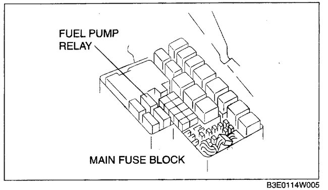

pic 4

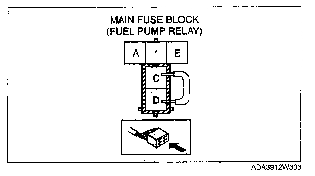

1. Remove the fuel pump relay.
CAUTION: Be careful to short the specified terminal as shorting the wrong terminal of the main fuse block may cause a malfunction.
pic 5
2. Using a jumper wire, short fuel pump relay terminals C and D and connect the negative battery cable to start the fuel pump.
