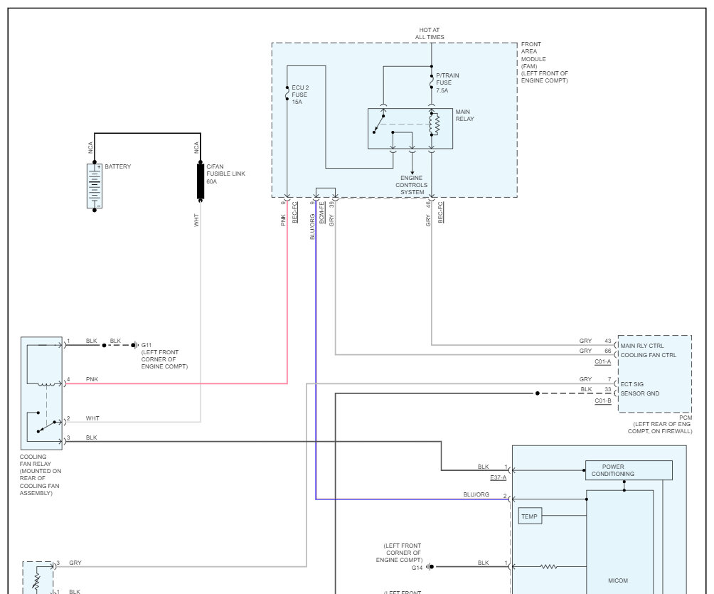

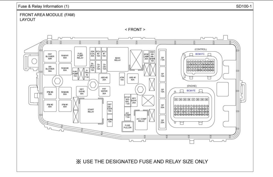

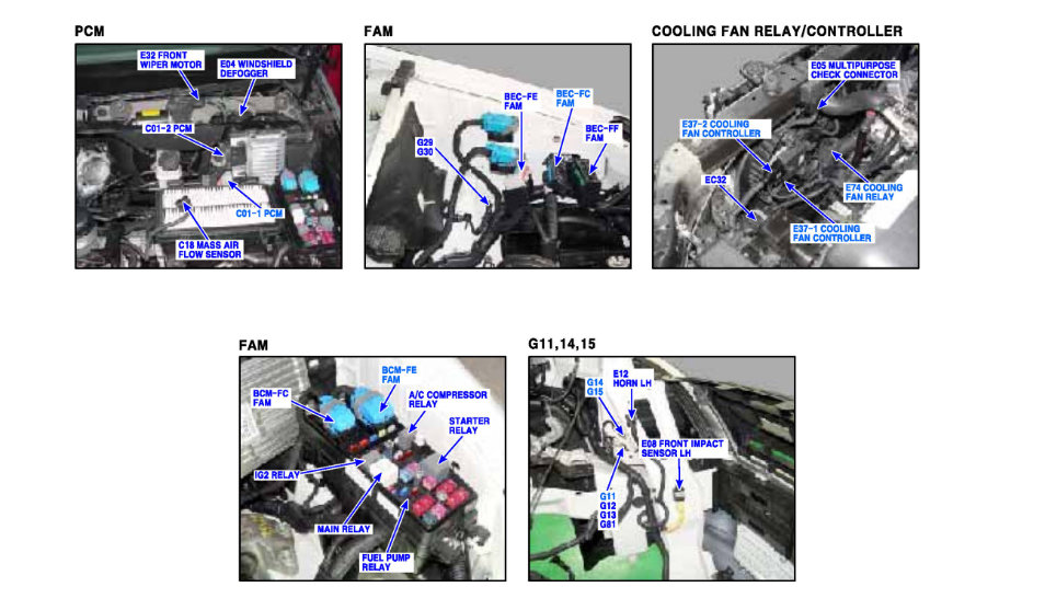

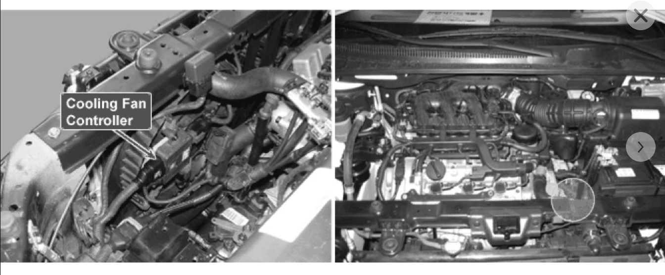

What do I look for to repair and remove the code? Where are the relays and the fan modules? What would be the most likely problem to cause a P0480 code? Are there any illustrations that you could send me?

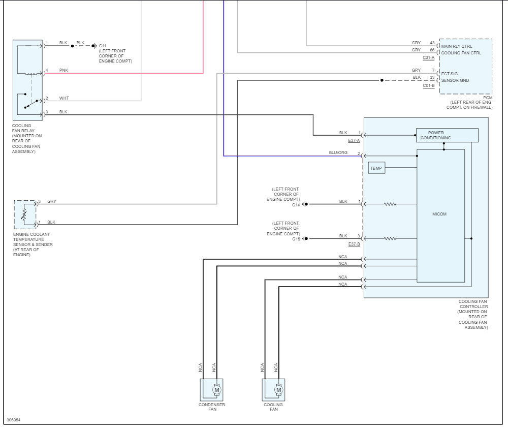

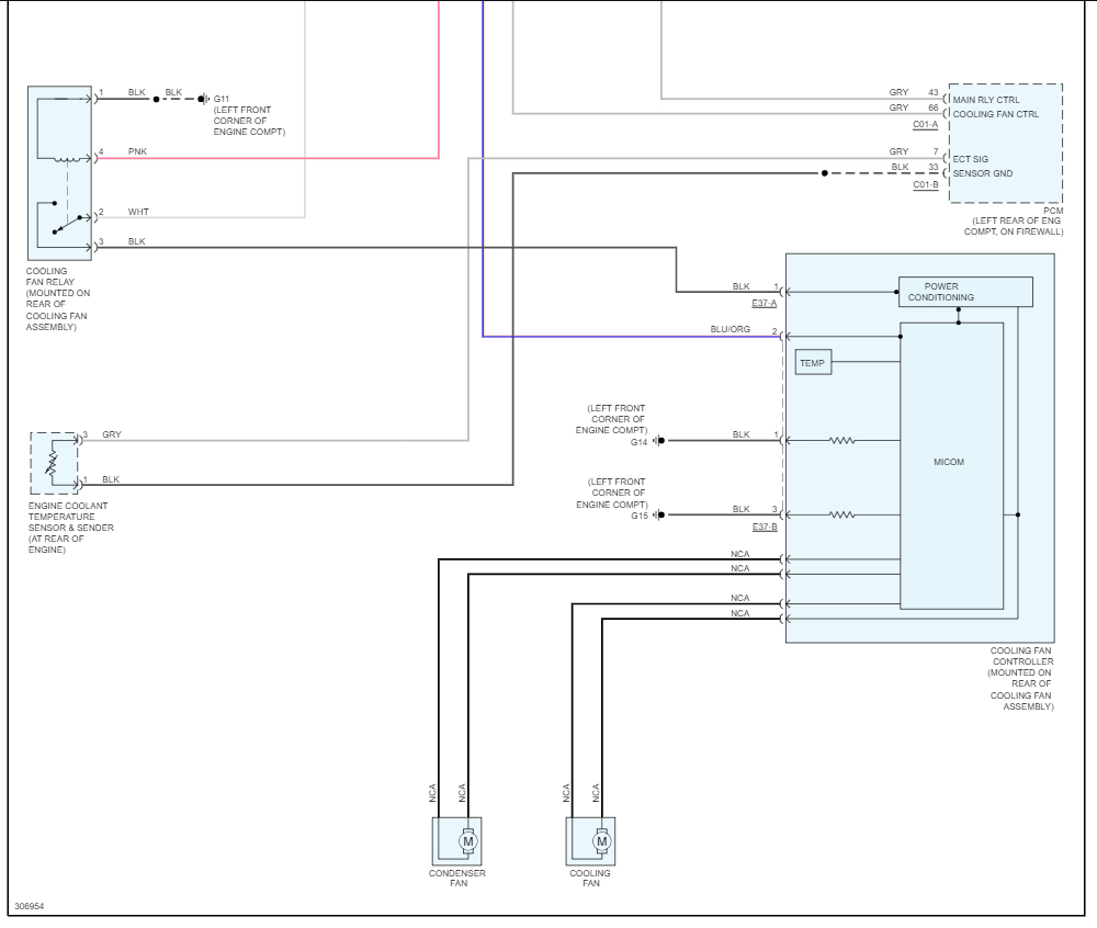

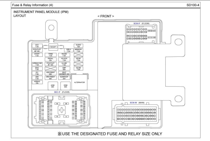

I posted a description on how the system works below with some illustrations for you to view. I also attached a wire diagram for you to view as well. Make sure you check the fuses for power on both sides.

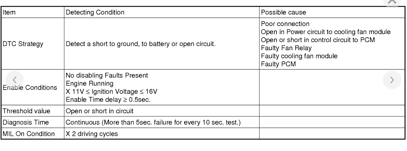

DTC Description

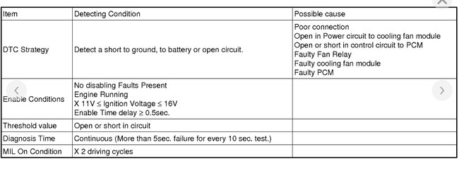

Checking PWM signals to cooling fan under detecting condition, if the PCM detects short to ground, to battery or open circuit, PCM sets P0480. MIL (Malfunction Indication Lamp) turns on when the malfunction lasts until consecutive two driving cycle.
Where is the fan wiring diagrams so you can see the fuses to check and how the system works. Check out the images (Below). Please let us know what happens.

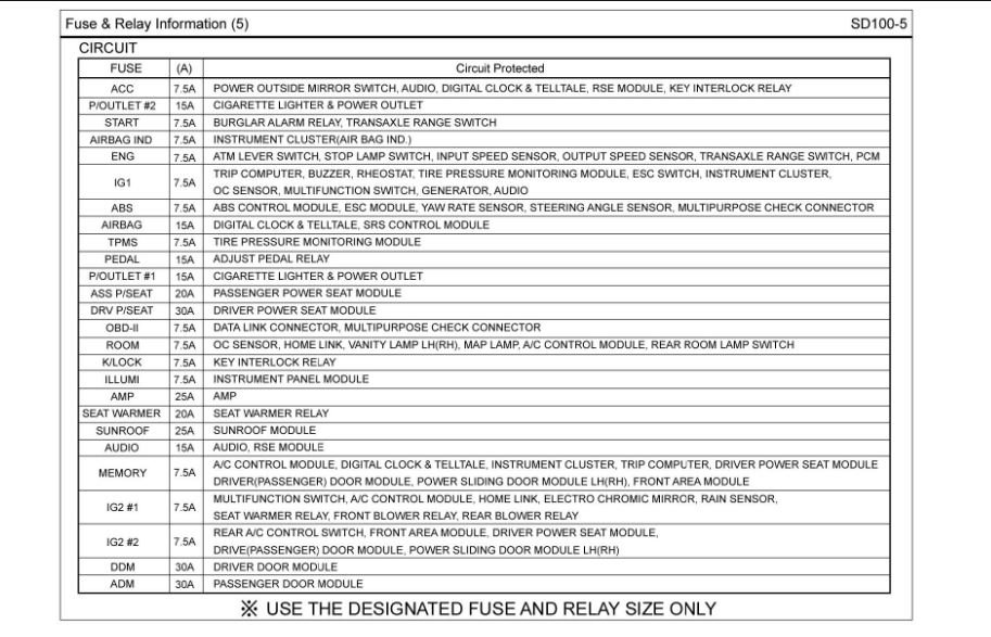

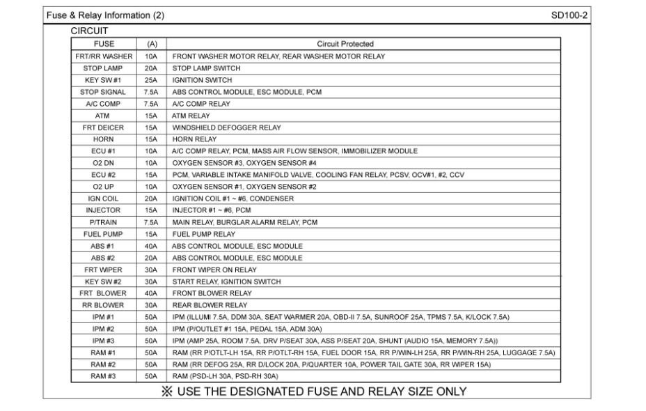

I have a scanning tool and that is what code I get. Would the fan cause the code if it were bad? Are there two fans each with its own codes? The one picture you have sent me is not very clear is that showing me where the fuses are or the relays.

Yes, the fans could be the issue but the flow chart needs to be followed to determine the failure. It could be a relay, fuse, wiring, fans are some of the top possibilities.

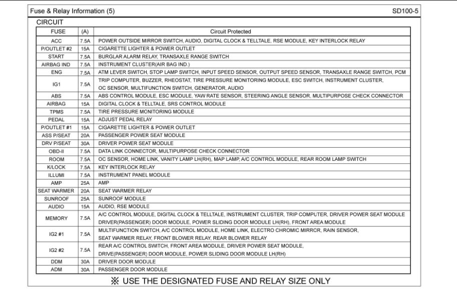

Could I get better picture of the fuses and relays? The previous picture is not very clear.
Dec 6, 2018 at 9:11 AM
Sure, no problem.
