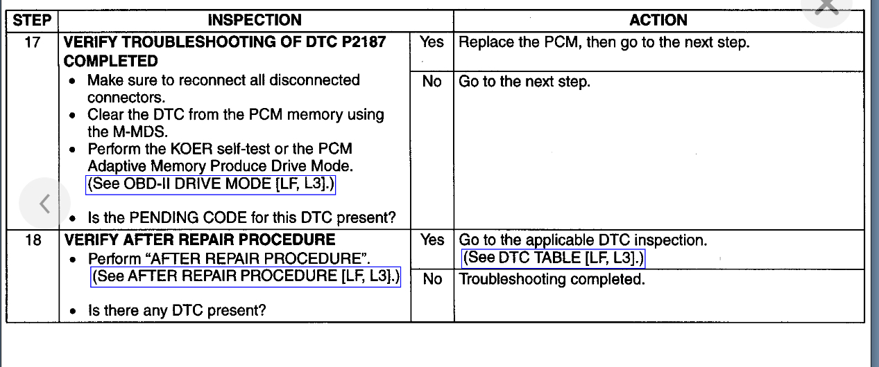

Codes P2187 and P0300
2008 MAZDA 3
135,000 MILES • 2.3L • 4 CYL
KARLAE84

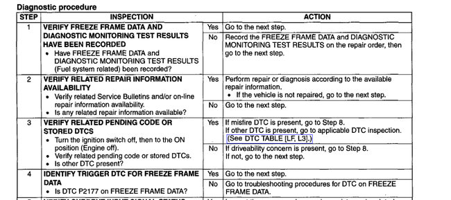

Hi I already replaced spark plugs and cleaned the mass air flow sensor.
The engine starts shaking in the mornings when the engine is cold and the idle RPM moves up less than half way. After 6-7 minutes of driving the car drives fine. There is a noise coming out of the muffler. What could it be ?
Thanks
Nov 18, 2019 at 11:29 PM
SCGRANTURISMO
  • 4,897 POSTS

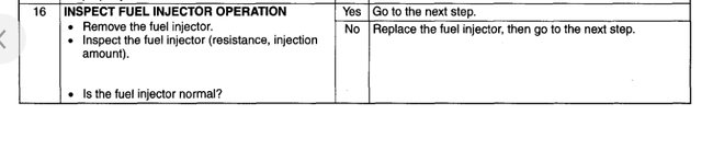

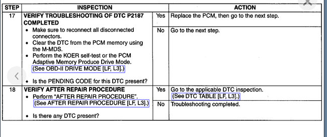

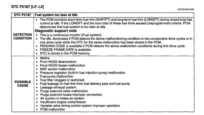

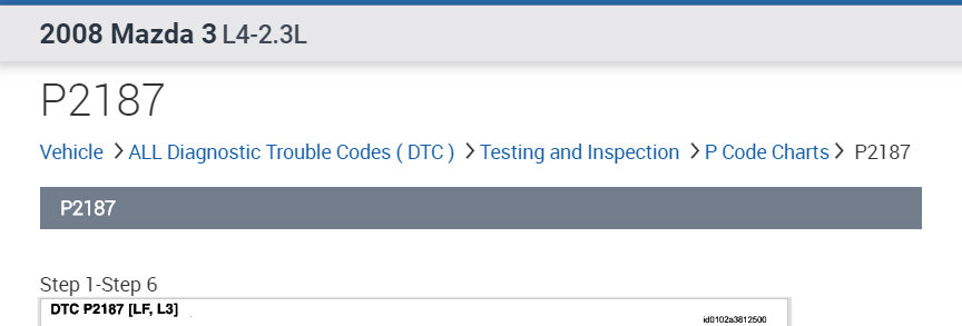

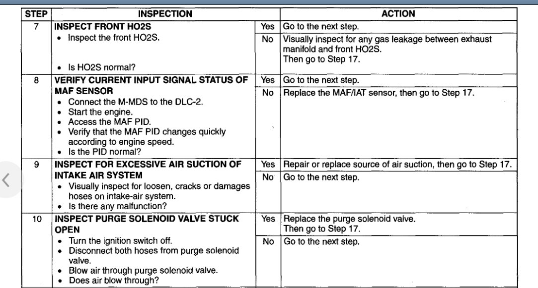

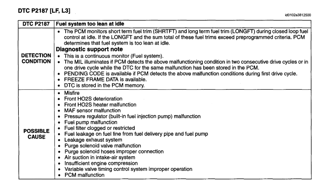

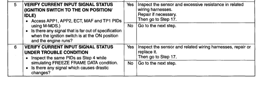

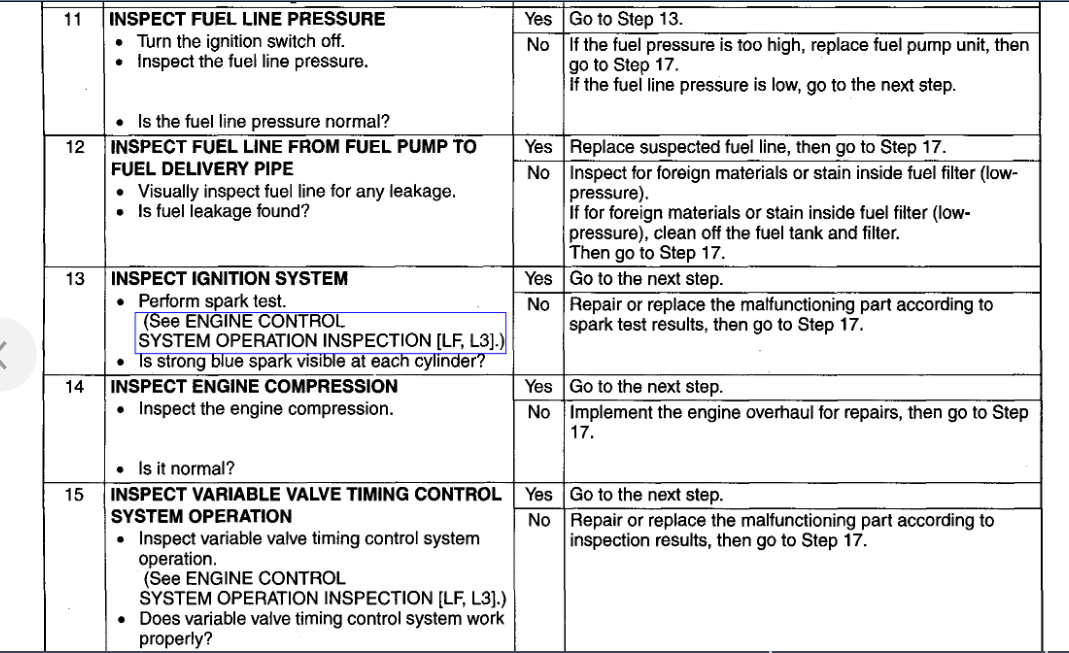

In the diagrams down below I have included the diagnostic troubleshooting guide for your vehicle for Direct Trouble Code[DTC] P2187. It will require the use of a code reader with the ability to read freeze frame data. Please go through this guide and get back to us with how everything turns out.
Thanks,
Alex
