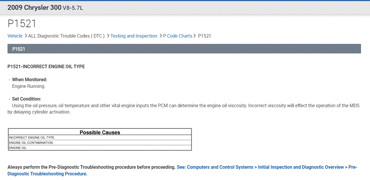

code p1521, oes this code really usually indicate the wrong type of oil or dirty oil?

Hemi engine. Does this code really usually indicate the wrong type of oil or dirty oil?
Nov 7, 2021 at 6:52 AM
  • 110,244 POSTS

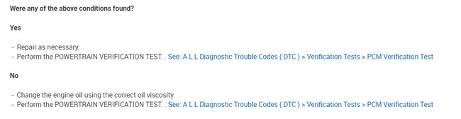

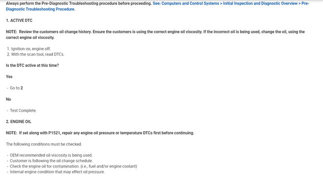

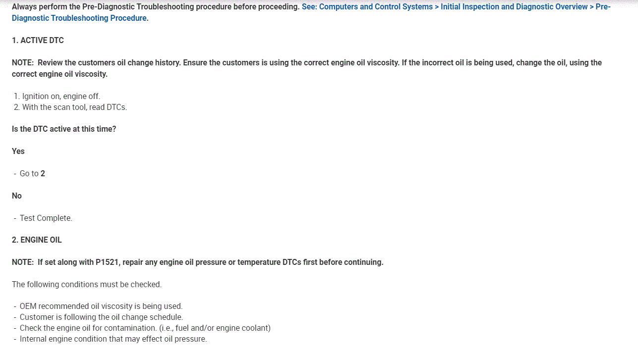

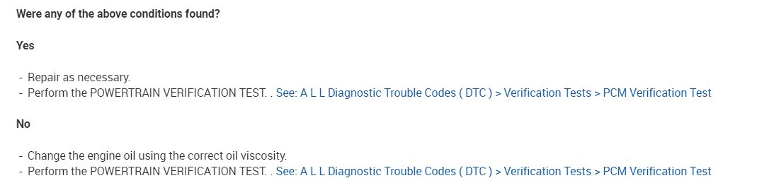

Absolutely, it does. It could be the viscosity is incorrect, the wrong type of oil, or excessive dirt. Any of the aforementioned conditions can create a problem with the multi-displacement system (MDS). The MDS is designed to deactivate certain cylinders when power isn't needed. As a result, it improves efficiency.
Below are the diagnostics and description of the code.
