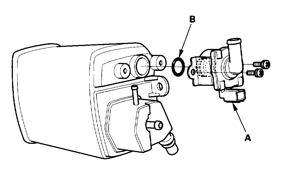

My check engine light went on this morning. I went to Autozone where they gave me this code and the paper says that most likely I need a new purge solenoid. From the list of possible causes that I see online, it's mentioning (among other things) that it's either the canister or the purge solenoid. But yet, when I do a search of that code the videos and sites that come up are mainly about the vent solenoid. My mechanic says that it's most likely the vent solenoid (that's without looking at my car). I don't have the money to have my mechanic fix it and from what I see online it's something that isn't too difficult and my son can do. The problem is guessing what it is. I don't have the money to be doing that either. Any suggestions would be appreciated.

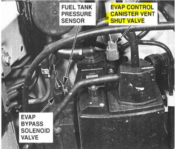

The component is mounted on the EVAP canister and is actually called a canister vent shut off valve. Often times, the valve will corrode and not move causing this code. If you look under the rear of the vehicle near the fuel tank, you will see it. I attached a few pics to help you identify it.

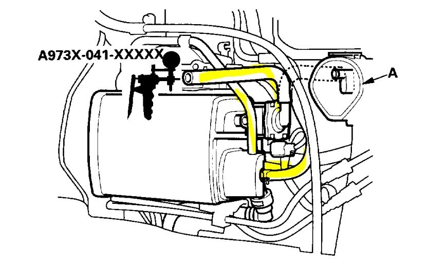

Now, before just replacing it, confirm there are no damaged or disconnected vacuum hoses around the EVAP canister. That can also cause this code. However, chances are the valve in question is stuck in the open position.
To replace it, remove the vacuum hose going to it and the two screws which hold it to the canister. It should pull straight out. If it doesn't, try turning it 1/4 turn counterclockwise to see if it will come out.
Once you get the new one, make sure it also has a new o-ring to prevent leaks. I always clean out where the valve goes and lubricate the new o-ring with Vaseline to prevent damage to the new o-ring. LOL

1) I highlighted some of the vacuum hoses to check.
2) shows the part being removed.
3) it just a better picture of the part and canister.
