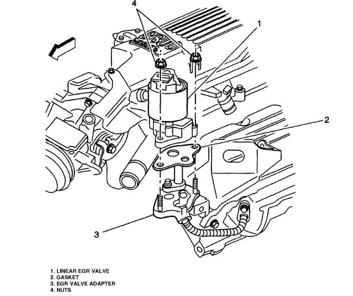

I am in need for help. I hooked my car up to a machine the other day and I got two codes that I am not understanding at all. I went online to view the meanings of the codes and I'm not understanding what they're trying to say. is it a part that I need to replace? is it a part that can be fixed or what? Here is a copy of the link that I want to and I'm asking you could you please help me by telling me what there are meaning please? thank you and God bless

Good afternoon,
The most common issue for this is the EGR valve has carbon on the end of it not allowing to close fully.
Description below.
CIRCUIT DESCRIPTION
The PCM monitors the EGR valve pintle position input to ensure that the valve responds properly to commands from the PCM and to detect a fault if the pintle position sensor and control circuits are open or shorted. If the PCM detects a pintle position signal voltage outside the normal range of the pintle position sensor, or a signal voltage that is not within a tolerance considered acceptable for proper EGR system operation, the PCM will set DTC P1406.

Check for the following conditions:
- Open EGR Valve ignition positive voltage circuit.
An open in the EGR Valve ignition positive voltage circuit will cause EGR Pos. Error to be erratic while the EGR valve is operating. With the ignition ON, a test light should illuminate when connected between ground and the EGR ignition filter circuit at the PCM connection If not, locate and repair the open in the EGR Valve ignition positive voltage circuit.
- Excessive deposits on EGR valve pintle or seat.
Check for deposits that may interfere with the EGR valve pintle extending completely or cause the pintle to stick.
- Poor connection or damaged harness. Inspect the wiring harness for damage. If the harness appears to be OK, observe the EGR actual position display on the scan tool while moving connectors and wiring harnesses related to the EGR valve. A change in the display will indicate the location of the fault.
- EGR valve icing.
An EGR valve that sticks due to icing can cause DTC P1406 to be set. If DTC P1406 sets during extreme cold ambient conditions and the DTC P1406 diagnostic table does not isolate the cause of the malfunction, EGR valve icing is very likely the cause. The EGR valve should start operating normally once the engine has reached operating temperature.

5. If DTC P1406 will only set under certain conditions, the fault may be intermittent; refer to DTC P1406 Diagnostic Aids. If an intermittent wiring problem is not present, check for a faulty connection at the PCM or the EGR valve. If the connections are OK and DTC P14O6 continues to set, replace the EGR valve. Go to EGR Valve.
