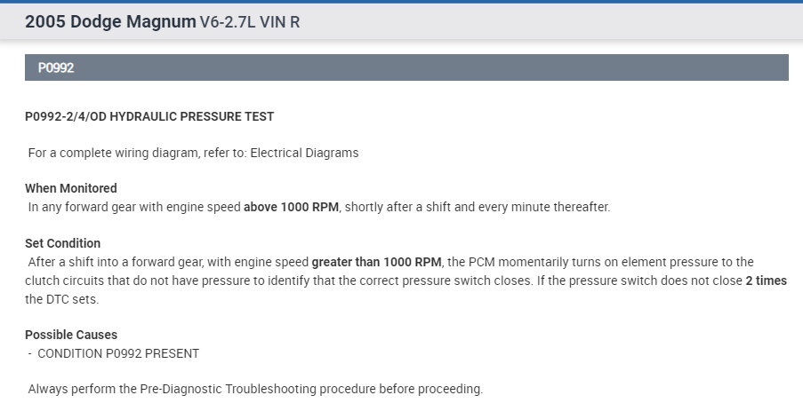

Code p0992?
2005 DODGE MAGNUM
168,120 MILES • 2.7L • 6 CYL • 2WD • MANUAL
SENICAHOLT
Car wouldn't switch gears; it's stay in 1 gear it doesn't change and the RPM doesn't work. It caused the car to run hot.
Jul 13, 2023 at 4:35 PM
  • 110,194 POSTS

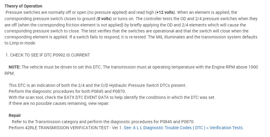

If it is staying in first gear, that will cause the engine RPM's to be extremely high if you are driving it. Also, if the engine is revving that high, you can damage the engine.
As far as the code you have, it is a transmission code indicating a hydraulic pressure issue. This could be a couple of things. For example, the front pump or a pressure switch. I attached a description below for you to review.
So, let's start with the basics. Is the fluid clean and full? Also, does reverse work properly?
