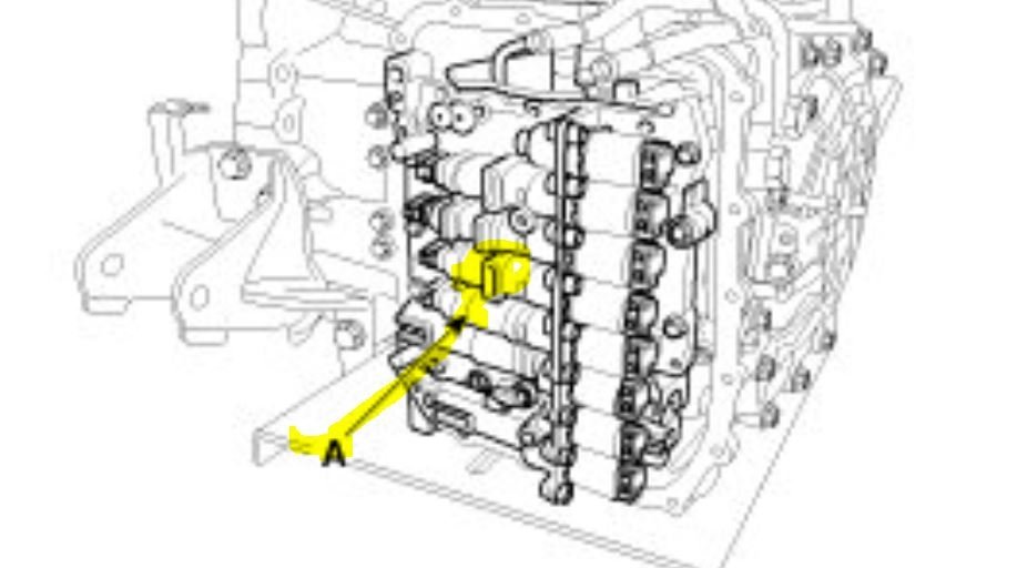

I need to know were the output speed sensor is located on the transmission.
Nov 29, 2019 at 8:13 PM
  • 110,194 POSTS
On many vehicles, it is external. On this vehicle, it's in the transmission and requires removal of the valve body to access.
Here are the directions. The attached pics correlate with the directions. Also, the first pic I enlarged so you can better see its location. Sorry it's somewhat blurry.

Output Speed Sensor
Vehicle Powertrain Management Transmission Control Systems Sensors and Switches - Transmission and Drivetrain Sensors and Switches - A/T Transmission Speed Sensor Service and Repair Removal and Replacement Output Speed Sensor

8. Disconnect the input & output speed sensor connector(A).
9. Remove the input & output speed sensor (B) after removing the bolts(2ea).
